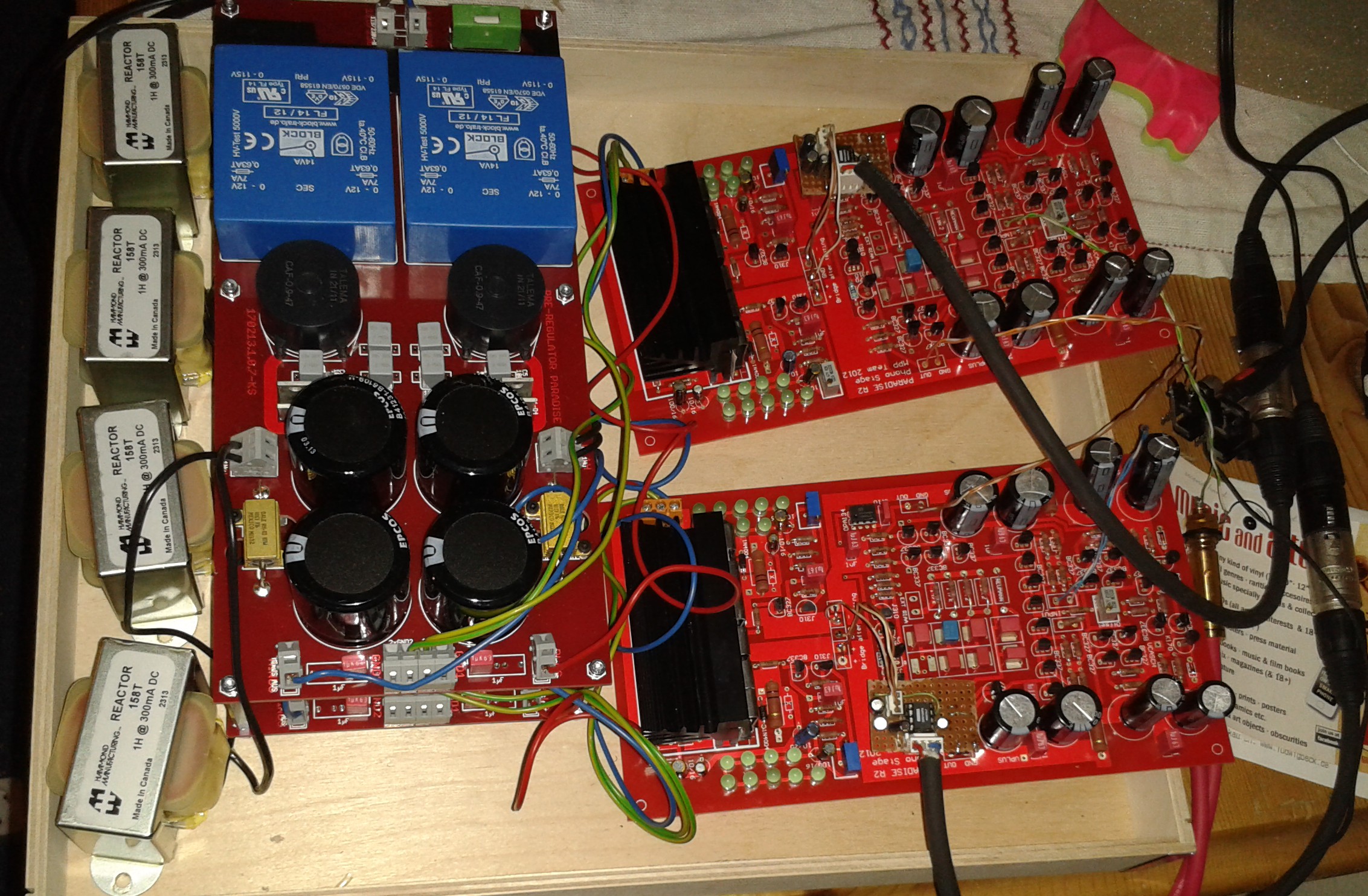

finally my Paradise is also up and running.
I built small sidecars for (additional) balanced output.

I like that, the working PSU, and the 'sidecars' (are you some kind of a computer nerd? ). Have fun listening :szp:

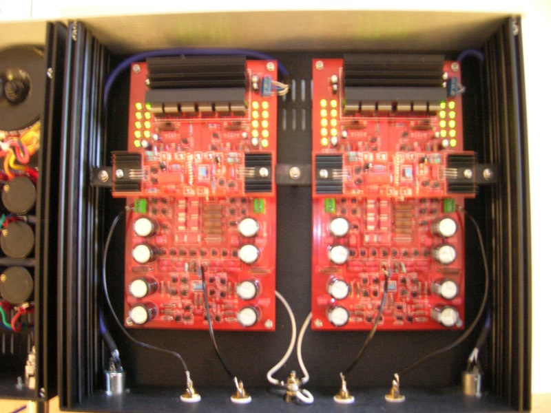

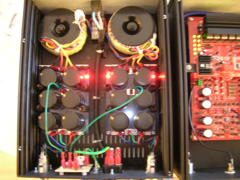

Hi All
A quick build update.
I fired up the Paradise/Calvin boards today and very roughly set the IP offset with a 10K load and well I never. No magic smoke released but a large +/-125MV offset on both boards.
The Calvin adjusts down to 0V between IP and OP so looking good voltage wise.
Ok I remember Paulski’s remarks re boxing and flipped the lid on and let it warm up for 15mins or so.
The OP offset dropped like a stone with the lid on so worth keeping in mind when you first measure.
I now have a more manageable +/- 7mv on both boards OP but I’d like it a little lower.
So I think I’ll be trying to thermocouple the front end transistors to see if that helps.
The 7mv seems to be OK but every little helps.

Looks great, now go and listen to it

I’ve attached some copper sheet to the front end transistors today so over night for the thermal epoxy to set. Then a few days switched on and off just to make sure that all is well.
Just to say that this has been a pretty challenging build for me and one that I would not have started if not for all of the fantastic contributions on this thread.
They all helped immensely.
I’ll post tommorow with an offset update with the copper in place.
Next testing and then listening can begin if all is well.
