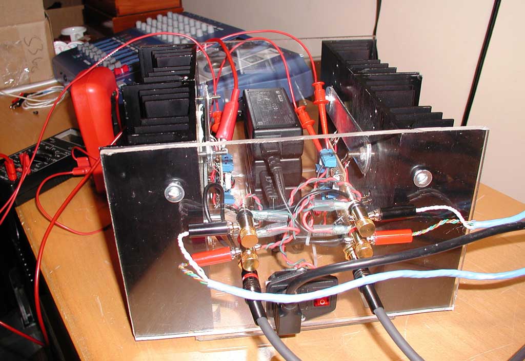

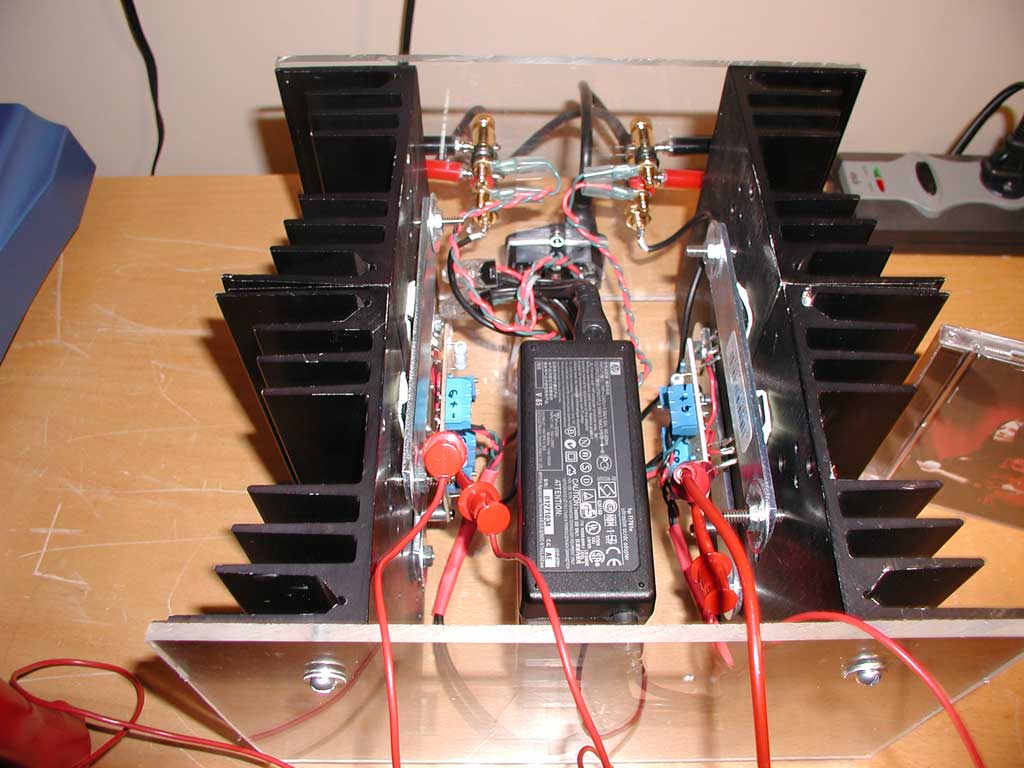

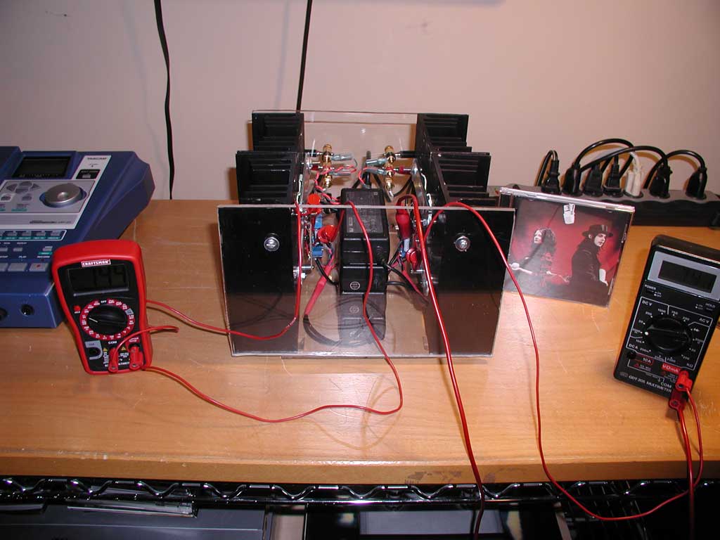

Well, finally got around to finishing the Zen V5 with four 19.5VDC Laptop power supplies. Its been on my bench for over a year. Works great.
Cobbled together a pair of supplies per channel to make a +19VDC 0 -19VDC power supply with no other caps or resistors. Each 19V power supply offers up 3.2A...
There is no hum or noise at all. The ZV5 amp is biased out to 1.5A per device (750ma on R47 emitter resistors), with around 10mv offset. Around 30 watts per MOSFET device. Looks to be around 30 wpc @4ohms.
I like this amp just like it is. 120 watts to dissipate to the sinks, and they are aound 135F.
I cut some plexiglass to finish out the rest of the chassis...about as simple as a gainclone, but quite a bit sweeter sound...
