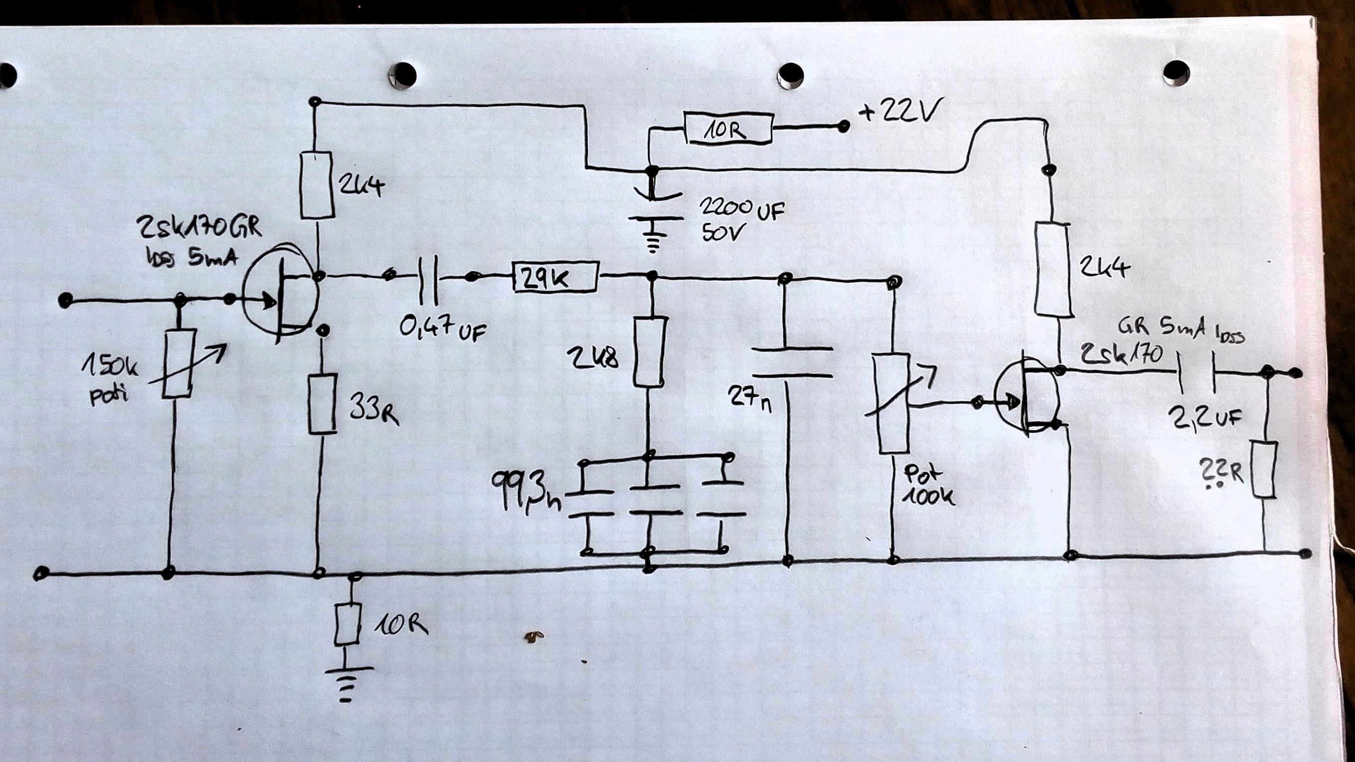

Hey Guys,
since three years i am reading across all threats about phono preamps based on 2sk170 jfet. I have build several experimental versions of this preamp, got me a frequency generator and an oscilloscope and learned a lot of basic stuff about audio electronics. But still i am a noob and i hope you don't throw stones at me for the questions i will ask now.
I am running my pacific style preamp with an Ortofon OM10 cartridge, which is said to have 3,5 mV output at 5cm/s / 1kHz. So with most versions of the pacific that i build i run into trouble with way too much gain causing distortions on the second amplifier stage. After i run some tests to confirm where the distortion come from i decided to build another experimental version using a 50k/50k voltage divider after the riaa filter, instead of the 100k resistor, with the gate of Q2 beeing connected to the middle of the voltage divider.
I experienced a somewhat "better" sound and measurable lower distortions. Before this mod i had big amounts of THD in all orders. Now its almost only 2nd Harmonics distortion on much lower levels (like i want it to be).
But somehow i feel bad about my "solution". Can you guys explain me what happens when i run my setup with this voltage divider? What would happen if i used a 100k poti instead of the voltage divider? Whats wrong with this idea?
My circuit is very near to the "original" LePacific designs, with 5.5mA ID Jfets, but with 33R resistors to ground. My aim is to keep learning about analog circuits, thats why i try stuff that may seem wrong to experts. thanks for your answers.

circuit drawing of my pacific version
here is the circuit drawing, sorry that i did not come with it in the first place.
Its an experimental circuit, thats why Q2 does not have a source resistor but Q1 does have one of 33ohms.
So on Q1 i got around 5.5 Volts while on Q2 i have 9 Volts Vds.
I found another thread about Jfet basic questions and i guess now i could work it out to lower the gain of the jfets on both stages correctly without using the 100k poti to feed the second tranistor stage.
I am aiming for max. 28-32 dB gain on each amplifier stage.
I changed the values in the riaa after reading some dubios calculation, but i still have to measure the frequency graphs of this riaa.

You should normally have more VDS across Q1 than across Q2 because its degenerated with 33R and pulls less current through its 2k4 drain load than Q2 which has no source resistor but same load and IDSS. Maybe you meant the voltage drops across their loads? Unless their IDSS is other than stated and differs between them too.
There's a response problem beyond no good gain allocation in that schematic. The extra high resistance you added in series to the second JFET's gate for the divider forms an RC filter with that stage's Miller capacitance and kills the last octave by 6dB more than the RIAA should. Makes a better curve with those filter parts values up to 10kHz though. Without the divider you had too much gain for MM indeed. And in the wrong place.
Put 12R to first JFET's source pin, put 56R to Q2's source pin, change Q2's drain load to 3k3. Regarding the RIAA elements add 430R to the 2k8 in series, add 5.6n to the 27n in parallel, delete the divider and use 220k in place of the original 100k from Q2's gate to ground. No extra series resistance after the 29k until the gate pin at all.
Those changes should give you prudently balanced stages for gain, 39dB total output gain considering the 20dB passive RIAA loss, a good response curve, and acceptable distortion. Lastly find experimentally a +V PSU voltage rail level that will center Q2's drain to ground voltage at half of rail. For max headroom and symmetrical clipping.

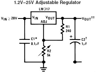

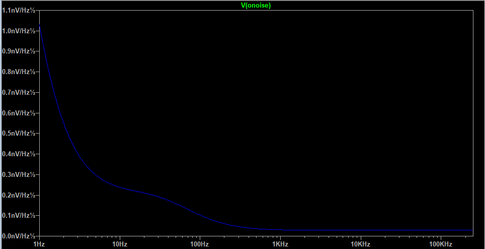

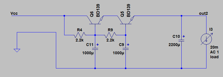

The LM317 is adjustable at least. Its should not oscillate, make sure that the chip has 100nF close and across its input. You could add a clean up capacitance multiplier right after it that in practice does as good or better job for noise than highly esteemed super low noise linear reg chips. Which are surface mount most usually meant for powering digital and very few offer high enough rail range for your purposes. Here's a two stage multiplier I devised for you. It will also put your 2200uF rail capacitor to better use than the simple RC you now got. Delete your 10R to the 2200u cap and use it as output cap to the multiplier. There will be some insertion voltage loss across the multiplier but nothing too serious with a few mA load like yours. 1.35V loss for 20mA pull.

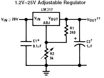

I checked the voltage regulator module again and found a very stupid wiring fail.. I had two different ground points that were not connected, like in the picture on the left (vjum2-false) i uploaded as attachment. After fixing it to a proper grounding my voltage regulator combined with the simple RC-Filter is dead quiet now.

But at the end of the day i tend to build a capacitance multiplier like you proposed. Thanks for the circuit :)

Not its gate to ground voltage, its drain to ground voltage to set at 1/2 rail's value is the goal. Nice about debugging the wiring error around your LM317. Add a 10uF electrolytic across the R2 trimmer to enhance that chip's ripple rejection 7dB further. The capacitance multiplier I proposed to you filters incoming noise very well and has extremely low self noise. Valuable, such phono circuits don't reject any noise coming from the rail, but even more valuable in MC versions where the gain is much higher.

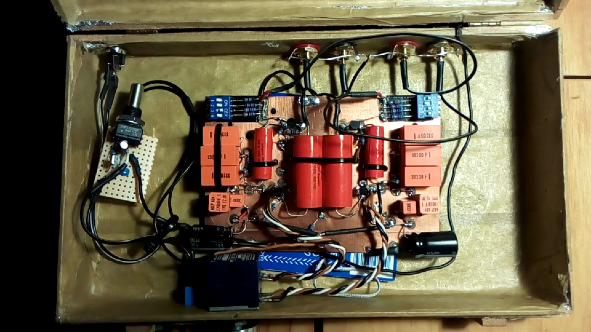

Hi Salas and guys, yew I am back, yes I have a problem. Is DIYAudio based in Houston ?!
So I've messed up my linear supply, shorted 10.000uF when all circuits on...
For ref.:
Shorted smoothing caps. Need confirmation guys!
That was a recycled gyrator but seems current/voltage drop for following LM317 was all but ideal.
So I have questions for people good in phono and supply. Sorry my greek friend ;)
How much current needed for the Pacific we've made?
How about a LM317@22V in the remote supply case and then a LM317@18V in the phono box? I have these parts and more left, many caps and resistors, any simple supply you can recommend Salas?

Your build should be pulling about 12mA per channel. I would recommend you put an LM317 in the remote supply and the post's #71 cascade capacitor multiplier in the phono box. Just using a second LM317 isn't going to improve the chip's intrinsic random noise level, its iterated, just the ripple rejection. The Cmult is going to drop some little voltage in accordance to current drawn so you trim the remote 317 until you will see 18V at the output of the Cmult when loaded.
