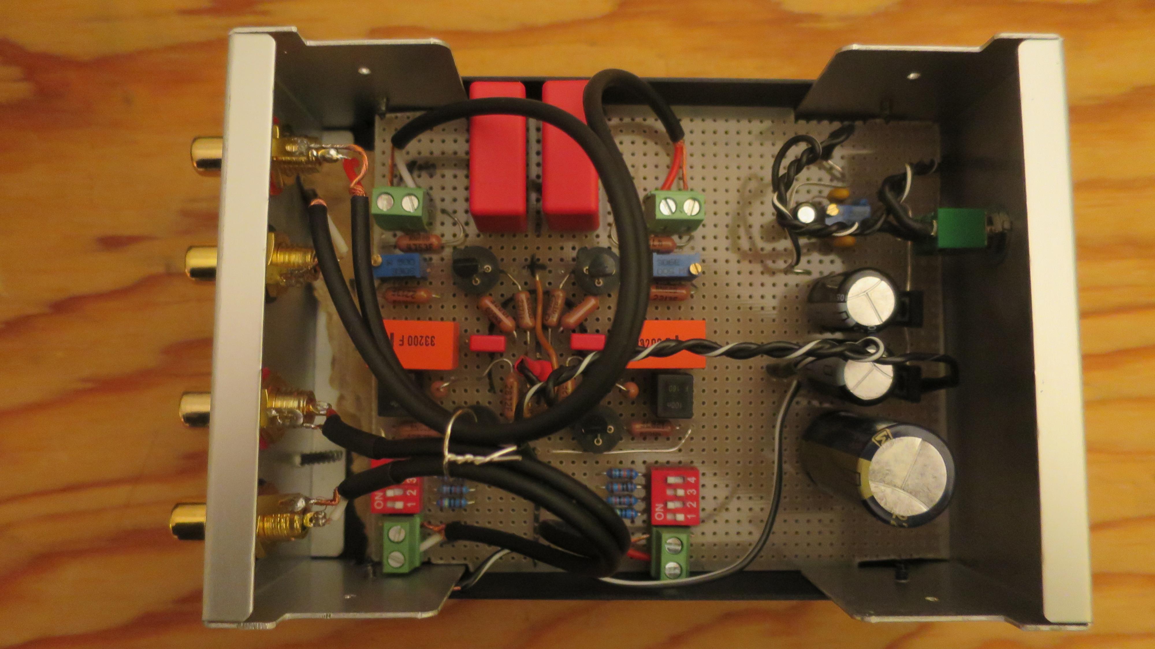

Thanks @all for your kind comments. Good that you only see the top of my perfboard ;-)

" Good that you only see the top of my perfboard "
Hi AddiDub :D
I SEE ! :blackcat:
Or rather I DON'T !! ;)
So this is where all the solid-unobtanium wire & the MEGA $$$ BUCKS hi-end parts are huh ? :rolleyes:
No wonder it's sounding so good.
I had thought the 'secret' design feature was your COOL circular-formation of resistors. :confused:
Make sure you check for fake unobtanium ...
... there are a lot of crooks about ! :cool:

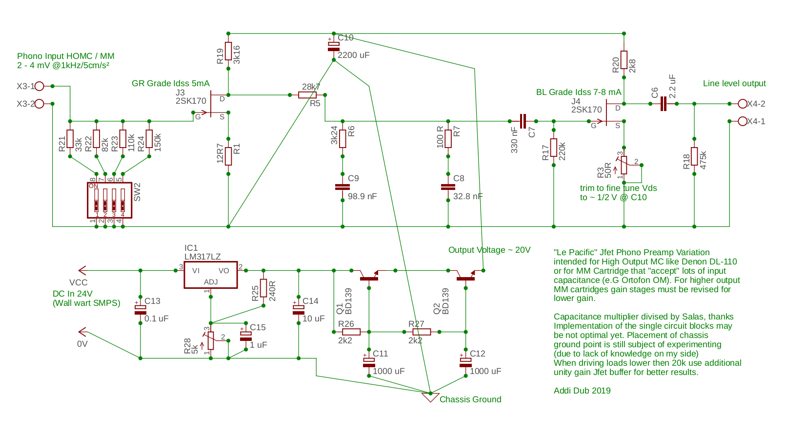

circuit drawing of my phono preamp
Hey guys and grrrls, i finally completed moving :) So after new years eve i found some time to draw one complete channel of my jfet preamp plus the power supply unit.
Remember there is nothing new in this circuit, it is just my most stable and best sounding version of around one dozen circuit variations build since 2016. Its just a try to do a proper documentation - and maybe get last hints for optimizing :D
The power supply unit is also documented in this drawing. Its a simple adjustable LM317 that lets you choose your usable Vcc from 18V to 22V. I found it very useful for fine tuning. After the LM317 circuit comes a capacitance multiplier, that Salas gave me: Pacific RIAA phono pre: failure!. The 2200uF output cap sits in the middle of my preamp board. The negative of the output cap is the central signal ground and is connected to the preamp chassis.
Any suggestions / critics / questions welcome :)
