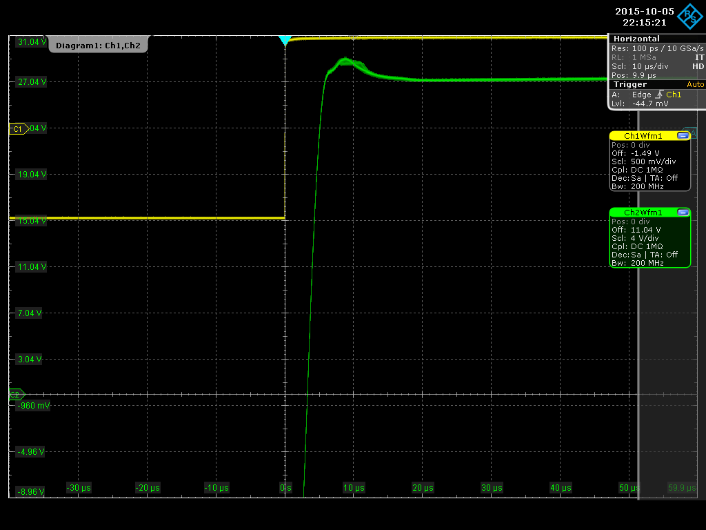

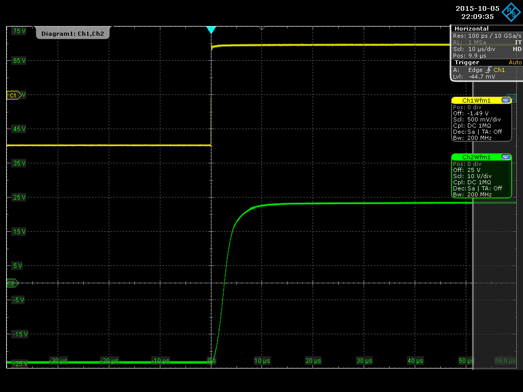

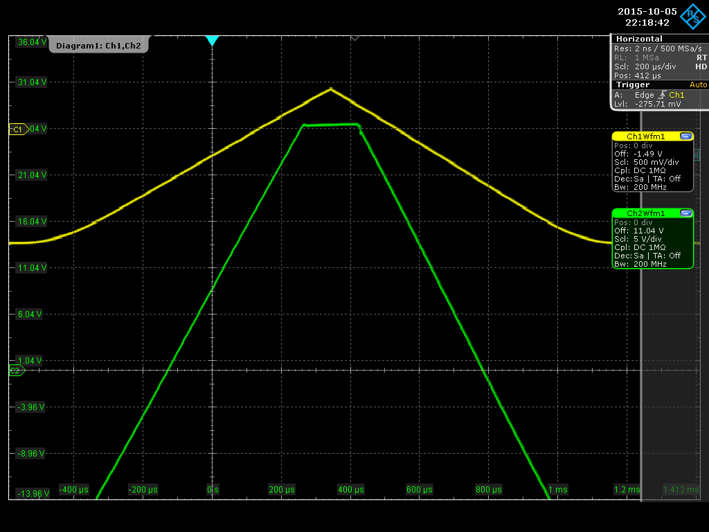

So as we can have a look of the shots below here and in the original thread where it is published since quite a while..
http://www.diyaudio.com/forums/chip-amps/234032-my_ref-fremen-edition-build-thread-tutorial-231.html
In the first the amp is hit with a signal with 5nsec rise time, and is driven 2V below the clipping limit, it is slewing with it's max slew rate 11.6V/usec, gets out of the nonlinear phase without a hitch, totally smooth and settles in ~13usec total. Hell did not break lose. Checkmark OK!
In the second it is driven in deep overload, clipping, hell did not break out, checkmark OK.
In the third it gets out of clipping with real minimum sticking. Checkmark?
Can we call back Mr. Penasa from the drawing board and place him at the right spot, on the kathédra of the teacher?
Can we forget for Ever, about these nonsense accusations?
Sincerely, George

Thanks for posting the slew plots. That relieves that concern.

I have enjoyed the above analysis. Your's logic is crystal clear, but your memory.. hmm.. may I permit a bit of, and almost friendly, irony here..?
your memory is not that strong.. The above 'analyzed' FFT graph was already shown to You, personally adressed to You, with all the necessary annotations about applied power etc..
http://www.diyaudio.com/forums/chip-amps/279458-modulus-86-fremen-edition-8.html#post4451246
:D) :D)
Also myself like to read 'into' displayed graphs..
like, for example, the graph of mine about the slew rate. What else can be understood from that? The yellow trace shows the generator signal, green is the output. The green trace reads +-23V, 46Vpp; the generator trace reads a dot below 1.5V, ~1.45V input level. The amplification factor results to be A=31.72, ~30.03dB.
Now from the BOM of Myref we know that Rf=12kohm; Rg=390ohm.
A=1+Rf/Rg, 1+30.76, 30.037dB...
Ciao, George
