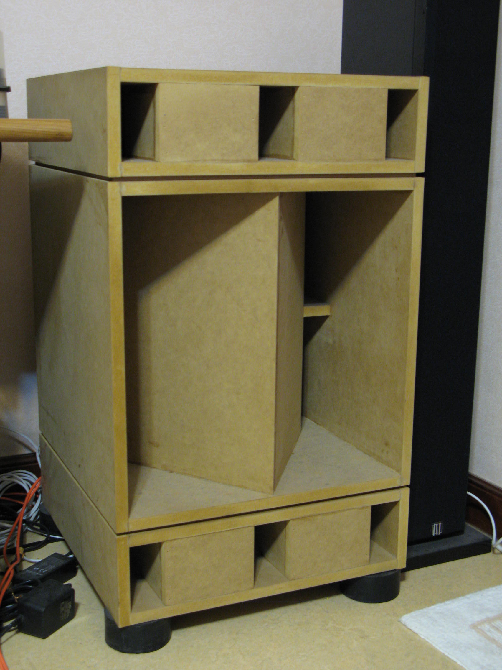

The area between the ramps will connect the back volumes of both drivers.
Wow! That's really innovative, djk! Thanks for sharing your insight!
The inner driver is still firing into the slot, right? So will there be sufficient space between drivers, or does the area with the ramp have to be 'broadened'? (I'm guessing it's gonna mess with the horn dimensions, but...:confused:)
And the wedge for bifurcation? Can it be omitted?
What about the outer driver's front chamber? You said the back volume will be connected by the area between the ramps - the 'V's' - so how much volume should the outer driver have?
I guess I'm still confused how the secondary driver will be mounted. Can you please explain it a little bit more? :D
This is my 12 inch size La Scala with your port mod(only upper 2 ports are in use) and loaded with quad 8 inch PPSL plenum per side. (Thanks for the design!)

"The inner driver is still firing into the slot, right?"
There will be no slot in practice. I recycled pictures of the Belle type product to show the ramps.
"So will there be sufficient space between drivers, or does the area with the ramp have to be 'broadened'?"
The 12PE32 is 120mm deep behind the mounting plane (front mounted). The mounting board is 18mm, so the magnet is 102mm deep. If the inner driver is mounted behind its mounting board that is another 18mm, so we are down to 84mm. I was thinking of making the passage 75.5mm (like the stock LaScala), so the magnet sticks into the cone of the other driver by 8.5mm, plenty of room for cone travel.
"What about the outer driver's front chamber? You said the back volume will be connected by the area between the ramps - the 'V's' - so how much volume should the outer driver have?"
As little as possible. The optimum back volume for both drivers is only 20L, it will be hard to get it down that low.
"And the wedge for bifurcation? Can it be omitted?"
It's not there.
The effective divider is the centerline of the drivers, and the ramps will come right up to this centerline and define where the bifucation starts.
http://www.parts-express.com/pedocs/tech-diagrams/294-660-bc-speakers-12pe32-technical-diagram.pdf
The mounting hole is 281mm, and the width of the passage is about 75.5mm, so the area at the effective throat is about 212cm (the design calls for 231cm, close enough).
Going either direction from the throat about 32cm (the middle of the 90° bend), and then moving forward 55cm to the mouth gives us a total length of about 82cm (the design calls for 84cm).
With the cabinet about H610mm x D610mm x W760mm the mouth is a bit bigger than required (better a bit big than a bit too small).
If you were to use a narrow flat board on the front (like the Belle does) the exact mouth area could be realized, and the exit angles reduced (dispersion narrowed at the upper crossover point). I would probably opt for the larger mouth and wide exit angles, easier build too.
The rear cover over the rear 12 will need only be about 25mm deep or so. I would place some sort of pad on it (foam or pehaps a piece of fiberglass celing tile) to reduce midrange reflections from coming back through the cone. This cover will need to be removeable to load the driver.
There will need to be a loading hatch (removeable cover) similar to the LaScala (or Belle) to load the internal driver. The 'V' shaped volume behind the interior driver will have to be block off and/or stuffed with non-porus material to hit the target of 20L.
While a straight corner reflector is shown, a curved section could be used (1/4 section of a 150mm plastic pipe or paper tube). The 1/4W of 1130hz is 75mm, so a straight corner reflector should be OK here.
