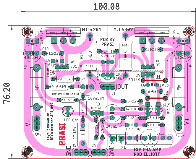

Build this one, it will work properly. its based on Adi_007 layout.
What is input capacitor c12 value.and q9 on which heat sink and how fix(will stuck)
Dear sir
Is it necessary to connect bd139 and bd140 with heat sink.and what the value of c12 and c13 in above circuit /pcb layout.thanks regard.
C1/C12/C13 are one and the same and are options for the input coupling cap.
C1 is an electrolytic
C12 is film cap with 22.5mm pitch
C13 is also a film cap with 15mm pitch.
Use any one only.
Yes all bd139/140 on the same heatsink and also the bc547 (Q9).
see attached image. It can be a 1 to 1.5 mm thick aluminium plate of 63.5 length and 50mm height.
Thanks dear.i want to ask how can bc546 can be mount on heat sink.if you dont mind please send me your whatsapp no.pleaseC1/C12/C13 are one and the same and are options for the input coupling cap.
Sorry, No number , I like to remain anonymous.
flat surface of Q9 should have tiny amount of heatsink paste. press down on heatsink and Wipe the oozing paste and then You can stick the BC546 to the aluminium plate with a drop of feviquik glue/ fevicol/ rubber solution / glue gun at the edges of bc546.

This is sending current pulses on V+ and V- all around the circuit. Not exactly the definition of low inductance.
Good power amp layouts tend to be elongated and carrying V+ and V- next to each other along the heatsink. I would definitely advise routing both rails on one side.

Im not expert pcb maker.. But i m learning quickly..
So give us an example, not a full pcb.
My P3A sounds perfect.... Full bass and detailed...
Also my measurements with load and sine wave and square wave on scope are also very good. I will posting my measurements tomorrow. Thanks again.

Nice build, where is the star ground and chassis connection?
