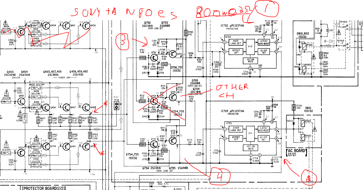

Here is the circuit I was talking about. This amp series have NO VI limiters on it, instead they use the UPC1237 to protect them. This is capable to 1 ohm- WOW- and uses LOW voltage rail at that setting...
This pushes 800W at 2 Ohm, so its not far off of my amplifier....
I labeled some things on it.
1= Main protection. Handles Spk relay DC offset, Overload, AC detect, Delay.
2= Voltage relay switch. IE, when too much current is driven to it it will switch the voltage to a lower rail via relay.
3= Overload circuit for the spk protection
4= Overload circuit for High/Low Voltage switching...
*Notice they used both sides to check it- however they still add the resistor and diode to ground as did you add to my circuit in post 41.
But what is the function of the diode and resistor to ground? to protect the transistor?
Yes, in this scheme, there is no limitation current.
The remaining parts are elements of standards of protection.
There's also a load sensor 4 or 8 Ohm.
Why do I need a diode and resistor.
This dynamic divider sensor base voltage of the transistor. If output short circuit, then a diode is locked, and the divisor is not working. This leads to the threshold of 0.7V operation of the sensor. This tripping current minimum.
If hard is no short, then the threshold of the sensor response becomes greater as the voltage output growth - is unlocked and running diode divider of two resistors.
This scheme is a good description of the output transistor in SOA

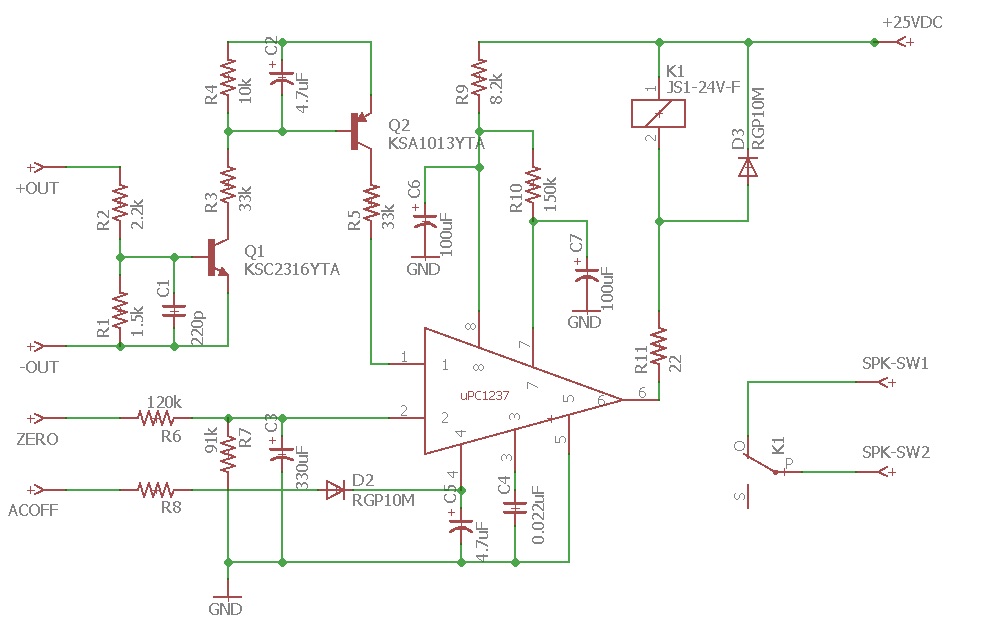

Here is what I have got so far, collecting pieces bit by bit. Some notes:
  • +OUT and -OUT go to the output stage transistors emitters
  • ZERO goes to audio zero
  • the schematic is for one channel
There are some open questions though...
  • Does protection need to have its own transformer for +25VDC power or can it run from the main amp transformer? (my transformer has an unused extra secondary that I could use for the protection board)
  • How good does the +25VDC need to be? May I use a rectifier bridge with a small cap, say 1000uF? Do I even need a cap?
  • My understanding is that the relay is normally closed. Correct? If this is the case, how does this protection manage to achieve "power-on mute" (pin 7)? The relay will be closed and speaker connected at power-on. Does the relay open quicker than the audio shock propagates through the amp? I guess this could be the case due to the fact that PSU caps are much larger than the cap used in the protection board PSU and so charge longer. Right?
  • ACOFF is a separate input to detect power off event and mute speaker. It should go to the main transformer secondary. My understanding is that you should not connect ACOFF to +25VDC for the reason that +25VDC will have a capacitor that holds charge and doesn't allow the IC to detect the event in a timely manner. Correct?
