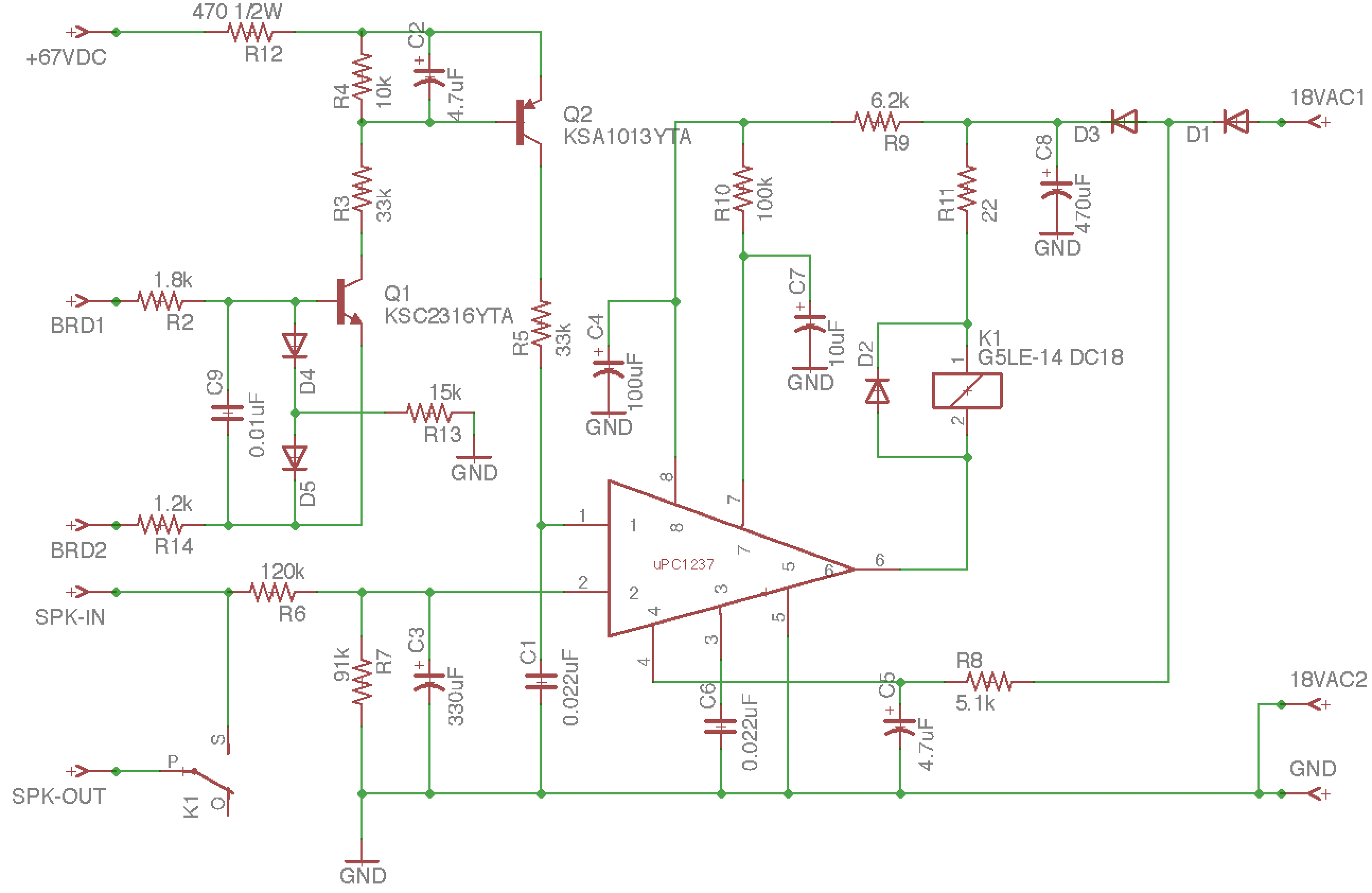

the spk-in passes through 120k and is filtered with 330uF to then feed pin2.
The 91k increases the time constant.
The R6+C3 time constant is ~40seconds to reach ~60% of the input signal.
Adding R7 probably increases RC to over a minute.
That seems far too slow.
One second would be more appropriate.
Try reducing C3 to 3u3F MKT and temporarily remove R7. Change R6 to suit the final RC value you require.
If voltage limiting is required for pin2, then add a protecting Zener across C3.
This is DC protection that you commented on. Does your comment imply that the DC trigger time will be as low as 1 minute using the values in my design?
I calculated R6 and R7 using the formulas in the data sheet to get DC protection triggered with anything outside +2V to -2V threshold. For C3 I used the same value as in the data sheet reference design.

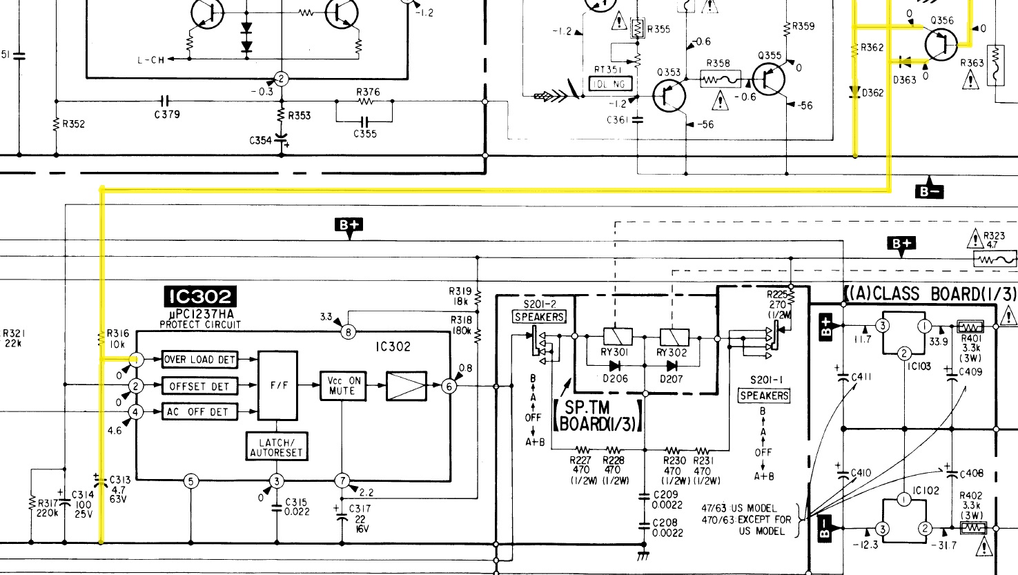

For comparison here are the R6, R7 and C3 values in the amplifiers that I found use the same/similar IC:
Sony TA N1 (uses uPC1237):
R6: 330k
R7: 220k
C3: 220uF

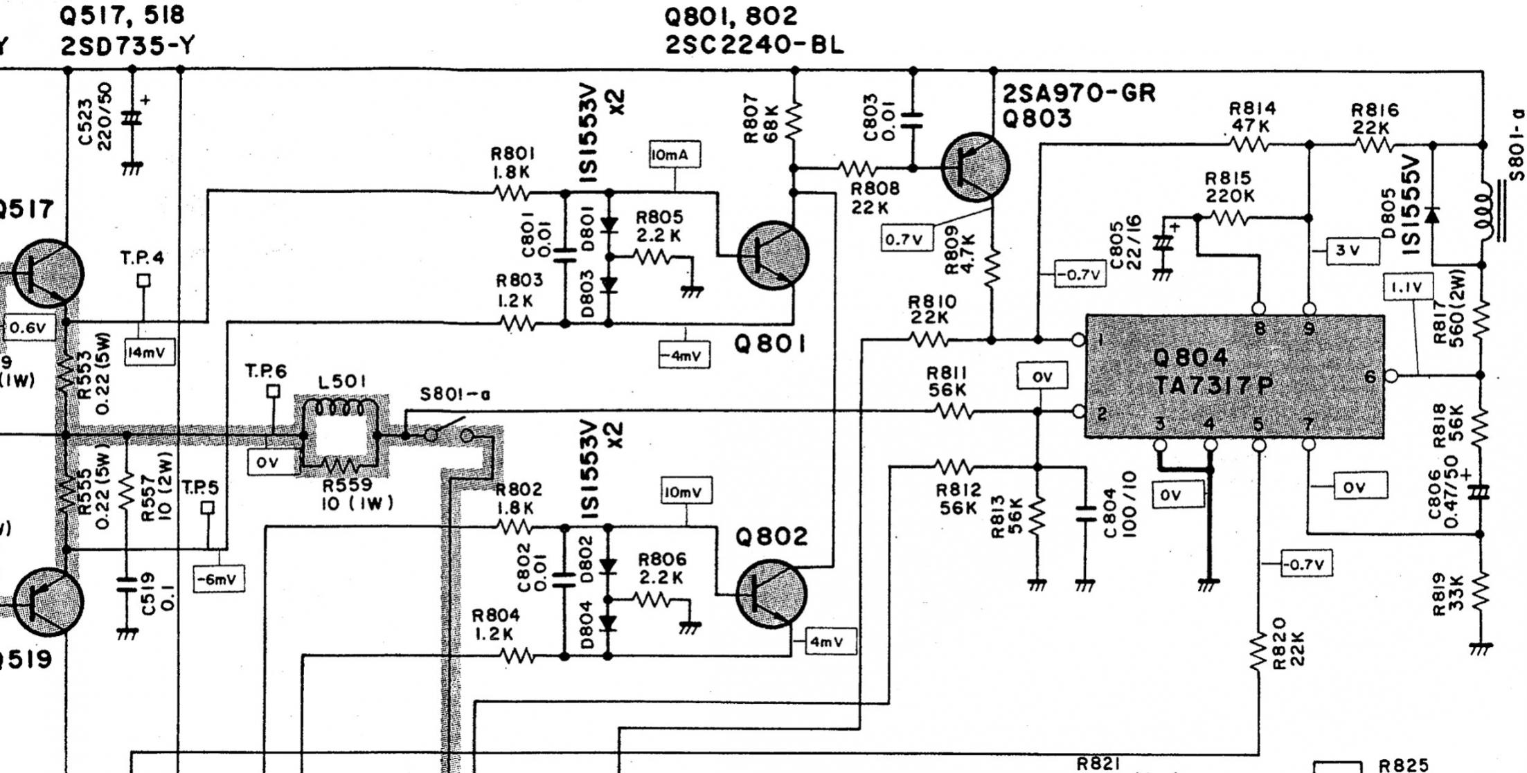

Marantz PM 55 (uses TA7317P):
R6: 68k
R7: absent
C3: 47uF
Technics SE H100 (uses TA7317P)
R8: 180k
R7: 22k
C3: 100uF
uPC1237 data sheet example suggests these values (based on DC threshold +1.24V to -1.04V):
R6: 56k
R7: absent
C3: 330uF'
Generally over-current protection gives me more headache than DC protection since things are less clear there and it is more difficult to test how it should be properly connected.
test your DC detect and trigger using a 9V battery and see how quickly it triggers.
Then try a 1.5V battery and see if it triggers and how long it takes. You might want to try other DC test/fault voltages from 3Vdc to 40Vdc and from -1.5Vdc to -40Vdc.
Then input a high level medium frequency signal and check it does not trigger. Slowly reduce the frequency. Eventually it will trigger. Maybe at 20Hz or 10Hz or 5Hz. Find out what frequency and level it triggers at. Are you happy with that?
If it triggers at too high a frequency, then increase the RC, or add in R7, but you must re-check the DC triggering levels and speeds.

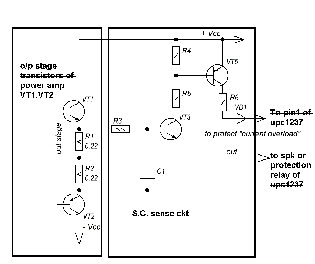

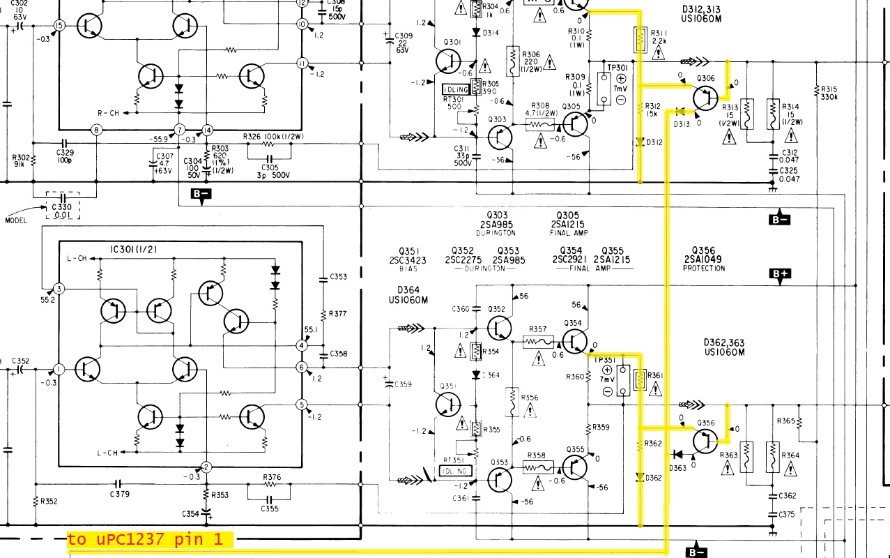

Found one more example of over-current protection using the IC, the power amp is Toshiba SC 530.
Toshiba uses both halves of the output signal to trigger the protection. This is the first time I see it done in a production amplifier.
I updated my own schematics to do the same. BRD1 and BRD2 go to the emitters of output transistors

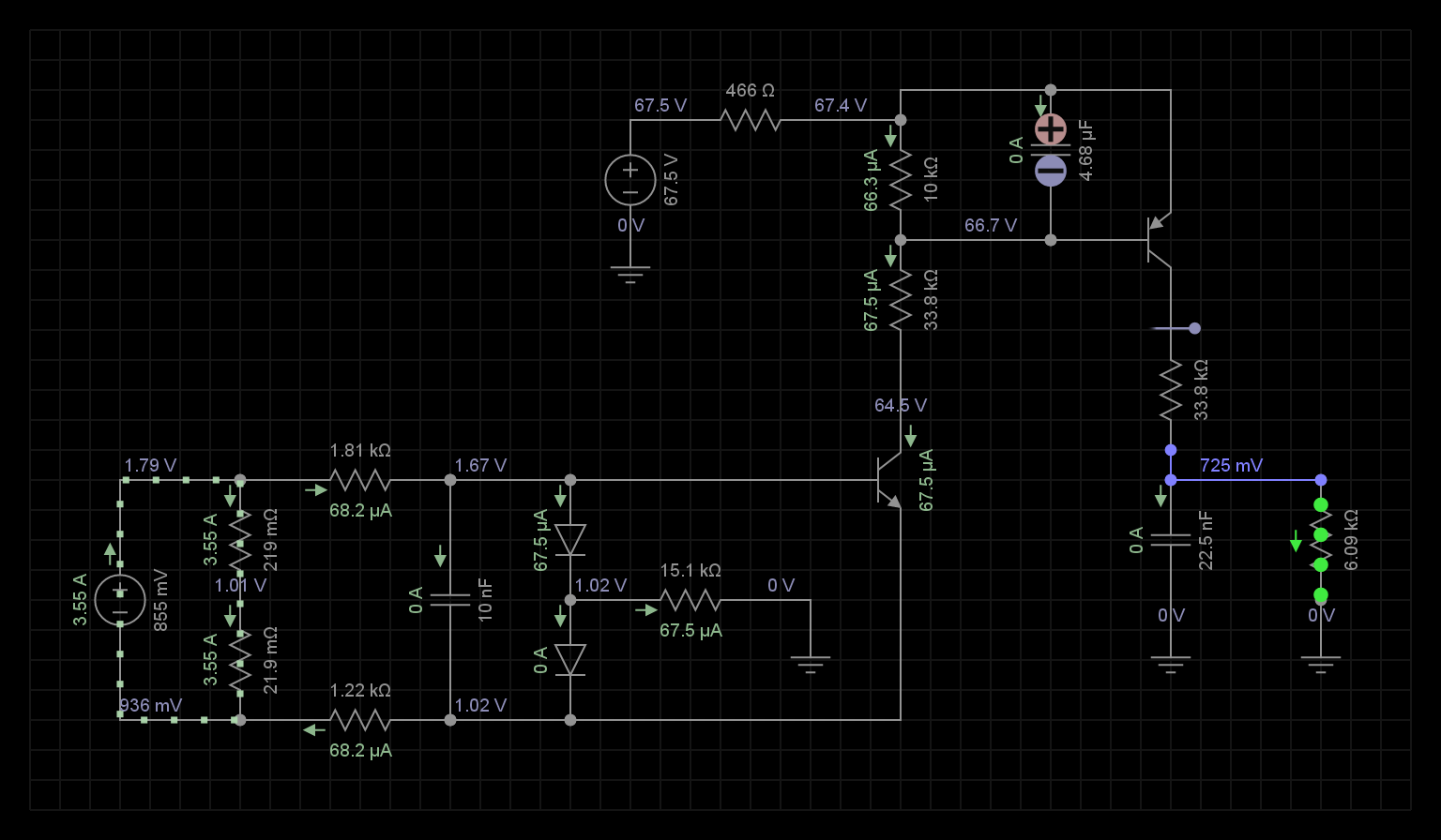

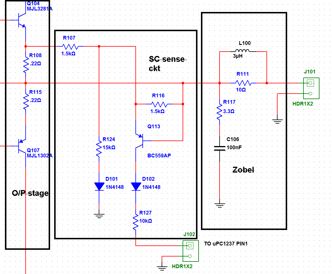

I ran my overcurrent protection through circuit simulator. With the selected R and C values in the schematic (and default transistor selection - I couldn't find how to customize transistors in the emulator) uPC1237 triggers when the current through a pair of amplifier output stage transistors reaches around 3.55A
I am using 3 pairs of NJW0281G (NPN) NJW0302G (PNP) in the output stage (this is Honey Badger). These are rated to 15A collector / emitter continuous current. It 3.55A too aggressive?
How does collector / emitter current translate to the current through the speaker? Do I just multiply it by the number of transistor pairs (3 in my case)?
Note to myself: I can tune up the current threshold by varying R4 value. R4 of 2.2K gives threshold of 6.7A and 1K gives 11A

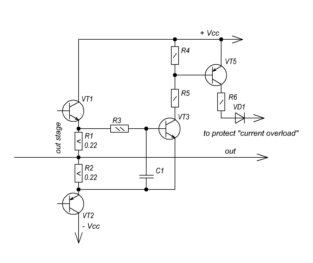

you should be looking at continuous DC current and longer term AC current and short term AC transient peak currents.
All three conditions and all those across the whole spectrum need to be detected and appropriate action (or non-action) taken to protect your speakers.
Look at the datasheet and extract the DC, long term and short term SOA limits for your chosen Vce.
Then arrange for the detector to read and apply triggering.

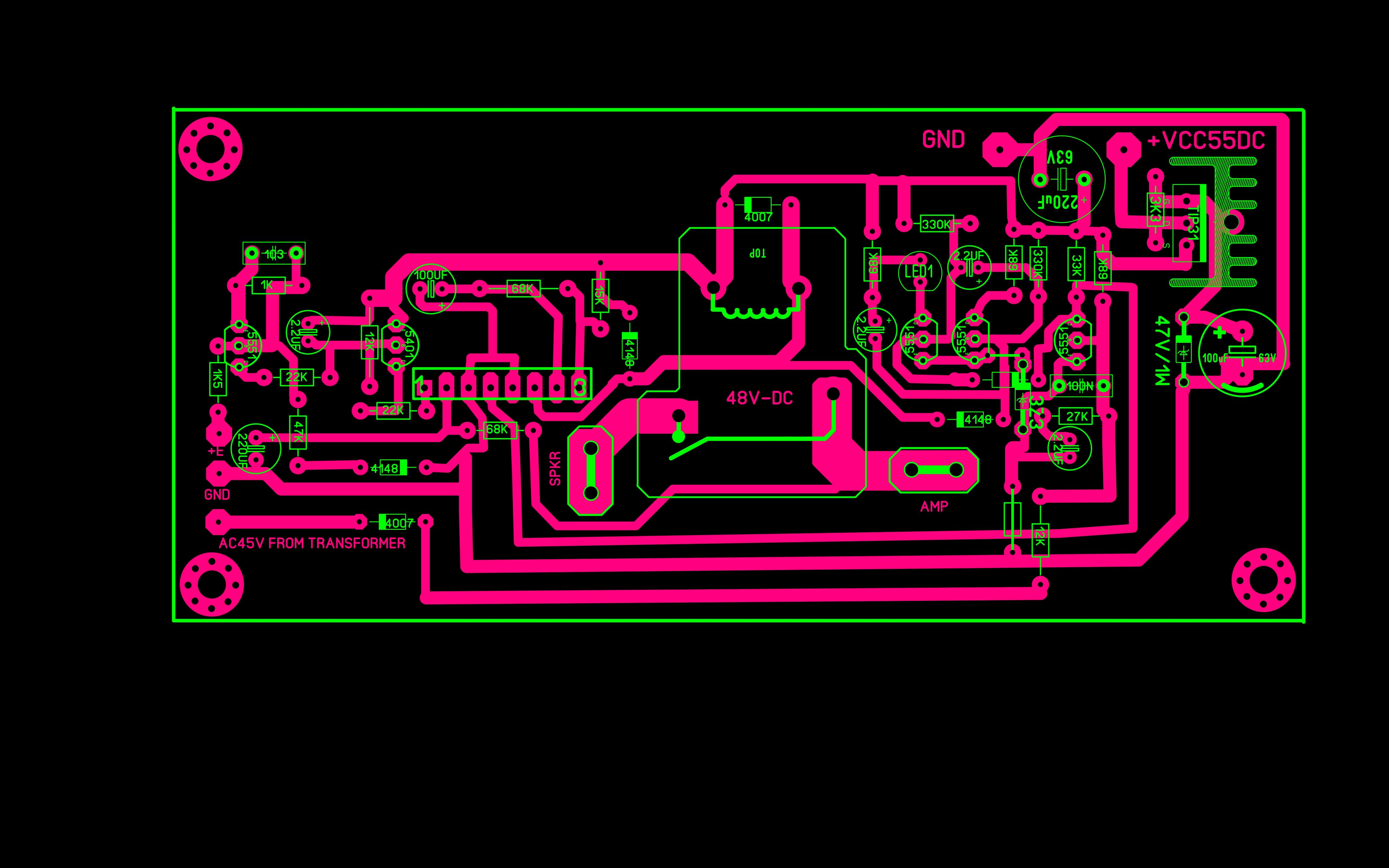

I assembled and connected the board as per schematic in post #84. It detects shorted speaker and DC - I tested these scenarios on the assembled board. I didn't test high current scenario.
Something happened last night thought that made me question if my protection works. I connected 220Hz sine input and cranked the volume up to max with no speakers connected. I had a scope on the left channel which registered peak 65V output. At this point one of the 4A power fuses blew. The protection didn't detect anything.
Is it correct to assume that my R4 value is probably too low and I should increase the sensitivity of the overcurrent protection circuit? Or is it just the unusual way I did the experiment that caused the protection to fail to see anything and it would do so OK if a normal speaker was connected?

You have 3 output transistors of each type in your output stage. So your trip current will be approximately 3 x 3.55 amperes, or 10.65 amperes. That is a more than reasonable trip point I would think.
So why don't we use an output transistor to it's full rated current and temperature dissipation? If you take a look at the datasheet for your output transistors, look for something called an SOA curve. Keep in mind that these are for resistive loads, no phase angle between the voltage and current components. You can see that as the voltage is increased across a transistor, the second breakdown limit restricts the current through the transistor. Now when you are powering a set of real speakers, they are what is called a reactive load. Depending on the frequency, there will be a capacitive component or inductive component to the load the amplifier sees. These reactive components change the phase angle from 0° to some other value. What this actually means to you is that the peak current flow does not occur at the peak voltage across the speakers. That means that at the zero crossing, your current is not zero and the transistors will be conducting current in a worst case situation. That means that you look at the full supply voltage on the SOA graph and determine what the safe maximum current the transistor can pass under those conditions. It's a lot less than the 15 ampere rating, isn't it? That's at 25 °C, once you heat things up, that current will be even less.
So that is why transistors cannot be used to their full rated values. Your protection circuit should be set up to limit current in the output stage to safe values, taking into account the tolerance of the emitter resistors where you sample the voltage drop.
