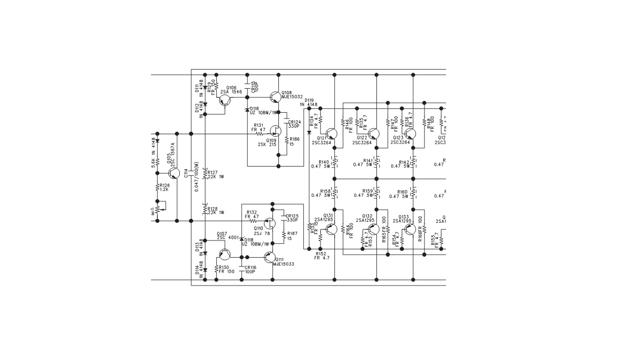

Here is another interesting outputstage. Any comments on the connection of those cascodes ?? In spice its hardly stable but the schematic shown is a real commercial offering.

Can you tell me from which commercial amp this is.
I simmed a few days back something 90% equal to that.
Regarding the cascode connection: they are looking pretty normal to me?
Greetz
That is from Inter, I dont know much about them, the scheme is used by accuphase as well since 1990s so there must be advantages except I cant get it stable....yet that is.
The cascodes would be conventional except here the base of the cascode is connected to the sources of the mosfets. Conventional cascode the bases of the cascodes would be connected to each other with no connection to the sources of the mosfets. As it is it looks more like hawksford type cascode connection and probably why it has stability issues.
