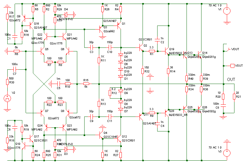

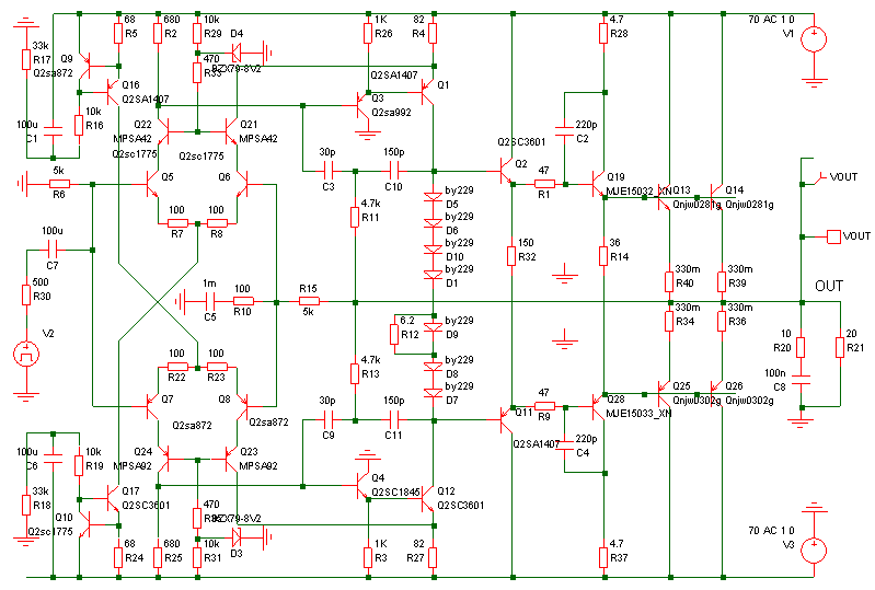

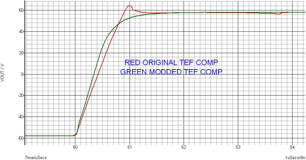

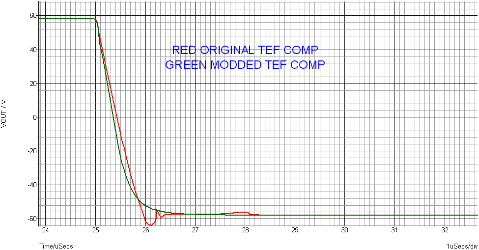

Here some sims of the original TEF step response as well as those
of a slightly modded version.
The idea of the latter is to reduce pre drivers agressive capacitive loading
by implementing a local miller loop , a solution find in many japanese amps.
The mod apparently reduce bandwith in small signal analysis , although
phase margin seems better by 15°.
When checking the OPS in insulation , the modded version has in fact
better slew rate overall with more or less regular slope while due to
capacitive loading the original version exhibit a brutal reduction in slope.
The amplifier s step response with the two circuits , using only
two output pairs and 20R load :

Wahab, looks like you put quite some effort into these sims. The networks between the bases of Q19 and Q28 and their associated rails in the diagrams above are not Miller compensation networks. They are damper networks, which along with the rail decoupling between Q19 and Q2 and Q11 and Q28 (not shown in your diagrams above) are designed to ensure that a Colpitts oscillator structure is not formed with the external circuit inductances. R1 and R9 (3.3 Ohm resistors) also aid in ensuring there is no parasitic oscillation in the output stage. I need to photograph the square wave response and post this up, but there is no overshoot on the final amp - note that the input filter is also part of the compensation network.
When looking at the compensation design, loop compensation has to be separated from parasitic prevention. The root causes of oscillation in these two areas are different.
I do measure slew rate with the filter disabled, but I don't think you can look at overshoot with part of the comp network (i.e. input filter) disabled.
In my write-up, note that when testing for squarewave response into an 8 ohm resistive load, this should be done by connecting the load before the output inductor - there should be no overshoot under those conditions. Again, when driving a normal load with expected capacitiance, then this is done with the load connected after the inductor and you can then expect to see ringing due to the tank circuit formed by the output inductor and the load capacititance.
