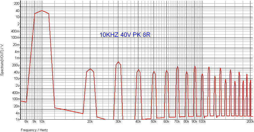

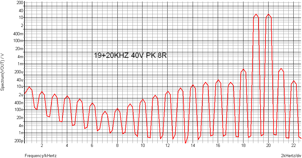

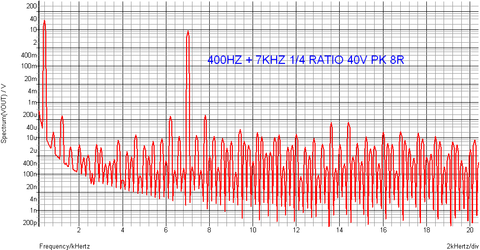

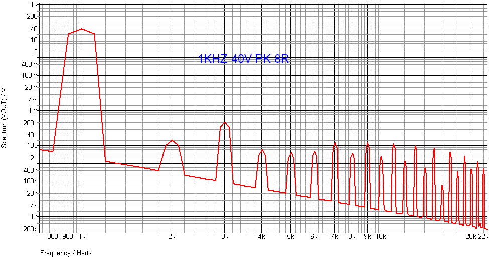

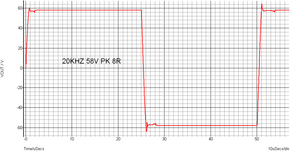

Simulation give quite good results notably very low THD and IMD
as well as high slew rate.
There s a few pictures below that must be of course taken with
a big grain of salt since it s only simulations albeit this will give
an accurate view of the general trend.
I d like to add a few observations for the sake of the technical discussion.
Providing an LR output filter is used stability seems good ,
in fact even without such a filter it is not easy to make it ring
other than marginaly using a relatively high capacitive load,
so it seems that the triple EF compensation work very well.
There s voluntarly high standing currents in the front end , something
that is advocated by R.Cordell for the VAS but in that case so much heat
is not needed since this stage is loaded by a triple EF that render useless
high drive currents.
The input differential current is high and all the thermal dissipation burden
is devoted to the common base pairs since the common emitter differential
has only 7.5V Vce , a value that will maximize its Cbc , 20V being necessary
to bring it close to its minimal value wich will also reduce the common base
stage TDP notably.
Enhanced VAS does not bring as much improvement as it would if a current
mirror was used in the source for obvious reasons but it help reduce THD by a few dB.
Cascoding the VAS would reduce LF THD to single digit ppm ratios but it
would lefts THD unchanged at 10khz or above while endangering stability
by a sizeable margin so it wont be missed , moreover with the already
very low distorsion ratios.
Anyway , a pleasant amplifier that is really high definition.
has only 7.5V Vce , a value that will maximize its Cbc , 20V being necessary to bring it close to its minimal value
There is no Cbc minimum. Starting from 1 volt and up to the junction breakdown voltage, Cbc decreases with SQRT(Vbc). The only significant error in this sqrt law is around zero volts, where things are a little more complicated. With a very good approximation, at 20V each and every junction (BC, diode, etc...) will have a SQRT(20/7.5)~1.64 lower capacitance than at 7.5V. Classic Gray and Meyer textbook stuff.

Thanks for the analysis Wahab.
I kept the front end cascode voltage low in order to minimize dissipation - a point you guessed correctly but perhaps one that I should have highlighted in my text. Certainly, running at a higher cascode voltage would also reduce Cbc. However, since the collector voltage of the input pairs are fixed by the cascodes, Cbc impact is substantially reduced.
Of course the high front end current facilitates high slew rates, and because the LTP is resistively loaded, must also support the current through them as well as drive Cdom. As I note in my text, the othe option is MIC, which by doing away with Cdom, will support very high slew rates. This gies the option then of running the front end at lower LTP currents.
A number of people's commented on the Ovation 250 that the VAS standing current was very high - a point I concede. This design is much lower, but I still prefer to run it 'rich'. I guess this is where as a designer you have the latitude to do things a bit differently. In the simulations, I looked for minimum modulation of the VAS standing current and looked at output loads from 2 to 8 Ohms.
Output Inductor. Yes, the e-Amp comp is conservative with plenty of room even driving quite a heavy capacitive load. But, I always think about the worst case scenario of a 2uF electrostatic hanging off the output. Note also that in TMC comp mode, the phase and gain margin are lower.
The minimal value is at Vbc max of the device , isnt it ?...:rolleyes:
Since this is a Sqrt law the reduction of Cbc over 10V start to become
marginal with increased Vbc , hence increasing Vcb to 20V , wich will
give a marginal improvement over 10V value but it was also to balance
TDP between the two parts of the cascode.
