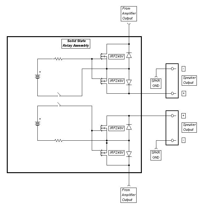

Here's what I use - simple, reliable, easily scalable, and quiet.
attachment.php
This is a nice idea.
I am thinking that it would also be possible to put these devices in the speaker ground return so the switching to the gates would be ground referenced. You would not be able to close the feedback loop around the MOSFET switches as you can do easily in your implementation, but at a few mOhms, that would hardly be a concern anyway. My only issue with the ground based scheme would be how it would handle the inductive kickback as the switches opened. Might need a snubber of some sort across the mosfets.

HI Andrew,
Yes the IRF540 will work just fine. If you have four IRF540's, a DPST switch and a couple of resistors (anything from 10K to 1Meg shhould be fine) it's simple to try. Only difference is the Rds rating of the IRF540 is nominal .044 ohms compared to .012 for the IRFZ48V that is shown in the original schematic. So with two of them in series total resistance in output to speakes would be increased by about .088 ohms, not huge, but will very slightly decrease damping factor of the system, that is one of reasons I chose the one I did. There may be newer MOSFET's available now that have even lower Rds at acceptable voltage rating than when I put mine together. And realize that adding such a small resistance to most systems probaly won't be audible at all. Also, the MOSFET's will not dissapate any power to speak of, so heat sinking isn't necessary.

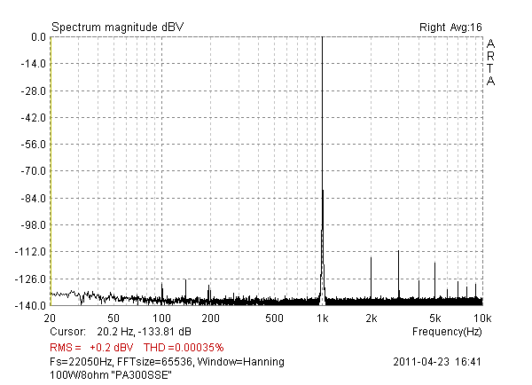

It is because of the unlinear resistance of the relay as a function of current through it, the distortion was like -60dB.
You used very bad relays...Attached picture is measured behind quite ordinary relay , at 100W/8ohm. Good relay is not a problem in terms of distortion, but in switch-of at high currents and DC
