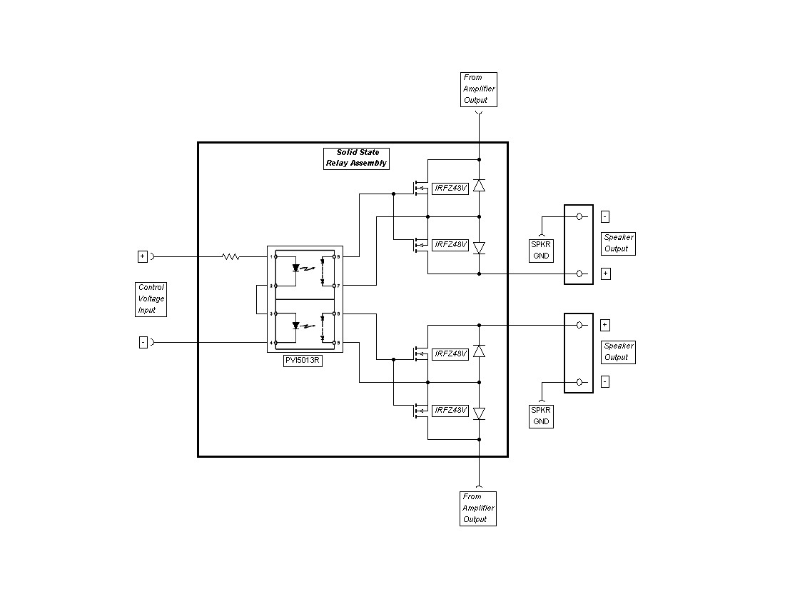

Here's what I use - simple, reliable, easily scalable, and quiet.

Well - SSR is almost perfect, when properly designed. Standard relay is almost incapable to interrupt high current DC arc, that may occur in a high power amplifier. And, even if it succeeds, you have to change it after 1st interruption ;)
WOW - :eek::eek: simple. Looks like some of the opto-coupled big industrial SS AC switches I've seen. 3uS turnoff - 100's of ac volts. .01R Rdson !
ASSR-1611 (halfway down the page) - ASSR-1611 datasheet, Pinout ,application circuits High Current, 1 Form A, Solid State Relay (MOSFET).
That's a small one - 30-60A units run $100usd and up.
Would be much cheaper to build one. :cool:

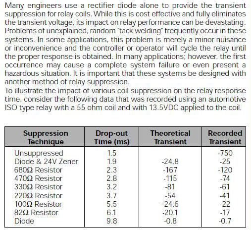

Speaking of welding relay contacts together, you should read this article on relay coil suppression techniques. If you just use a rectifier diode to suppress the transient you will slow down the release of the armature which can result in welded contacts.
Whole article.
http://relays.tycoelectronics.com/appnotes/app_pdfs/13c3311.pdf
Excerpt.

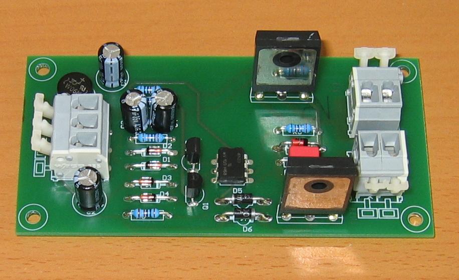

Those aren't steering diodes, in fact, if everything is working right, they do nothing at all. They're there to protect the MOSFET's in the unlikely event there's a large inductive kick-back at power down. When the MOSFET's are on, thier Rds (drain to source resistance) is a small fraction of an ohm, the diodes are shorted out and don't conduct. when MOSFET's are off, diodes are back to back and also will not conduct. The cricuit works fine without the diodes in there at all, I just felt it would be prudent design practice to put them in. And the device you call a photo detector is a photovoltaic MOSFET driver, when a driving current lights the internal LED's they shine on photo diodes which generate a low current voltage beetween 5 and 8 volts, enough to turn on the MOSFET's.
Here's how the circuit works. When power is applied to control voltage input, current of about 5ma (as determined by input voltage, minus total LED voltage drop, through current limit resistor) turns on LED's. Output voltage is then applied to MOSFET gates and switches them on. The advantages of using this circuit verses a mechanical relay are; faster on-off switching, no mechanical contacts that can arc and burn (or weld themselves together!), can be driven by a wide range of voltages with small current requirement, is easily scaled for higher power amps by parelleing MOSFET's if need be, and they work quietly - no mechanical noise when turned on and off. Only possible disadvantage is the small Rds could very slightly decrease damping factor at amplifier output, and the MOSFET's Rds will vary a tiny bit depending on currennt level though them, but after extensive listening tests I've never heard any audible artifacts of any kind. With all the advantages, I'll probably never use a mechanical relay for speaker switching agian.
