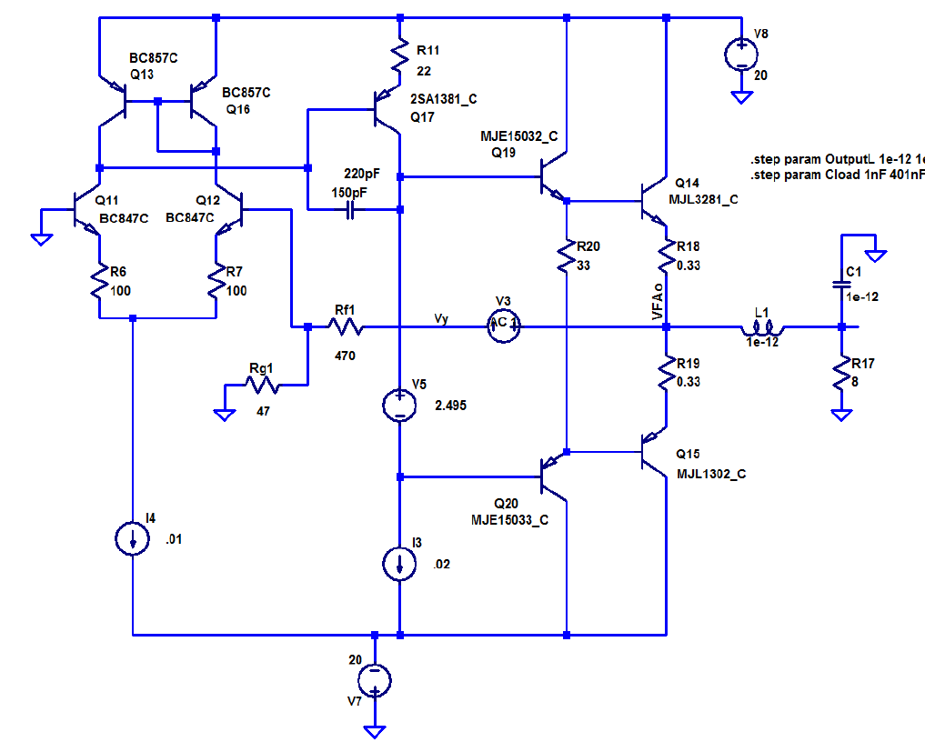

My apologies, I forgot to mention that the OPS is a class-A self-bias design, hence it always runs in class-A (100W/8R as shown in the schematic). Only when pushed hard (>rated class-A output power) it enters class-B territory by means of a different mechanism that modulates the OPS input transistors. The THD hits a proverbial brick wall at that point.
Hi SSassen,
Thanks for the clarification. Nice performance!
Bob

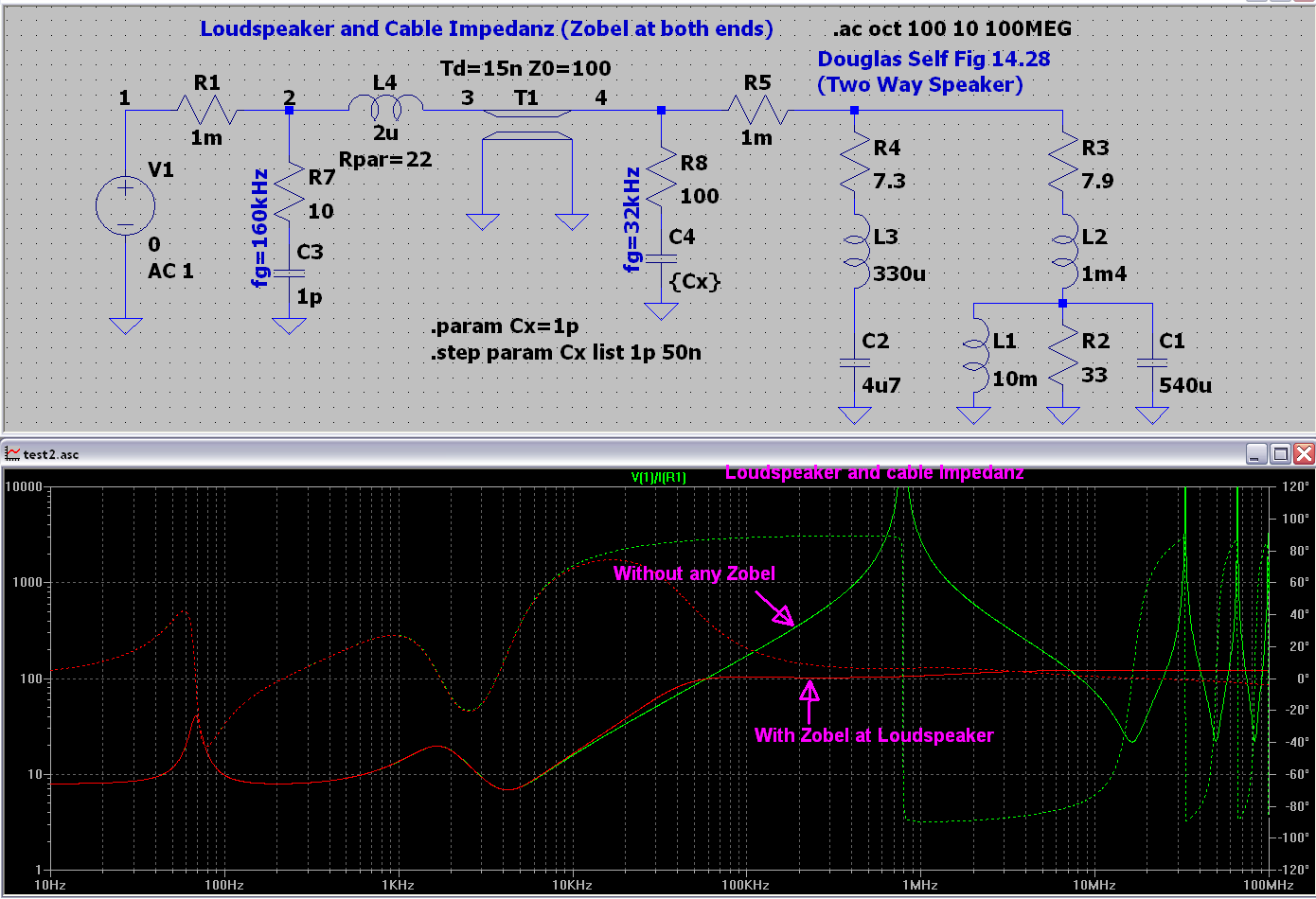

The next picture shows the influence of the R-C Zobel network.
Without the Zobel R-C the line input impedance is capacitive above 600 kHz.
This is critical, because in this region the current gain (beta) of the emitter follower output transistors is falling with 6 dB/octave.
A capacitive load is transformed to a negative resistance at the base. This can lead to oscillations. A R-C at the base, a base stopper, or a R-C at the output can help to stabilize the emitter follower.
A slow output transistor has a Ft of 5 Mhz and a Beta0 of 25. Beta is falling
above 5 Mhz / 25 = 200 kHz and is 1 at 5 Mhz. In this region transistor current
gain beta is Beta0/(j*2*pi*f).
The Zobel R-C is resistive at this frequencies and dampens oscillations.
It is remarkable that this has nothing to do with global feedback stability.
R-Udo

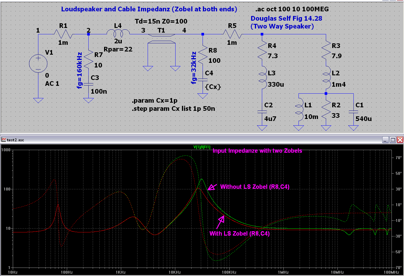

The Zobel at the loudspeaker end works similar to the one at the amp end.
The terminated transmission line behaves like a 100 Ohm Resistor, which is in parallel to the loudspeaker impedance.
Above 32 kHz the amp is seeing a 100 Ohm Resistor. 32kHz may be too low as it has a measureable effect on impedanze (phase).
For audio the loudspeaker and crossover impedance is maybe enough to terminate the "transmission line".
Problem (or Oportunity to earn money:)): You must provide a "special" loudspeaker cable with your amp.
The second picuture shows the impedanz with both zobels in place. You clearly see: One is enough...
R-Udo
