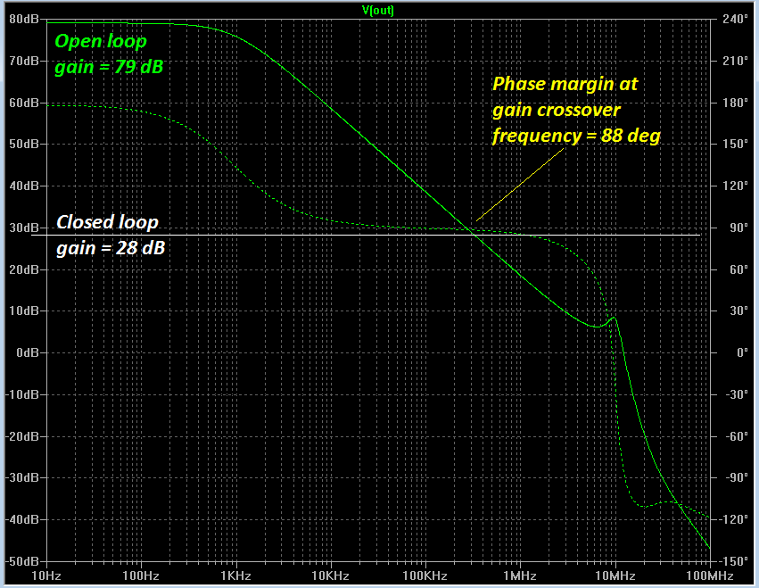

I happen to think your explanation is all wet, at least with respect to Nelson Pass's A40 class A amplifier. It has no output inductor. Making cheap-and-cheerful substitutions for the long-obsolete Lambda power darlington output devices, simulation of the A40 schematic in the above link says the gains areIn Nelson's case his amplifiers (not familiar with A40 circuit details - is it ZGF?) they tend to be low feedback types, so the HF poles fall close to or below the 0 dB gain point. This type of amp can tolerate nasty loads without an output inductor much better than high loop gain types.
- First stage (NPN diffamp with resistor load): +11 dB
- Second stage (PNP common emitter with current source load): +68 dB
- Output stage (darlington EF push-pull biased @ 1.5 amps): -0.2 dB
- Entire amplifier: +79 dB
The simulated open loop frequency response is attached. Closed loop gain is (1+(R5/(R4+R3)) = 24.3X = 28 dB, which I have overlaid on the simulator results as a thin white line.
If you decide to simulate the A40 yourself, I think you will enjoy fiddling with the compensation capacitor C4; Pass has connected it in exactly the configuration that Douglas Self warns against (APAD 5th ed. Fig 8.2), from 2nd stage collector to 1st stage base. Pass calls this "lead compensation" (Fig. 7) and shows that it improves damping factor compared to the "lag compensation" (base to emitter of 2nd stage) that Self favors. Your own simulator fiddling will also reveal the benefit or detriment the lead compensation has upon phase margin.
Possibly of note is Pass's remark that "Fig 7 also shows the high (300X), wide-band damping factor, which serves particularly well into low impedance, especially reactive loads." Perhaps this may be indicative of why he's comfortable omitting an output inductor.
That doesn't look like a "low feedback type" to me.

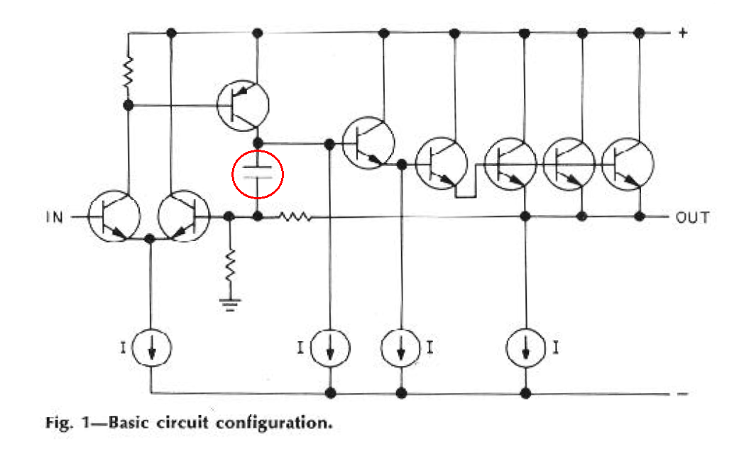

The compensation Self was referring to in his Figure 8.2 is Miller Input Compensation, which I described and used in my MOSFET EC amplifier in 1983. Self referred to its use by J. Linsely-Hood in 1989 and Marshall Leach in 1988. Self apparently did not realize that the loop so formed usually needs to be compensated itself for stability, albeit at a fairly high unity gain frequency above 10MHz. This form of compensation permits enormous slew rate to be achieved. My 50-watt MOSFET amplifier had a slew rate of over 300V/us.
MIC is neither lead compensation nor feedforward.
Bob
And the A40 in 1978, and the A20 {shown below} from the DIY article in Audio magazine, Feb. 1977 (link; be sure to download the pdf) Unlike the A40, the A20 doesn't even use a push pull output stage.Self referred to its use by J. Linsely-Hood in 1989 and Marshall Leach in 1988.
Take it up with the 1978 version of Nelson Pass; he's the one who designed the A40 and referred to its capacitor C4 as "lead compensation". (link 2)MIC is neither lead compensation nor feedforward.

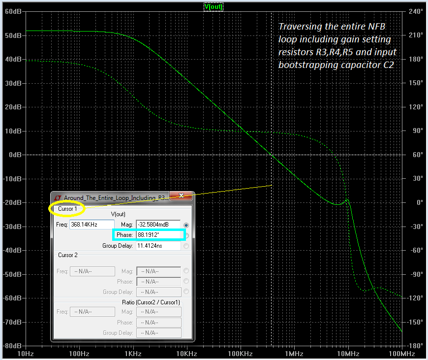

It looks to me like you've plotted open loop gain [ed. in post #81] above, and not loop gain.
That's the open loop gain of the amplifier itself, without the feedback network; I plotted it that way to show that in fact the A40 has quite a lot of gain: nearly 80 dB at frequencies below the dominant pole. (Some readers couldn't be bothered to glance at the schematic linked in post #66, to see the high gain 2nd stage with current source load.)
Please feel free to build a simulation of the A40 amplifier yourself, if you wish. This will allow you to simulate it including the feedback network if that's what you prefer. You may enjoy working out a way to include the positive feedback of the input bootstrapping network, in simulation. (I enjoyed that). I predict that your simulation results, plotting around-the-entire-NFB-loop-including-gain-resistors frequency response, will resemble the figure below. Notice that the phase margin is 88 degrees, the same number as in the post#81 image.
