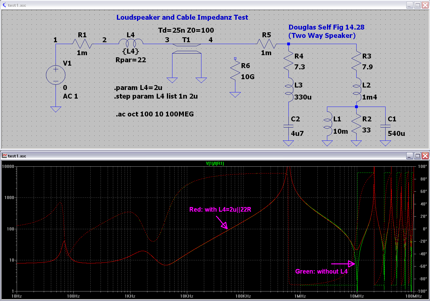

I have done a Spice simulation with a simple loudspeaker model and a transmission line (3m cable) with and without a Zobel inductor (2uH || 22 Ohm).
There is no difference in input impedance below 10 Mhz. The conclusion is:
If the amp is driving a cable and a loudspeaker, the Zobel inductor L4 can be omitted.
BUT there are people testing amps with capacitive loads. In this case the Zobel inductor helps to avoid local oscillations in the output emitter follower.
For 8 Ohm resistive loads the results are similar.

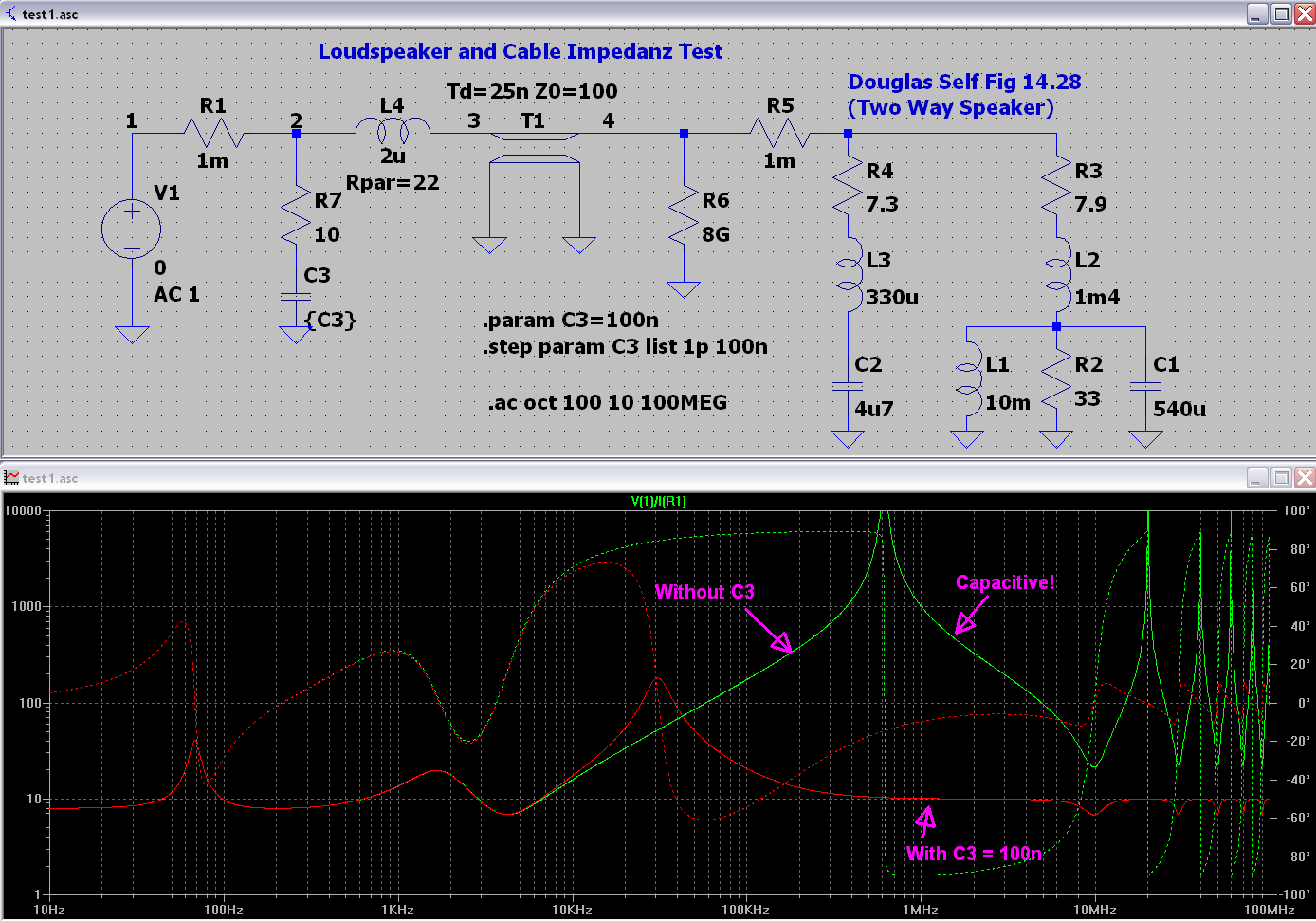

The next picture shows the influence of the R-C Zobel network.
Without the Zobel R-C the line input impedance is capacitive above 600 kHz.
This is critical, because in this region the current gain (beta) of the emitter follower output transistors is falling with 6 dB/octave.
A capacitive load is transformed to a negative resistance at the base. This can lead to oscillations. A R-C at the base, a base stopper, or a R-C at the output can help to stabilize the emitter follower.
A slow output transistor has a Ft of 5 Mhz and a Beta0 of 25. Beta is falling
above 5 Mhz / 25 = 200 kHz and is 1 at 5 Mhz. In this region transistor current
gain beta is Beta0/(j*2*pi*f).
The Zobel R-C is resistive at this frequencies and dampens oscillations.
It is remarkable that this has nothing to do with global feedback stability.
R-Udo
