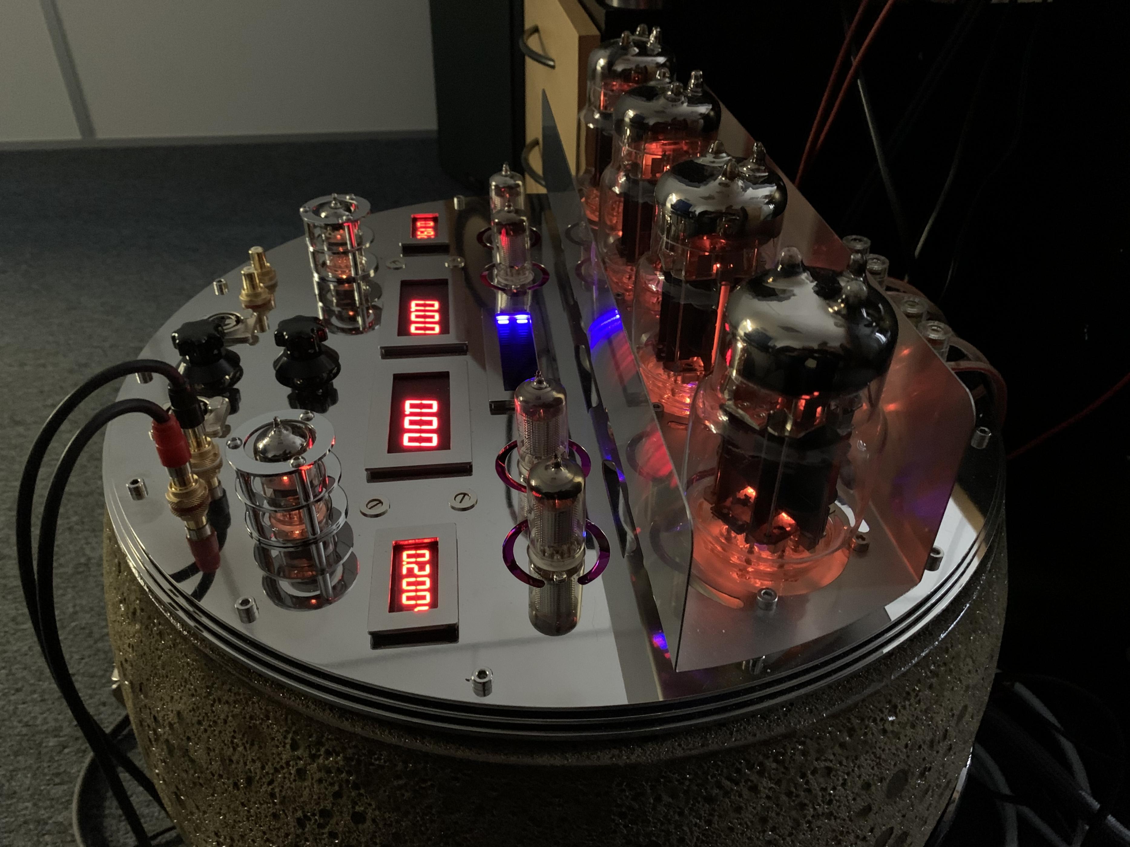

At 70˚C now. But I'm going to lift them up tomorrow.
Meanwhile thinking of heat-resistant spacers/standoffs which also insulate more or less the heat and don't transfer it that much onto the chassis. (I don't want to use small wooden spacers, they just get loose with time, whereas metal transfers heat).
These spacers are not so critical. Just left the space between chassis and sockets couple of mm (for air moving from inside of the chassis to outside). The most of heat to the chassis will be transferred through the heat radiation from the tubes itself. When biased to 200mA the plate (anode) temp will arise to 280-290 deg C. Venting the tubes does not help like vacuum is the best insulator and the only way the heat can leave is radiating...
So, be careful with distances between 6C33 tubes. The minimum is at least 50mm. If you install them closer to each other they will start to overheat each other and this could cause the thermal "runaway". 50mm is safe distance.
Lift the sockets up. Like insert M4 bolts in mounting holes or something to lift them and grant the air access to the socket bottom. Othervise you can easily overheat the contacts and socket itself as well.

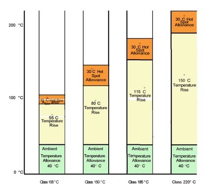

there are standards for the max insulation temp in transformers below 10kVA and which one applies to yours should be printed on the trafo label:
look for something like EN61558 and UL506 / Class 105;
Insulation Temperature Class 105 is the lowest and means that the hottest spot in the windings shall not exceed 105C based on 40C ambient, 55C temp rise, +10C allowance for hottest spot.
Higher classes exist (attached).
Can we measure the rise in temperature inside a transformer winding ?
Yes, we can. Well, at least the average temperature.
The temperature coefficient of copper is a little less than 0.4% per deg C.
This means that a 55 deg rise corresponds to 0.004 x 55 = 0.22.
Thats a 22% increase in DC resistance of the primary and easy to measure.

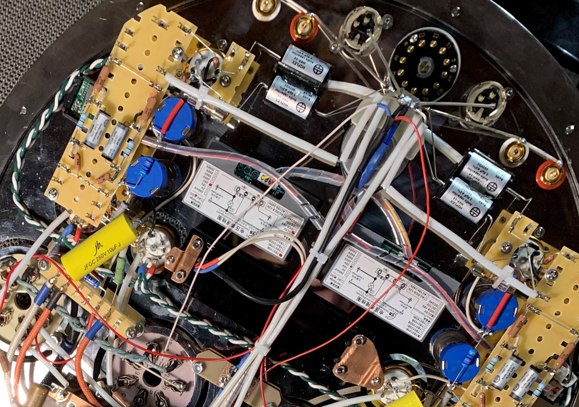

On my pic you can see the toroids too. 2x 400VA for anode voltages (1 transformer per side), 1x250VA for 4x 6S33S-V heating. All in their own metal casing, cast resin type. I intend to put these transformers onto the bottom just so, metal touching metal, so they get a little bit larger surface (namely the chassis itself) to dissipate warmth. Fixing them is from the bottom, a M6 thread goes towards their center, so 1 hole is enough on the chassis.
I'll be curious how warm they will get with top plate mounted and chassis closed - on natural circulating air.
The little toroid for small-signal tubes (non-cast) will be of course isolated from chassis with it's supplied mounting materials (2 metal discs and flat round rubber spacers of the same size).
