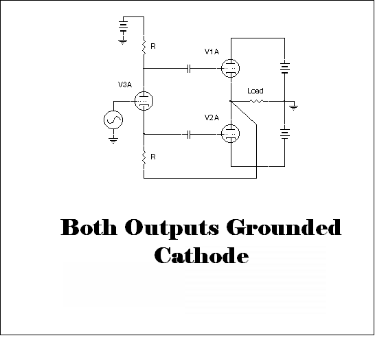

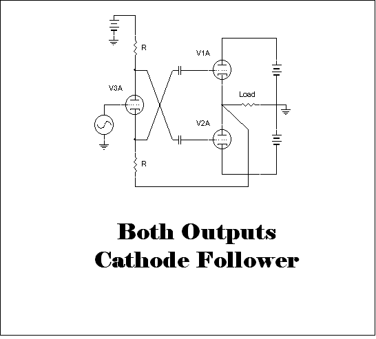

If you do this you have to be aware that it also changes the way the output tubes work.
This is essentially a Futterman architecture.
Futterman in his patent claim for his H1 OTL he erroneously stated that both output tubes worked in cathode follower mode; this was not the case because the way he hooked them up they actually were both grounded cathode.
Later designers of OTL circuits fixed that by swapping drive signals, requiring another stage front up.
See the attached pictures. 6C33C OTL
If you swap drive signals in Tim's amp you will turn cathode follower operation into grounded cathode operation.
Whether this makes any audible difference has to be investigated, so you can try it out. The amount of FB in this amp may make up for the change in output impedance which is a small signal issue anyway.

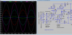

Oh no.
Apart from phase inversion, tell me what else has changed? Play with sim if in doubt.

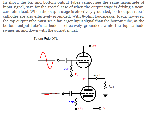

What I have learned is that in a totem pole architecture the lower tube works as grounded cathode, while the upper tube works as cathode follower which requires more drive voltage than the CF. Otherwise the output stage is grossly unbalanced.
OTL Amplifier Remake
I also learned that Futterman's idea was to bootstrap the splitter / driver such that the drive signal to one of the tubes is increased (or lowered) such that both tubes work the same and balanced.

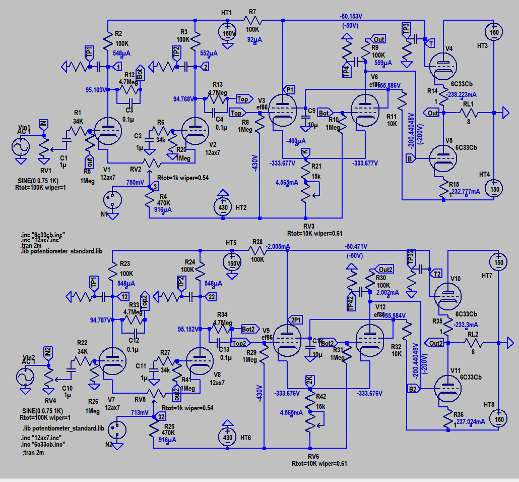

I assumed that the Tim Mellow's also has balanced drive ... but you may be right because everything looks symmetric ...
Now this brings up the question: does this amplifier have an unbalanced output stage in the first place ? Or what circuit detail balances the drive then ?
And if it is unbalanced, does it only rely on GnFB to make up for that ?

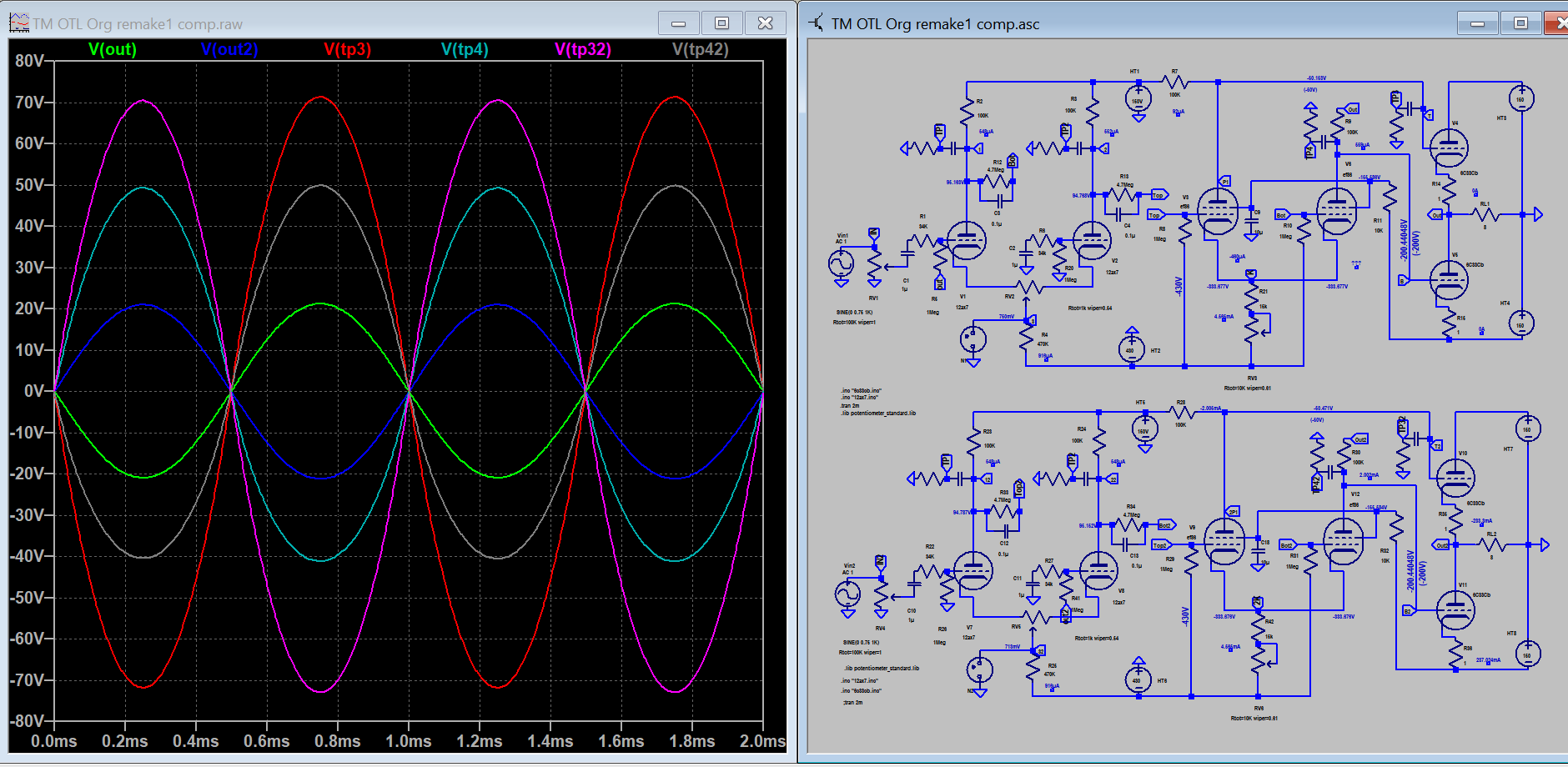

I posted this before, how to accept XLR input 4Vp, now again. gNFB is not connected to show how well the LTP balancing is, various level before feedback is applied. There appears to no mod is required except you make your own input pad at the XLR box or the OTL amp side. The only mod maybe the volume pot is dual gang 100k pot. The pot for XLR level adjustment is 600 ohms dual gang. If you adopt the way, move the feedback to the the other LTP input is meaningless.
Sorento,
The key component that balanced the output is R13 100k resistor connected to output. This resistor is also plate load of ef86, this LTP will give a higher drive level to the top tube and lesser drive to the bottom tube thus balance is maintained. This makes top output a ground cathode amp (just like the bottom), with equal gain. There are more than one way to achieve balance drive.
PS, In more detail operation: The gain of LTP stage is determined by the input side tube, when the gain of other tube is reduced there is no effect on the gain of right side, so only the left side gain is reduced. Of course, Futterman OTL try to increase the gain of right only (bootstrap), but the left side gain will be increased also as described above and consequently output Z is higher and less accurate. But there another way that can increase the gain of right side and decrease gain of left: feedback is applied to tail of LTP!

Ah, this is what I was looking for and what I failed to see.
That enlightens me, thank you very much.
