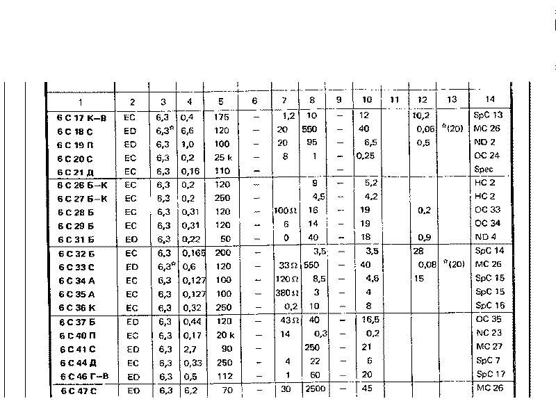

Beware of pulse measurements like this, as I wrote before oxide coated cathodes can support much higher currents during pulse conditions then for steady state, for an OTL this is not valid as the tubes need to support high current during longer period with low frequency tones.
It is possible to get some idea of the current a tube can support by checking the heater power, the higher the heater power the higher continous cathode current can be supported.
As an example the 6C33C draw 6.5A at 6.3V or ~41W, this tube is rated to support 550mA continous current but works well in OTL where it easily can give 2.5A without ill effects. The EL509 or PL519 have only ~12W heater power and although it is specified at 500mA continous current you can not assume that it is able to support the same current as a 6C33C. I dont know the 6C47 but would be interested i this one IF: it is a triode, it has reasonable heater power, and is generally available.
Heater power is one thing but in order to support high current at low voltage you also need a tube with low Ri and high Gm, the tubes if they are triodes have extremely small distance between cathode and grid and are therefore more sensitive to mechanical manufactoring tolerances then more normal tubes. The tubes with lowest anode voltage for a given current are penthodes, an example is PL519 that can give 1.5A, (at least during pulse conditions) with anode voltage 70V, BUT that is with a screen grid voltage of 190V and significant screen current that make the tube very unlinear during these conditions. My conclusion is that it is better and safer to use a triode like 6C33 with somewhat higher anode voltage but with better linearity and also with more assurance that it will be possible to source tubes in the future that have the same performance.

Frank! I mean the 6c47C power triode. May be I am wrong, but I heard it is brutal. What I only find is the attached data pic. where the IA is 2500mA on 70V.

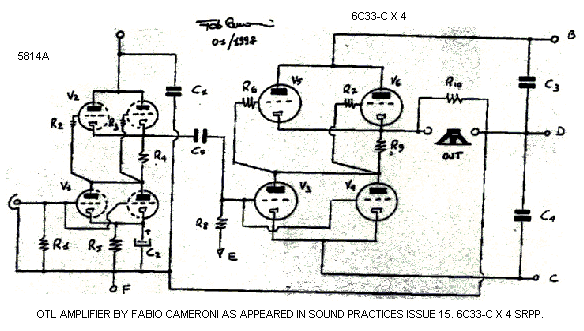

It should but I don't think there's enough there to get it going.
Here's where I first saw it:
CAMORANI OTL
Unfortunately I don't have a copy of the Sound Practices issue.
Still, expect B+ to be well above 100 VDC.
From what I understand mr Camorani is an engineer who also runs an audio company called AudioNautes.

The table with data of Russian tubes looks a bit strange to me, column 3 is clearly heater voltage but if column 4 is heater current there are some errors, for instance for 6C33C.
Tyimo, can you tell us what each column means in the table? then it is much easier to judge if this 6C47 is for real or not.
