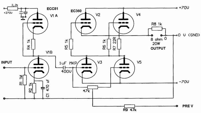

Hello,
Well, this one uses the same output tubes .
Also, does anyone tried this version, any comment on sound ?
Best regards,
Kristijan Kljucaric
http://web.vip.hr/pcb-design.vip

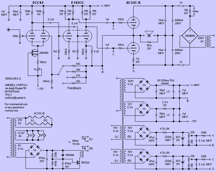

AT LONG LAST...
Pardon my sarcasm on the first bias supplies.
Honestly they showed a lack of understanding beyond (my) belief.
What you present is a bias supplly allowing you to corrrect some inballance at least.
This is exactly what _arg and myself have been discussing off "forum" for a while.
The Cufioli circuit may seems complex,in reality it is made complex for no reason at all.
With all OTL circuits,pay attention to the PSU.
EC360 I dont think is a very common tube and can be difficult to source.
Where did you get the schematic? It is not possible to get 20W from only 4 of these tubes especially with only +- 70V anode voltage. The EC 360 is only specified to max 250mA current which doesn't take you very far, you need ~2.5A peak to get 20W. The 6C33C can give you this current but then you need a voltage of ~140V minimum.
Regards Hans
Regards Hans
Hi Hans!
Thanks for the answers!
Here in Hungary some people built it already and it works. I try to get contact with them for more info. I think the schematic comes from an amp "cookbook", but I would like ask here some international tube guru for oppinions. I read the EC360 can easily work on such a low voltage and with 200mA. May be the 20W output is a dream, but the main question is: could this circuit work or is there any error?
Thanks!
Thanks!
It should work as far as I can tell.
BTW, the EC360 was only made by one factory in the ex-DDR if my information is correct.
