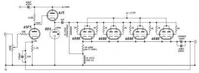

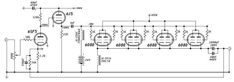

Could somebody tell me where can I (or We) find the full article of the Camorani OTL??? It is looking so nice...
