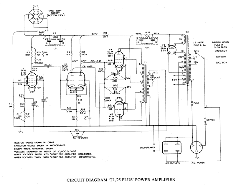

Wasn't following from the start, but isn't the cathode coupled phase splitter connected to the wrong output valves? Like the first half must feed the lower KT88 when its reversed now? Look at this example.
The FB signal applied to the voltage amplifier cathode must be in phase with the signal applied to the voltage amplifier grid. If the signal at the 8 Ω speaker tap of the O/P trafo is out of phase with the I/P signal, exchange either the O/P trafo primary wires or the lines coming from the phase splitter, but not both.

Regarding the feedback, I use the dumb method. Wire it up leaving the feedback disconnected at one end. On the disconnected end, use a wire with alligator clips or similar. With the scope connected to the output and a signal at the input, connect the feedback circuit with the alligator clip. If the amplitude increases, your feedback is positive, if the amplitude decreases, the feedback is negative. If the feedback is negative, all is OK. If it is positive feedback, correct using the method Eli describes above.

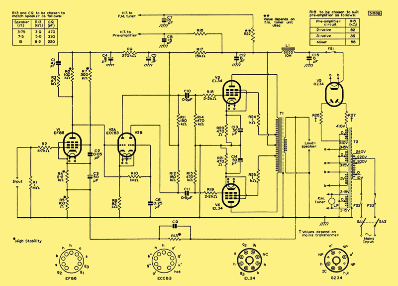

Salas, Attached is the original Mullard 5-20 diagram. I think it is a matter of symantics as to how it is drawn in this case as long as they are in phase. I put a signal generator symbol with a positive wave form to indicate phase on the input and output.

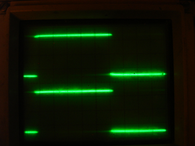

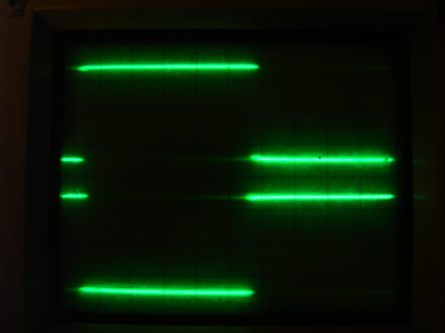

I have come to the conclusion that my second channel on the osc scope is messed up worse than originally thought. Now I am not sure if I have the signal in phase or not. I ran a test signal through both channels, one instant they are in phase the next they are not. Thought I was seeing things so asked the wife to look and she said they looked the same???????? Oh Well. Good excuse to go to ebay, have a "new to me" scope coming next week, a Tek 2430A. I think that will do well for most analog stuff.

Attached photos are of both channels hooked to the calibration rail. The first photo shows them out of phase. The second shows it in phase. Didn't touch anything.
Even though it probably has to do with the trigger, channel two won't calibrate correctly with 10x or 100x probes. Have to wiggle the sensitivity selector to display the signal.
