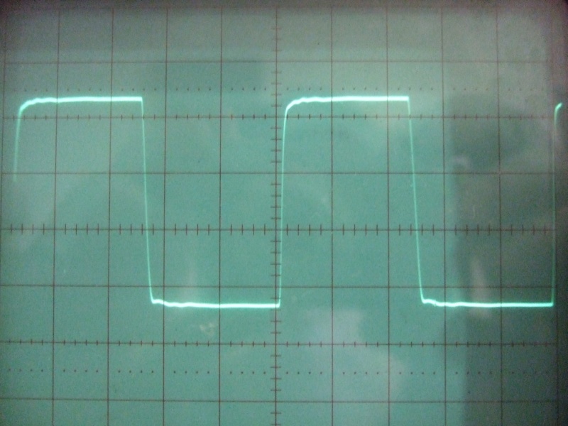

I should mention that the above scope pictures were aat the onset of clipping of the driver stage.
A decent design should clip the "finals", before the small signal circuitry clips.
No lack of "stones", as it should be. :D
Tweak away! Get the residual hum level down. Adjust the phase compensation cap. value, to get a good looking 2 KHz. square wave.

Version 2 Measurements
Amp is doing pretty well now with No Feedback. No stability issues what so ever. I increased the decoupling between output and driver stage which really quieted down the noise I was seeing.
Attached are the latest measurements. Running 485V B+ for output stage and 470V for driver stage.

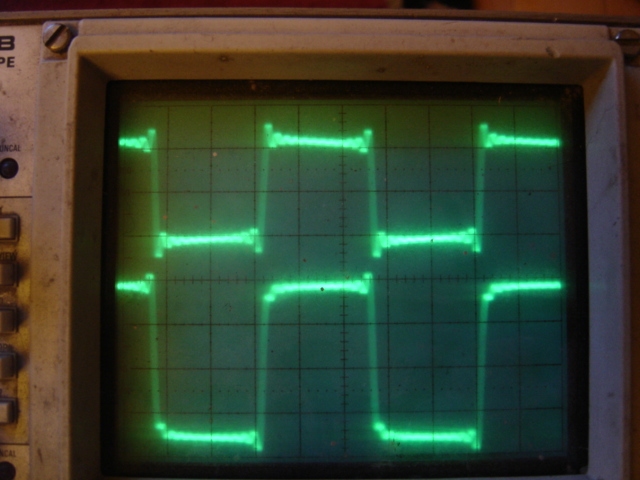

The first is a picture of the THD vs. freq for 50,55, and 60mA Bias. The second is the spectrum at 40W output. and finally a picture of the square wave. top trace is amp and the bottom trace is of input. My signal source isn't great and my 2nd channel on th scope isn't right, I can't calibrate it correctly. The leading edge of the input is really identical to output trace. I won't complain about the scope as it was given to me a while back.
Absolutley NO Hum visable or perceptable.

Would larger R value grid stoppers take care of the oscillations shown on the square wave?
I had ringing on the leading edge of the 10Khz sq wave in my no gfb EL34 triode amp only when changing input amplitude; they would immediately decay at steady state.
Adding grid stoppers took care of the problem completely, although the leading edge is a bit rounded.
The ringing/oscillations comes from the source. The output is almost identical to the input. The only difference is that the top edge has a slope to it in the output. I need to get a better signal generator!!!! In my latest design update, I did up the value of the grid stoppers to 510 carbon. Maybe I should order some 1k carbon and see if things improve further?

A couple of notes. My square wave generator is not good. I think I confused the issue by showing the picture of the graph that I did. My input signal from my EMU 0404 sound card rings that badly. I'll try to take the signal off of my calibration post on the osciliscope, That is a nice clean square wave.

I have the Tracker Pre, almost the same to 404, no good for square waves. Good for FFT. The cal on scope is usually 1kHz & 1MHz switchable for trimming the probe's square. You gonna need 10kHz too for doing better the closed loop sqw smooth out is one thing. But you can do enough on 1kHz.

I have a vintage Topward gen, really mediocre but still does it clean VS the card. For tuning squares on valves you need a real gen with some Volt output and low Zo, soundcards don't cut it, they do wiggly squares, noisy if just gens out of software cleaned loop, and need an input protection scheme not to be killed if to FFT probe anodes, power grids, OPTs and stuff. You did well you splashed out on a decent gen. Ebay circa $300?
