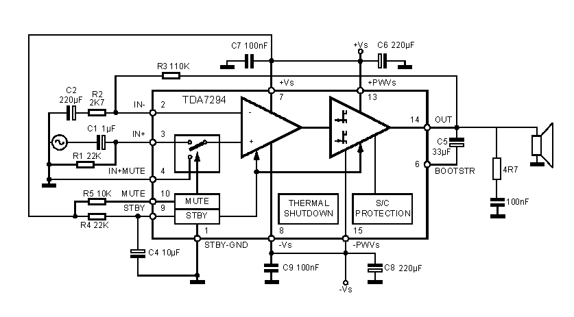

For TDA7294, TDA7295, TDA7296
Here's a high stability schematic (attached).
Chart R3 this way.
(transformer voltage), (feedback resistor value)
24+24vac, 110k
22+22vac, 91k
20+20vac, 82k
18+18vac, 75k
15+15vac, 68k
14+14vac, 62k
Chart R3 this way.
24+24vac, 110k
22+22vac, 91k
20+20vac, 82k
18+18vac, 75k
15+15vac, 68k
14+14vac, 62k

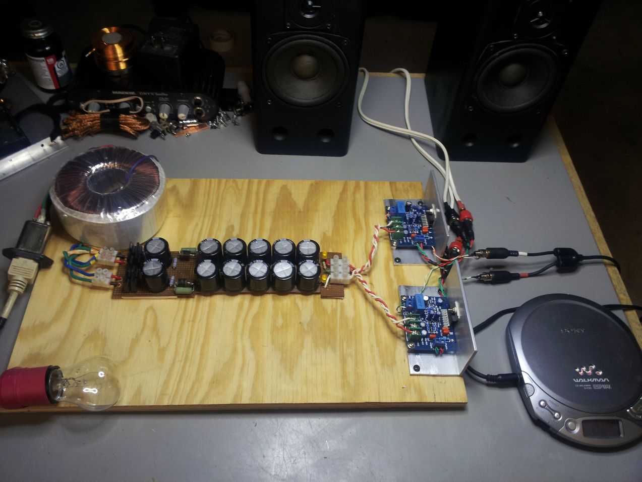

An additional option on that supply is to bypass the pi-filter resistors with MBR1645 schottky. That will maximize the "bass slam" during high volume playback and the crc filter does still work well during lower volume playback.CAN YOU HEAR THAT ????
I almost forgot what all the power supply stuff was about. The amps are playing, the bulb tester is out and everything is at room temps.
We had a problem with that. Some people got real chips and some got fake chips. One person even had a real on the right and a fake on the left. Most of us buying from eBay, got the fake TDA7294 chips.. . .am anxious to get on with the optimized design.. . .
The chips that we bought can be very useful so long as we don't try to use them like a TDA7294.
The solution is at the Radio Shack.
It is the 12+12 2a transformer.
Yes, much lower voltage is the solution.
The fake chips are stable at very low voltage, tolerate low gain, and in that combination, may do fantastic quality. You'll get enough output power for some relaxed level listening or for good use with desktop and full range speakers. The chip's behavior is typical of a die-shrank clone.
It will very likely make a charming system. . . at a great deal smaller scale than you wanted. Probably, the smaller scale end results will go along in direct proportion to the die-shrank. I have no idea if some mystery cloners did this or if ST may have die-shrank their own product? So far, a chip matching TDA7294's datasheet is not available new on the market anywhere (except NOS).
Or, if you want to use a chip with a too small die at too much voltage and too much load, that requires lower current at small signal, such as 110k feedback resistor and its partner at 2k7. Or with your slightly lower voltage (22+22vac transformer), 100k feedback and 2k7 feedback-shunt. That compensation will correct the tonality.
Now, that was worth a mention because if you keep going, lower the voltage and likewise lower the feedback resistor value (for lower gain), then by the time you get down to a 14+14vac transformer, and 68k fb with 2k7fb shunt (we kept the 2k7 for the convenience of having the in- coupling cap smaller than a Winnebago), then the gain is now low enough for rather involving imaging.
But, keep going down to the 12+12vac transformer and see if you can change the feedback resistor down to 56k (with 2k7) and have the amp still stable at that gain setting of 22x. That will need checked a bit. That low gain at such low voltage gives penultimate efficiency and imaging realism performance, which are excellent features, but they will cost most of the output power. Even so, I think that's what it takes to find a use for it.
To get the gain down that low, you may have to flip the board over and stick the 220u caps on the pre-drive power pins directly. At that required low voltage, 25v caps can be used, and they're easier to fit. For a little more bass, you can put 220u caps on all four of the chip's power pins.
It is probably necessary to run the feedback resistor directly across the chip and run the feedback-shunt resistor from in- directly by shortest route to the in- coupler cap (that is also 220u, 25v; however, the gain is so low that a wrong size smaller cap will still work if the in+ coupler is 1uF).
So, that under-board area may get a bit crowded.
The good news is that to fix up a stereo pair, 10 of 220u 25v caps (5 each board) may just get to the volume discount pricing.

Per each TDA7293 amp
4 of 220uF 50v* decoupling (individual power decoupling caps not larger than 220u)
2 of 330uF 16v in- coupler (or a dc tracker)
a 1k multi-turn cermet trimmer for feedback-shunt
25k for feedback resistor (range 25k~27k)
25k//470p for input load (range 22k~25k)
10u and 22k for standby
10k (range 10k~15k) for mute (no cap!)
1u for input cap
33u, per each chip, for bootstrap, using TDA7293-specific hookup (pin6, pin12)
*There are 4 power pins, so there are 4 of 220u power decoupling caps. For layout, you can either situate them as close as possible to their respective pins, or you can gang them up at pins 7 and 8. Either way is fine, so long as the first pair is very very close to the chip, especially at pins 7 and 8.

Daniel--nothing top secret. As I said, I'm scavenging the amplifier section of an old, dead, Logitech z680 system (controller died, so friend got a replacement ages ago) for parts and will be doing this on the "cheap" by reusing as absolutely as much as I can from that (PSU + heat sinks/case + 7293's being the biggies). Hopefully a few op-amps, some caps and resistors (and ultimately pcb's) will be necessary. Famous last words, though.
This will be to drive a 2.1 setup that reuses the subwoofer from said system and some "simple" corner horns driven by full rangers. I'm using an old desktop with a decent sound card (that does 2Vrms) to serve as the media server + DSP.
Ultimately, I'm looking at a composite setup driving parallel chips and DC servo correction. Probably the LM49710 like everyone else and a TL072. (Why mess with success?!) Might try to bias the parallel chips against each other to pull them up (just a hair) and mitigate some of the crossover distortion. Will start with just the basic 7293 with point-to-point, though, and try to figure out how much lead/lag it needs to get the gain down closer to 12-15, then add the servo, then use the 49710 as a unity-gain buffer to drive the parallel chips (think this will be a much better overall solution than using the 7293's intrinsic paralleling, but that remains to be determined), then finally composite.
If things are working well along the way, I might skip some steps. Or, I might stop halfway and call it "good enough." Then again, 3/4 of the fun will be in the engineering, as I doubt a composite design will really help.
More or less porting Tomchr's good work on the 3886 over the the 729X series as much as I can. Short of buying his kit I don't think there's much he's left hidden on layout/bypassing. Props to him on that.
But there's no good model for these chips in SPICE and a LOT of missing data on gain/phase margins to work out how to stabilize these chips and I lack the hardware (at least that I own, will be bugging some of my friends in analog circuits labs to sit on some of their test equipment) to be really digging into these chips, so it's going to be very, very conservative design.
