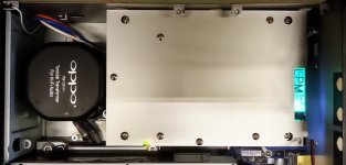

If my previous showed LPM was more like an prototype, here is the first one as product in its last/final version.
The screenshots are take on this final version LPM, with a non-inductive resistive load, and powering the player. On resistive load the ripple (with harmonics) is no more than 3µV loaded for 5A on 5v rail, and 200µV on 15v rail (1A). Measurements points are on LPM side, before the final filtering module/connector.
The production is quite slowly in the beginning, mainly because the transformers, but I do hope it may be better later on. A first batch of 4-5 items it will be available in the next days...

BTW, minimized heat dissipation by customized transformer, sense control stage, dedicated regulator stage with adjustment for fan speed, grounding of the LPM is tied to the main system ground, to prevent ground loops (options for different grounding provided by design), are some of the features...
The back light for label is not only as fancy gimmick, but it have the function of a status indicator for the fan control circuit (this it can be also replaced by a led indicator).
In normal use into the player (no ventilation), the centre of the heat sink goes up to 45dg. C, while the main regulator area it measure 53dg.C

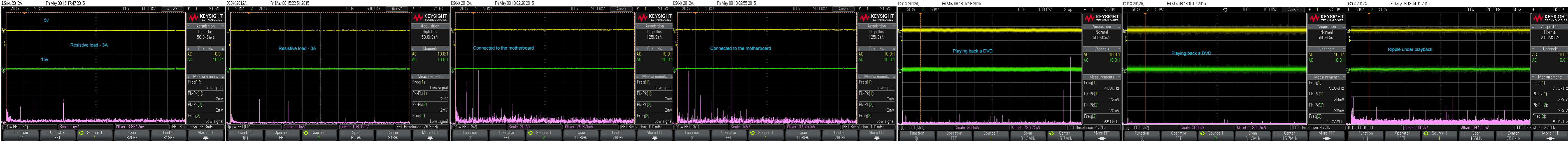

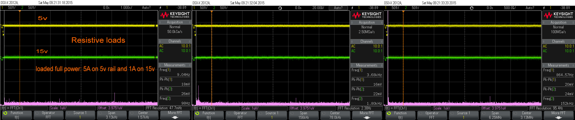

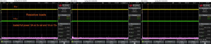

Assembling some LPM boards I got the good idea. Last minute improvement...
I double checked few times to ensure is nothing wrong with my measurements. Couldn`t believe it... Almost a like a battery.
Please take a look at these last measurements.

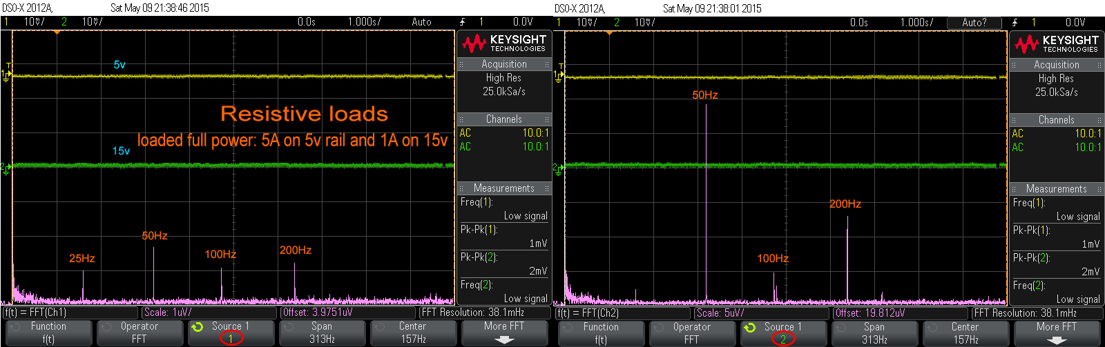

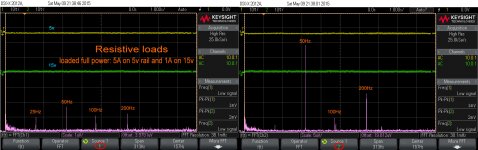

Perhaps a scope with a 10:1 probe and a 1 mV division is not the best instrument to verify the noise performance of a low noise power supply.
Apart from this general comment, I don't understand the conclusion you draw from these pictures. The second set was taken at lower sensitivity (50 mV versus 10mV including probe conversion), and the peak values measured are considerably higher than in the first measurement. So to me it looks like matters are worse here.
Joined 2009
Well, I do not intend to buy another scope to do these measurements... This former Agilent upgraded to 200Mhz bandwidth, and max memory aquisition is good enough to measure/appreciate a PSU noises, so with its 1mV scale division and the 350Mhz/10:1 probe.
Previous measurements was taken on High-resolution mode, 20mV scale with 1µV FFT scale. The second measurements was taken on same High-resolution mode, 10m scale with the same 1µV FFT. The FFT picks should be higher on second case. They are lower...
The normal mode measurements are worse in first/previous measurements, and the second ones shows a much "quiet" FFTs on an enough large spectre. These last measurements correlated with the improvements I have done it make very much sense, and it is exactly how it have to be, as consequence of the last modifications.
This LPM it perform over expectations, and as the test showed to me, the improvements of the powered device`s performances er very obvious.
At least one can test it as one may want and then reviewed it accordingly. I`m not afraid at all about.
And one more thing: one should remember that this LPM is not defined as an (ultra) low noise PSU. It is just a serial/analogue power supply, which perform very well, designated to power a digital board/system. As one can see, this LPM connected to the digital load it worse its noise performances, due to the noises generated and induced by the digital system. This is very normal. Even thought all these, the differences between a digital system powered by the original Oppo SMPS and the same system powered by this LPM are very important.
As the measurements shows very clear, my LPM it perform much better than Oppomod. This is a fact and shows that it successfully hold its goals.

I have registered that some 103 model owners, intend to use this LPM to power the digital only stage in their device.
I would like to observe about some things in such case.
My LPM total height is a little bit under 60mm. With the provided spacers, it have 60mm as standard height. This height it fit quite well the available space in a 103 enclosure (internal 65-67mm height).
There is a question about exhausting the heat dissipated by the LPM. The average power needs of an 103 model should be lower than the average power needed by an 105/105D model. So the heat dissipation it is quite low. However, I would like to suggest here a solution to lower the temperature, when using a serial PSU inside a device designed for a SMPS.
The 103 model do not have the available space and ventilation perforations existent in the later expensive models, so using a fan is not efficient at all.
As the hight of this LPM is very near to the one of the 103 enclosure, it may be a good solution to increase even more the hight of the LPM (using accordingly spacers, easy to buy on Ebay or so), so to have a few mm distance from the upper cover of the player. Then this small space it can be filled with a appropriate thickness thermal pad. I would like to use a 5mm thick thermal pad 100x100mm aplied over the LPM`s heatsink, and having so a good thermal contact with the whole upper cover, when this is mounted in its place.
This approach it ensure a very good cooling and it hold a normal low temperature inside the 103 enclosure. The thermal pads are also very easy to find and are cheap enough.
When I will have the precise spacer dimensions for an 103 model, I may provide these together with the LPM.

The measurements in this connection are made and shown more for comparative purposes, but not for a very detailed, precisely an strictly analytical task, to appreciate the absolute noise floor of a PSU (this LPM).
The approach in itself to design, and use the low as possible PSU, to power a whole digital stage (as the main board in Oppo players, or even a computer) is just a nonsense, and very far from a reasonable and efficient way to do it.
However, and for reasons I could not find yet a good explanation, when powering a digital system using a serial PSU, there are many improvements for the outputted digital signals/streams from that system. In case of Oppo players, there are huge improvements in both picture and sound.
Here are the facts so far in this field:
We have the original Oppo SMPS used in all their models, which exhibit (measured under the same approach(conditions) a very large HF spectre of noise, which it goes up to 200mVpp levels. This SMPS do not dissipate heat.
Alternative to this SMPS (as a serial approach) was/is the Oppomod PSU. This one exhibit a much reduced frequency spectre of noise, and the levels it goes up to few teens mVpp. Huge improvement over the original SMPS.
My LPM it exhibit noise only on the very low frequency spectre (25, 50, 100, 200, and 430Hz) of a level in µV range. This is just exceptional! One have no other choice than only admit this fact...
Well, the FFT pick levels are calculated as RMS, so as Vpp it will be higher than is to be seen in pictures.
The noise floor in FFT it may not be the same as the device noise floor. No matters in these appreciations. Who care about such details? Here is about differences in scales/ranges, from mV to µV... This it matter in fact, not exactly the figures.
