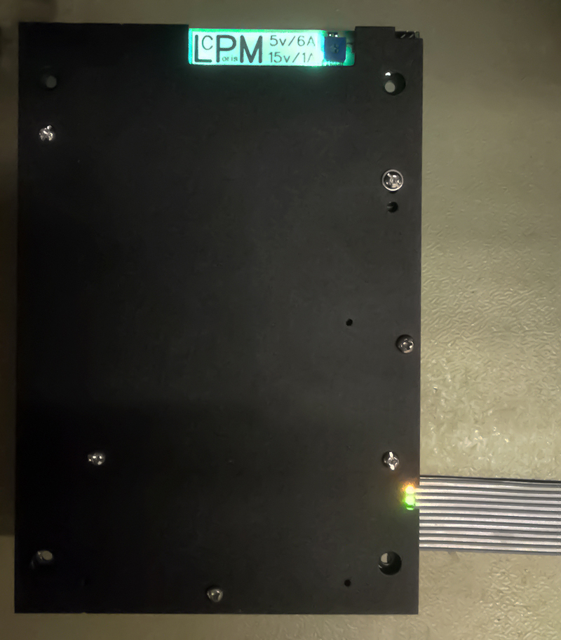

I was a little bit lucky to find/buy a flat cable which it fit to the task...
I will never understand how/why Oppo have found out that it should be used a whole bunch of 9 wires for the 5v hot line and only 4 wires for the ground for both 5v and 15v rails, on their connection cable... They thought that it may pass through more amps on the hot line than on the ground one...
After first testing of my LPM into the player, I found out about some few imperfections, which it were corrected. Also I found a way to lower the noise/ripple level for the highest outputted current.

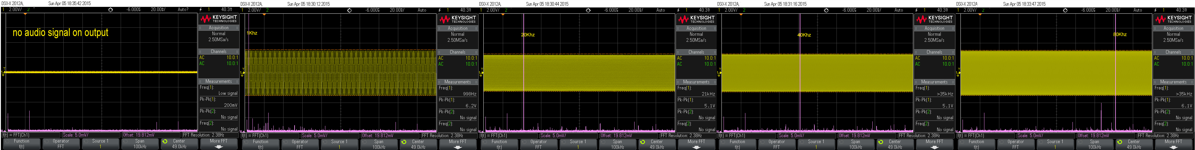

The resulted parameters of the LPM it surprised me enough. I could obtain just few µV ripple/noise for 5A out, on resistive load. Quite remarkable!
I have to mention that the transformer good parameters and quality it have a decisive role for the quality of the PSU.

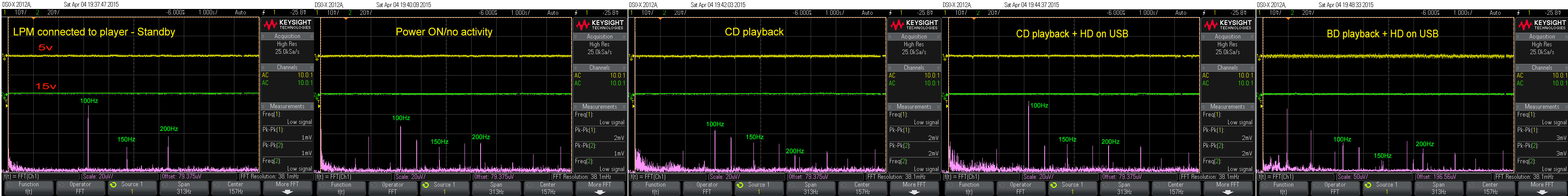

I have repeated the measurements with the last improved LPM, connected to the player. Here are the results.
The temperature is almost the same. Around 42 dg. C in the mid area of the heat sink, for an average activity of the player (video/audio playback included CD). The dissipation increase to 48dg. C, when one HD is connected to the USB. However the ventilation inside the enclosure it do a very effective job.

Well, I may say that I do not have right now very much motivation to go deep in detailed measurements, because the differences in quality (before/after) are more than obvious. The improvements are important for both sound and picture.
I took some plots for the frequencies illustrated here, as i had available these digital files to run it on the player. Please note that these measurements here are taken on an extended improved device. The last improvement was this my LPM. So, the 100Khz spectre for these signals it shows like this.
For plots about SMPS, please see these posts (1026, 1254, 1262) where you may find lot of measurements done on SMPS rails (also with improved filtering), in both cases: with resistive load, as installed into the player.

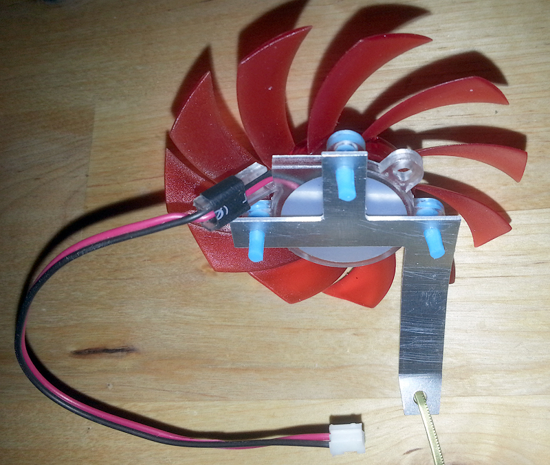

I have presented previously my solution: a fan placed inside the enclosure, not in contact with the exterior, which will only create an airflow in a wanted direction (the fan kit included with my LPM approach/kit).
The air input it will be the stereo board area (already provided perforations up and down), and the airflow output it will be the PSU area (upper left hand side). The stereo board area and the processor it will get so allways cool air from outside, and it will work actually at the room temperature. The airflow it will goes over the LPM heatsink and it will push the heat out through the left cover perforations (also some airflow guidances are needed inside).
When the fan it not have direct contact with the external environment, the transmission of its audible noises, and vibrations is strongly minimised. Even more, the special construction of the fan system (see picture), as the very low power used to spin the fan, it damp/prevent completely any vibration to be transited to the rest of the mechanical system. The fan is completely inaudible from more than 10cm far from enclosure.

Here is an idea for improvements (lowering the audible noise of the 95 fan):
http://www.diyaudio.com/forums/digi...ing-modding-new-oppos-bdp-93-bdp-95-a-20.html
USB port power is quite convenient to be used for a 12v fan...

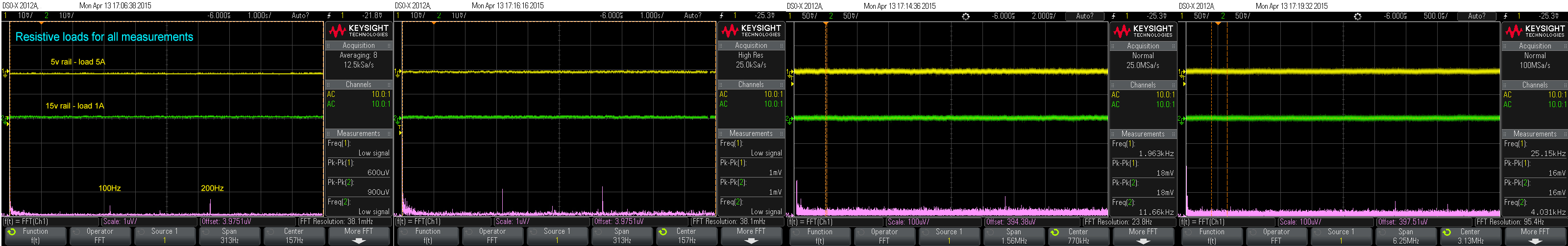

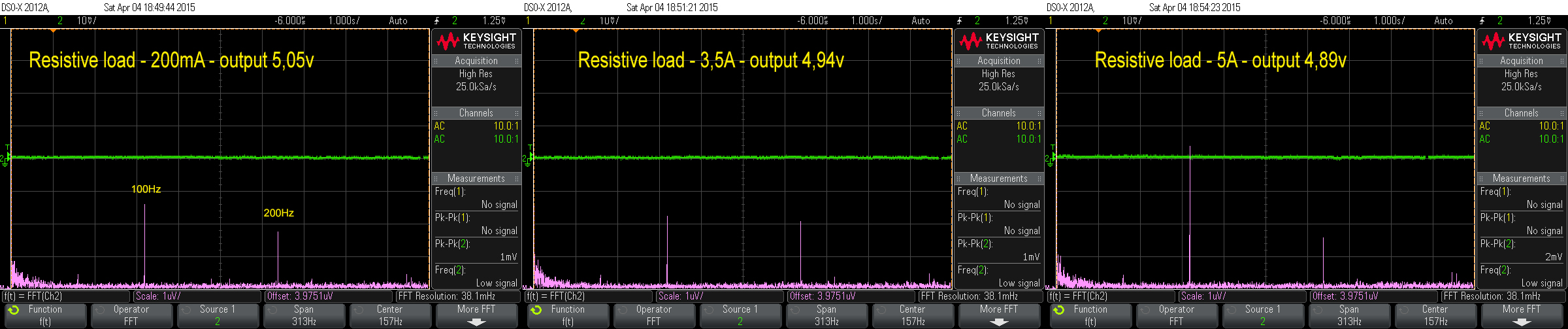

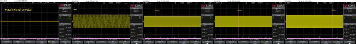

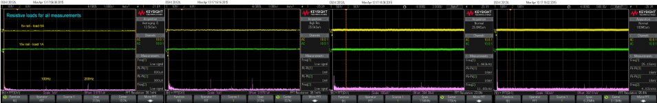

After optimizing the transformer`s parameters, I could obtain these measurements on my LPM.
There are three ways pictured here to measure the noise/ripple.
I chosen the "Averaging" which allowed me to go under 1mVpp on my scope. Also there is a larger spectre FFT which shows the obvious "silence" of this power supply. FFT shows RMS levels.
The temperature (both rails loaded for max current) do not exceed 45dg.C measured very close to the both regulators areas.
I may admit that the performances of this LPM are over my expectations. It measure too good to be used for a digital stage...
