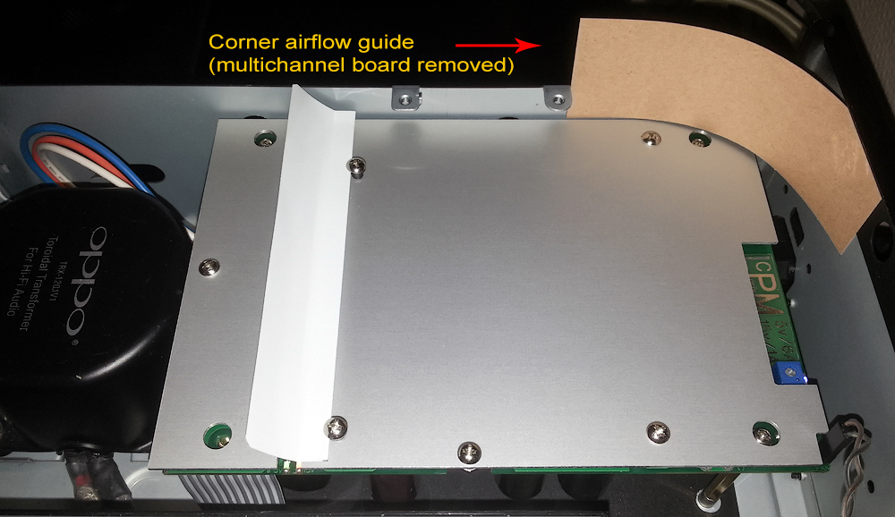

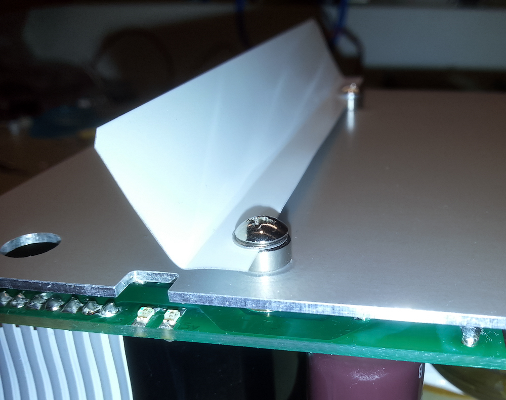

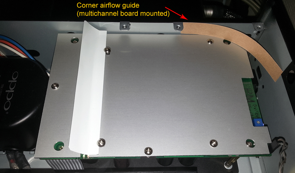

The (last) airflow guides approach, when using this LPM in 105/105D models (with/without multichannel board din place). All the airflow guides and the fan it come together with the LPM as kit.

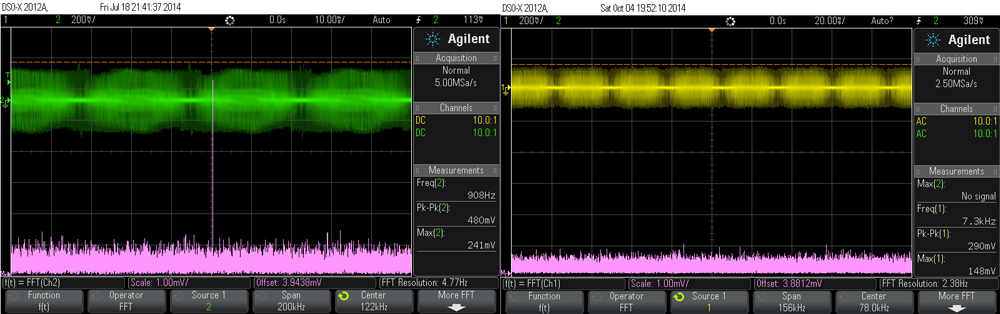

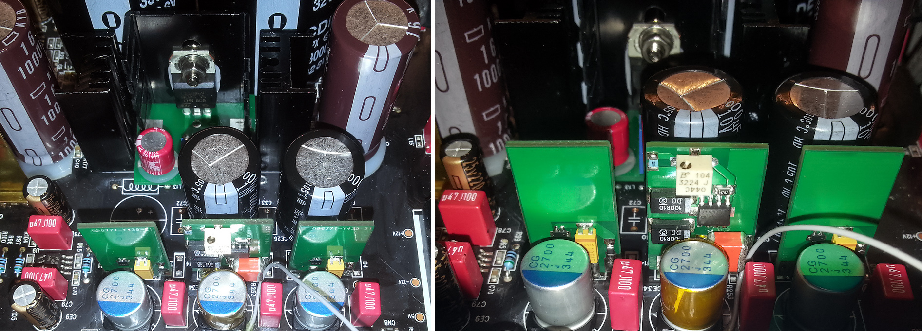

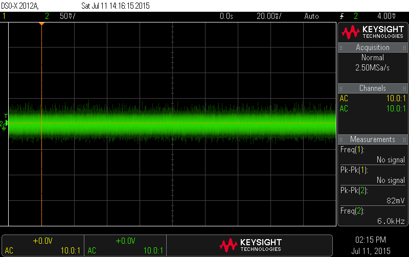

Well, my last new mod is now in place and working.
A pre regulator (5v) instead of the original raw 7,5v power for the DAC regulators inputs (VddL/R, DVCC, as VDD). Then the new regulator modules. AVCC line it have in this version of the mod, the original designed regulator, also strongly improved.
There is well known that ES9018 it likes very much the quiet power on all its rails. The implementing of this modification it confirm for full this well known fact, and it prove in the same time the mid quality of the Oppo original design (well, justified by large production reduced costs).
With these regulators system in place, the sound become at once very smooth, and especially pleasant to listen it. Everything is more natural, extremely detailed, with extended volume and resolution of the sound sources into the soundscene. Very nice!

Do you have a picture or schematic showing which regulators are used for the dac?
Are they easily reached, or does a lot has to be disassembled to be able to replace the regulators?
I changed to newclassd regulators in a dacmagic some years ago, the sound difference was very like you described here.
These regulators are place it where are now my modules installed (in above picture). Their datasheets are to be found by Google search.
To remove it is necessary to take out the big caps around. Else these caps it may not look quite well after such operation...
The final result(s) is (are) in conjunction with enough many other factors. In some cases it may be noticed at once, in other cases not exactly the same... However, the main idea here is to be replace it.
I may underline that only this modification as stand alone it may not lead to dramatic improvements. One or many modifications it may be appreciated into an approach for the whole system.
And there is also another aspect concerning this mod. I may not see good results by only replacing these regulators with some other similar. At least I can not imagine how to solder in place a LDLN015, or a ADM7151 chip or so, on the original footprints of these regulators. Well, it may work in a way, but not very sure that the results it may be as expected....

I got always such scope snapshots (pic1) on outputs, using unfiltered post DAC analogue processing, and I always wondered why one get such modulated HF signals/noises of such high levels. I was still getting the same HF noise patterns, even while using my DAC large capacities PSU, but only lower levels.
I was even thinking that this kind of noises are something particular to the ES9018 chip and its way of functioning. WRONG, WRONG!
Only in the very last time I found out what about these anomalies...
This high level HF (modulated) noises it come just from a stupid/cheap design, and low quality components used by Oppo to power the VDD, DVCC, and VddL/R rails of the DAC chip.
Please take a look at the Pic2 here. This is what I get on the device`s outputs (using the same non filtering analogue processing circuits), after replacing these standard regulators, and introducing a supplemental one to regulate the raw 7,5v rail.
This is the original Oppo`s approach in this area: Toroid transformer, rectifying bridge and filtering cap (3300µ) to get the 7,5vDC line. Then these 7,5v are fit it directly into the 3,3v and 1,2v regulators. 1000µ caps for filtering before and after these regulators, as some local 220µ decoupling caps.
Even more, the 3,3v regulator for DVCC is an adjustable device. The designers maybe thought to lower the production costs, and did not provided this adjustable regulator with the right resistor divider to establish on its output 3,3v (it deliver actually 3,2v), and the necessary capacitor on its adjustable pin, to improve its noise parameters. This cap on the adjustable regulator device`s pin is a basic design rule to improve the regulator`s noise figures... Well, not used here...
Then the player`s designers used strong HF filtering on post DAC analogue processing, to eliminate the HF noises, modulated by a high level 50Hz component, induced into the DAC chip, through its power rails... As known, HF filtering and strong HF filtering it have negative impact for sound quality. There is also known well enough that the original design of these players it not support a very high level for the sound quality out of these devices, even thought it is using the most advanced DAC chip.
The powering system for DAC chip, it is a very important area in this device design, and this area is wrong done it. I will recommend to all who can do it, to remove/replace these regulators with quality ones.
But this it may not be quite enough, as the whole area should be improved by a better approach.
The impact of this improved DAC`s powering system is quite dramatic for the sound quality, even though all of the another improvements it may be already in place.
