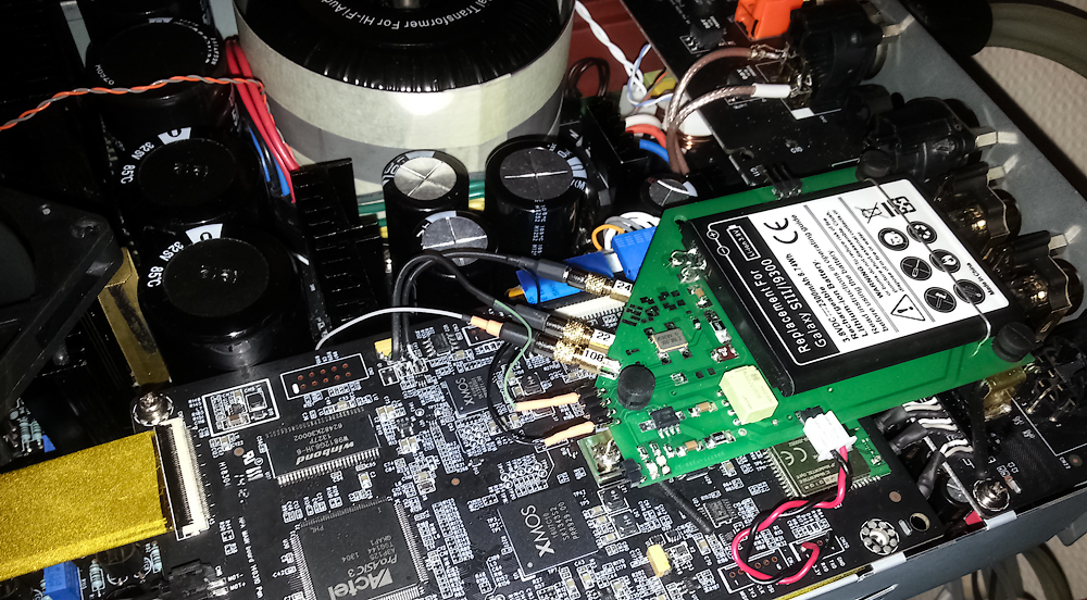

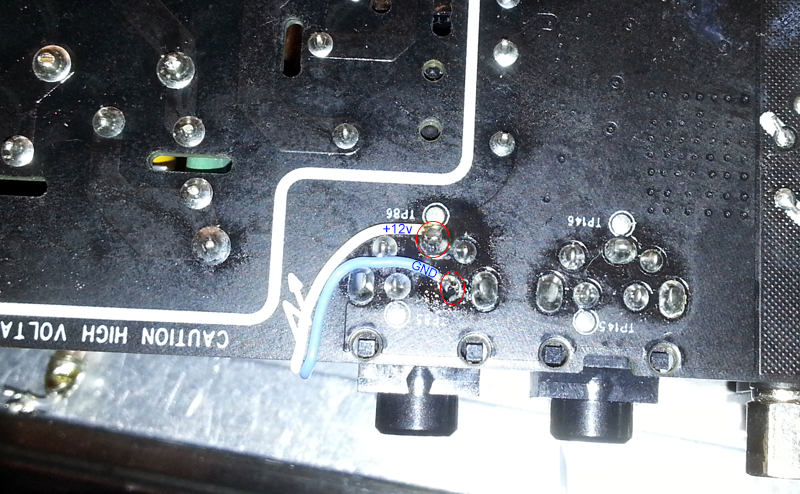

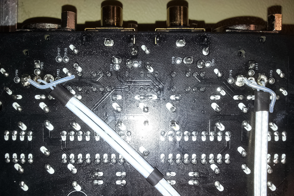

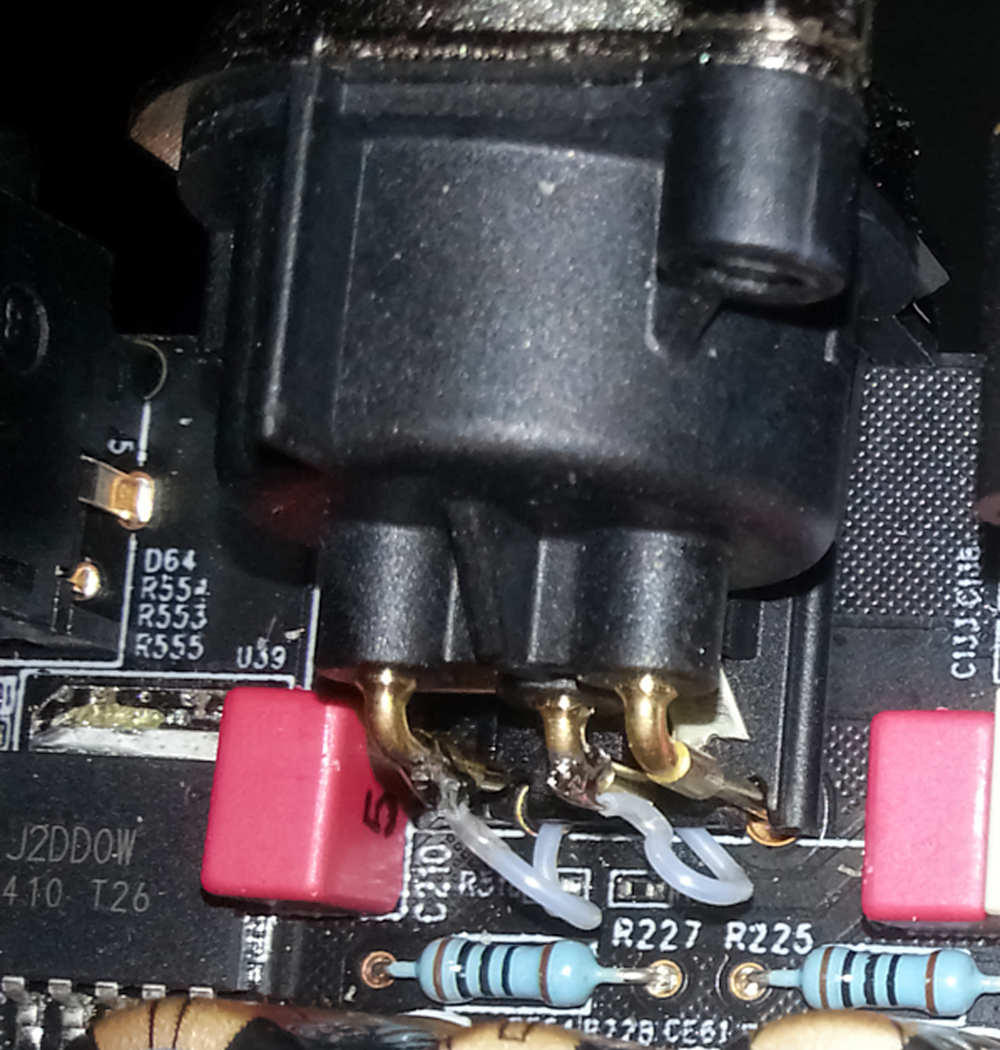

Inspired by Andeas idea about outputting the balanced headphone out to the back panel connectors, I just proceeded to apply this mod.
The concept here is to use the balanced input XLR connectors as outputs ones for the balanced headphone lines.
So, a wire connection have to be made from the front side of the board, to the rear panel. These wires should be shielded, as it runs under the whole PCB. I used silver wires shielded by sliver coated copper bride.
There is still open a question or an unsolved problem about the GND of this "construction"...
There is a big advantage to let the GND connection of the balanced input connectors in place, as for mechanical reasons. In the same time there may be right to take the GND of the headphone balanced output connections from the original designed place (front side of the PCB). Of course the whole GND is common on the whole board, but... This subject it still be open to discussions.
Well, my way to apply this mod were to cut the pins of the balanced input connectors, going into the board, and keep the GND connection in place. Further, the idea is to use the existing holes for these pins, to get through with the wires coming from the front side (headphone balanced out). I do hope it is better understandable this concept by looking at the pictures here.
So, I have cut it the pins, and then unsolder it and extract the cut it part from the board holes. Cleaned up the holes, and got through it with my wires.
The cutting of the pins have to be done "sequential". I mean it have to be cut it the external pin of the balanced input connector, to get then enough place which will permit to cut the second pin.
It is of course no problem to connect the GND of the headphones balanced out, through the shielding brides to the modified balanced input connector on back panel (and isolate it from the input GND area). But in this case the mechanical contact of these connectors with the board it will be weaker.
I think to test this configuration before going further with the right connections. As a line out it may work well as it is done... But my main problem is that I do not have yet a balanced amp... So, the testing it will may wait a while... In between maybe it will be clarified the GND problem in this mod...
Also I`m waiting for opinions/suggestions about this detail.

Re ground connection for balanced XLR output:
Usually the ground connection should be connected to the chassis at the entry point.
See for example http://www.rane.com/note110.html

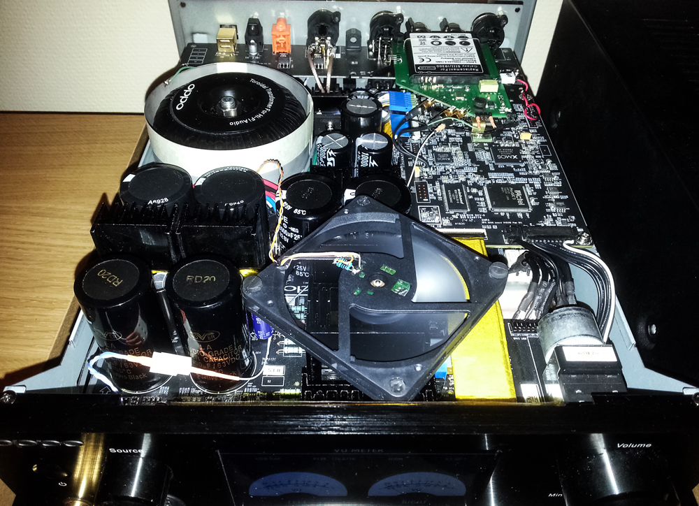

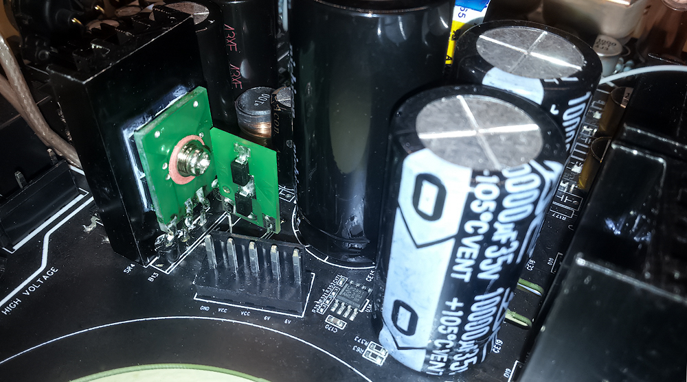

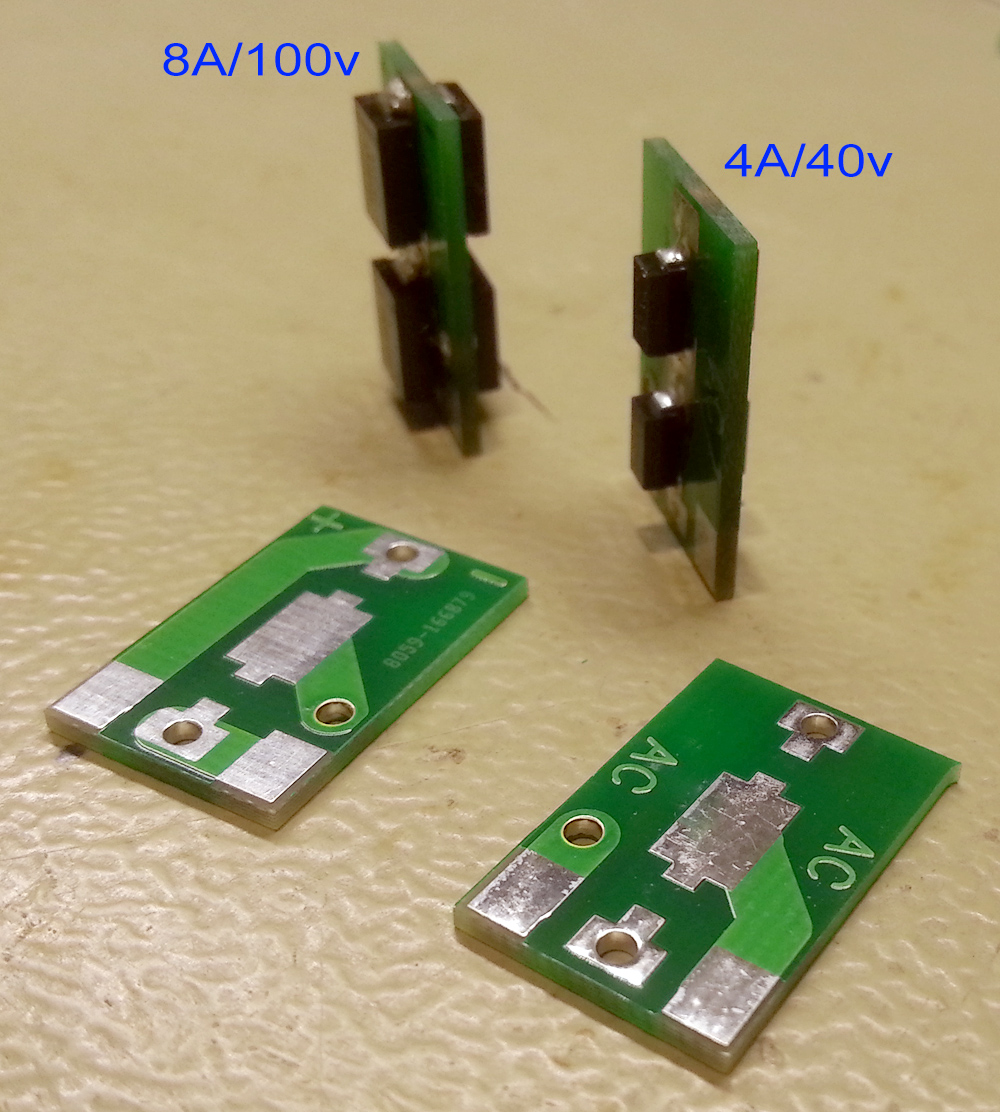

I think to come with some more considerations/observations about the power system in HA-1.
I succeed to replace the most of the filtering caps in the device. Already the improvements are very noticeable, as I mentioned previously. The most remarkable is the resolution increasing in the lowest end of the spectre (as normal also...). The very fine details in the bass range are just exceptional. One get the volume and space in the low frequencies. The persecutions instruments are just rich in very fine details, I could never before noticed. Barely audible low frequencies are fully perceived as air vibrations, and it give a very special dimension to the reproduced sound. Just impressive!
The increasing in dynamics is also to be very well noticed.
Well, one may know that my device it have already some other improvements, so, the effect of the this improved filtering it may be more obvious. I do not know how it may be perceived this improvement (better filtering) in a standard device. I do hope some more people it will try this mod (also not a very easy one).

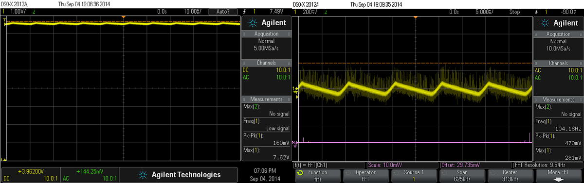

Today I have done some more detailed research about the power system, and I measured quite much.
I think to present here an example about the power of the DAC stage. Also a very important stage in this device. I have to say first that unfortunately, I ignored to do some measurements on the unmodified device. I did the measurements on this stage after I have replaced the original filtering cap (3300µ), with a 22000µ one.
The ripple pictured here is with this large capacity installed. The AC line measure 7v, while the DC one (after the rectifier bridge), measure 7,4vDC... This is for sure not right! It indicate a under dimensioned transformer, for the needed current. The result is a quite high ripple, as ripple currents. But why they have to use 7v to generate/regulate it down to 3,3v and lower? It is a very strange approach for a high end audio device design. You can only imagine how the ripple may look like in a standard device with that filtering cap of 3300µ...
There is well known that ES9018 is very sensible at the power quality used to drive it. You can also notice the high frequency noises which still exist over the ripple of this raw 7v for the DAC system...
I have measured also an 20v DC on the power line for the digital board. This 20v it feed a SMPS on board, which deliver 5v DC, used in the most of this board circuits. As it is or regulate it down to 3,3v or lower. Why they have to use 20v to get this 5v DC is enough difficult to understand. It looks like Oppo could not find the right transformer on market or they could not produce a right one with the right AC power lines...
As I have mentioned, the temperature get lower on my device, after changing these caps. The old caps got quite hot, and I though that was because the heat radiations from very close heat sinks. It is very possible that the filtering caps got hot itself, because the very high ripple currents in a wrong dimensioned power system. I can measure now on Class A amp heat sinks 46 dg., on the Class A regulator 42dg, and on the whole enclosure 37dg. The fan inside the enclosure is running, as described previously, and the back panel is placed at approx 3mm distance from the enclosure. I had running the fan before changing the caps, and the overall temperature of the whole device were higher than now...

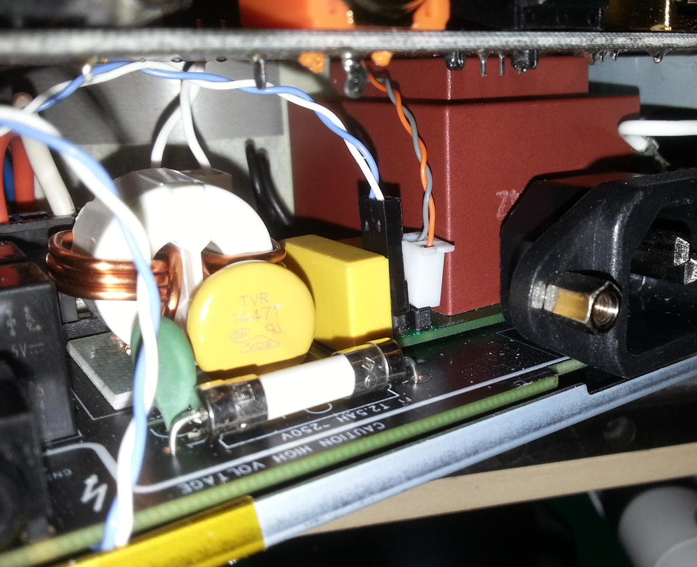

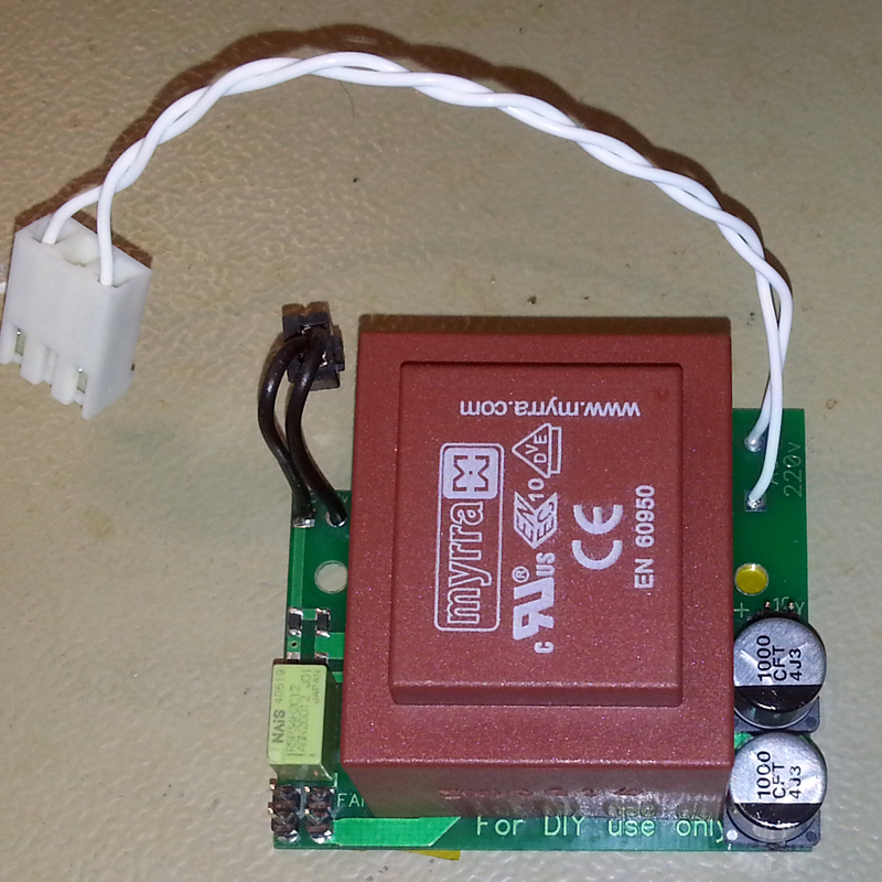

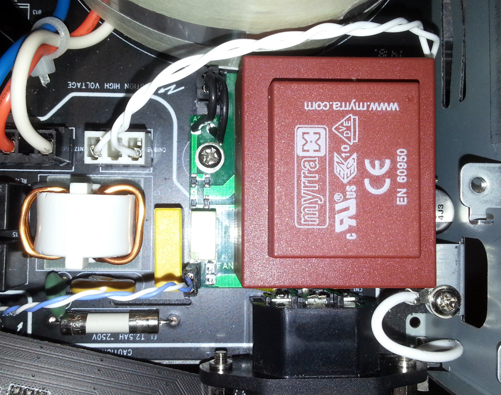

The fan inside the HA-1 enclosure it get now a more properly modification.
The concept here is to use a right transformer to power the fan, while leaving the remote output free to be used as it was designed.
The adaptor module can be seen here. A signal connection from the Remote Out it will activate the small relay for fan power. The transformer it will provide also power to the the battery charger of my (soon coming) mod: battery powered clock board. This board it will provide clock signals for DAC, and the asynchronous USB (re-clocking) circuit.

Another important mod for HA-1 is up and running: the battery powered clock board.
The purity of the sound and the precision of sound elements in soundstage are quit impressive. The difference between low noise regulator powered oscillator and battery powered is one more time confirmed for this device too. It sounds different and much better. BTW, 108Mhz SAW oscillator for DAC, and NDK oscillators for asynchronous USB stage.
So far, the mounting of this clock board it may come to end an extended series of modifications for this newest Oppo device. Well, I forgot the changing of the rectifier bridges with Schottky ones. This mod is not done yet, as I`m waiting for the production of designed PCBs adapters...

On the HA-1 front panel PCB, just beside of the blue LED, which signalize the power on state of the device, there is a second LED footprint, which is not used/populated.
The DAC chip it have two digital output pins: Automute, and Lock. These pins are not used in HA-1.
One can connect a LED (through a 1k resistor) to GND to get informations from either Lock, or Automute. Automute it may not be a very interesting info, but to know when are lock issues in a file, it may be a usefully information (for someone)...
Further, the LED from Lock pin can be soldered on the unpopulated place for the second LED on front panel, to be well visible. Using the second dimmer level, and 1k resistor for a SMD LED, its light it can predominate over the blue one. Well, one can adjust how one want the light power of this additional LED to visualize the Lock signal from DAC chip (into 8mA).
As the distance from DAC placement and the front panel is enough big, one can use a tin coax cable to transport the signal (the shielding should be connected to GND only on one end). I will recommend exclusive use of Teflon isolated wires for connections inside this hot device.
I may come with more details if somebody will be interested in this...

There is available now a Schottky bridge module for replacing the original rectifier bridges in the HA-1. A special designed bridge module, adapted to be mounted on the heatsink in the device (20vDC rail) is already produced and it will be available soon .
The modules it may be available as bare board or fully equipped with two types Schottky diodes, which it fit different power areas in HA-1.
