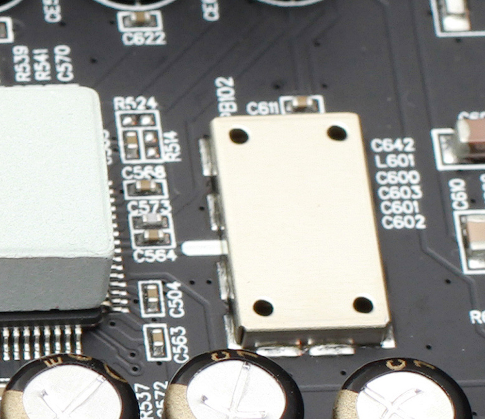

There is a shield for an unknown (yet) clock circuit inside....
Yep, I can see the folded metal on the corners. Wonder how easy it is to take off?

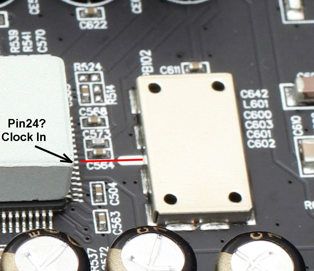

Take a look at the revised photo below. I think that track we can see with the fat white stripe, goes into Pin 24 and is the clock input pin? If that is right, then if there is no problem disabling the old clock, then that track can be cut to access the XIn. But would be best to disable that clock. But that could be done by cutting the track the supplies the power. So the shield may not have to be removed?
Also, wonder what frequency they are using, still the old 54MHz or have they gone up to the max 100MHz according to spec sheet? Then they should have used a SAW clock there. Maybe they did and there is a SAW oscillator under that shield?

As that shield is not so big, a little bit more powerful soldering iron on it it will do the job quite well... I may not use a hot gun, as it could warm up (for too long) a too big surface around that place.
Indeed, the clock trace is that one you have also seen it already. There are few ways to inject a new clock signal on that pin, without removing the shield. However, I will remove it (at least the first one) to take a closer look at what it may be there.
So, if you are patient, you can wait for this event, which it may happen quite soon...;)

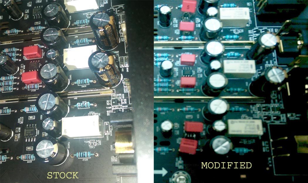

In stock form, the RCA dedicated sounds much better to me than the XLR. To improve on the XLR performance, I have removed the SMD cap parallelling the 1632 Op-Amp and replaced it with WIMA. Also, have bypass most of the big electrolytic with WIMA on the bottom side. Big improvement with the XLR a tiny tad better than the RCA now. Please let me know if you guys see anything I can improve on. Thank you!

You did right with the bypass caps. I do not know yet the value of the caps used on 1632 opamps, but I would like to use some SMD film (if applicable) or some smaller as dimensions caps there.
I can see another design improvement Oppo have adopted on this latest model: the use of OPA1632, which is an approach for the post DAC signal processing, we are talking about in these dedicated threads, for long time ago also....
The increasing of the filtering caps capacities (power rails), will have a beneficial result for audio signal quality. As I can see in your picture, Oppo have planted some 3300µ caps for (supposing) DAC power rails, and rated for 50v. This is just stupid in my opinion! In that place the voltage does not exceed 10v. Why using 50v rated caps? For the same physical dimensions and for at least 16v rated caps, the capacities of these caps could be increased a lot.... And large capacities for filtering caps after rectifiers is a very simple way to improve the overall signal quality...

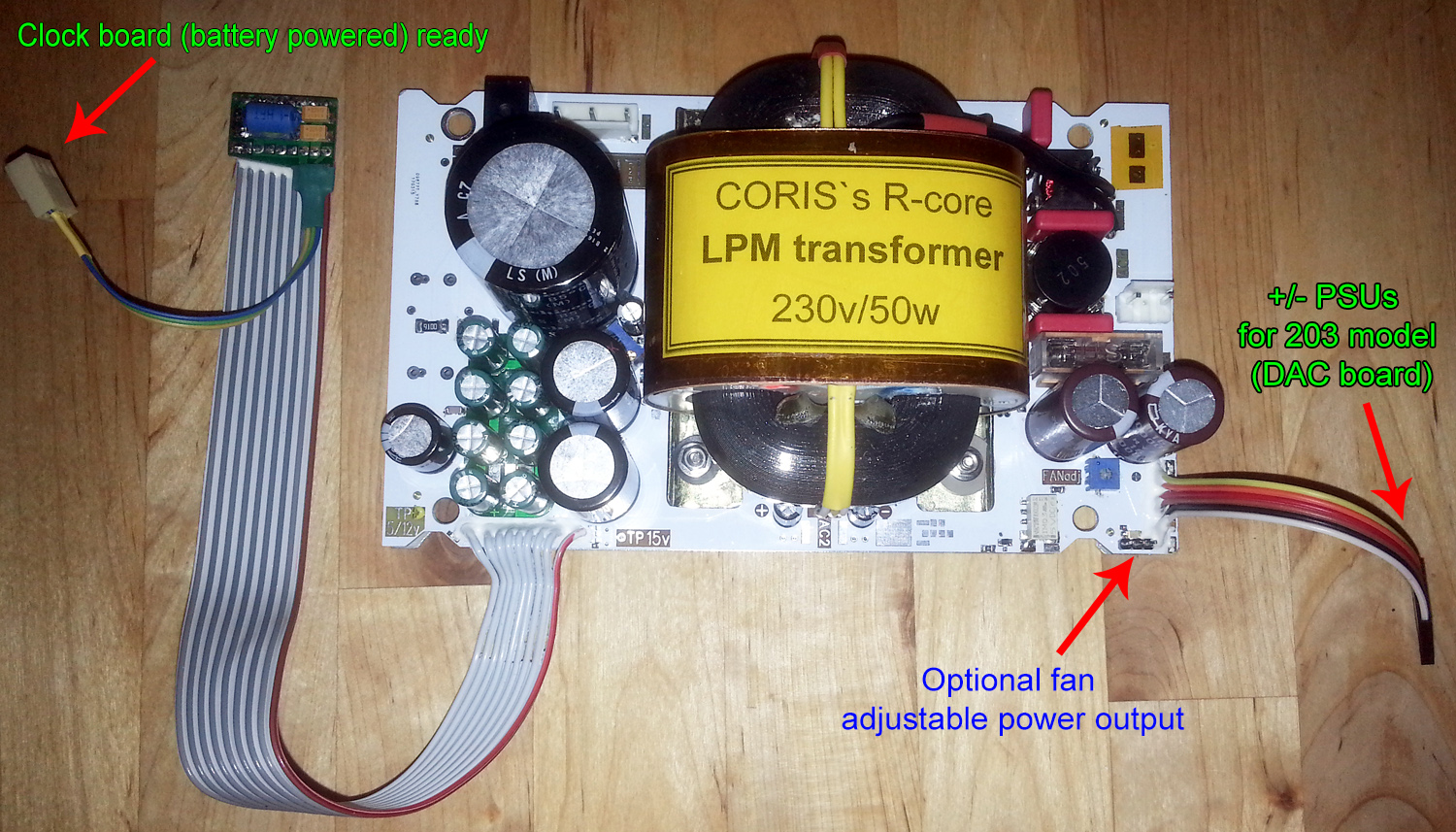

My linear PSU for 205 (LPM) is already finished (before the 205 model was issued on market). The version for 203, is installed already on many 203 devices...
Here is the version which it fit for both devices (for testing purposes, but usually the +/- section is not necessary for 205). However, the board is designed to fit for both new models, and even fitting for 103/105/105D ones, accordingly populated.
It is only a paradox that I had no yet the time to mount it in my own 205...

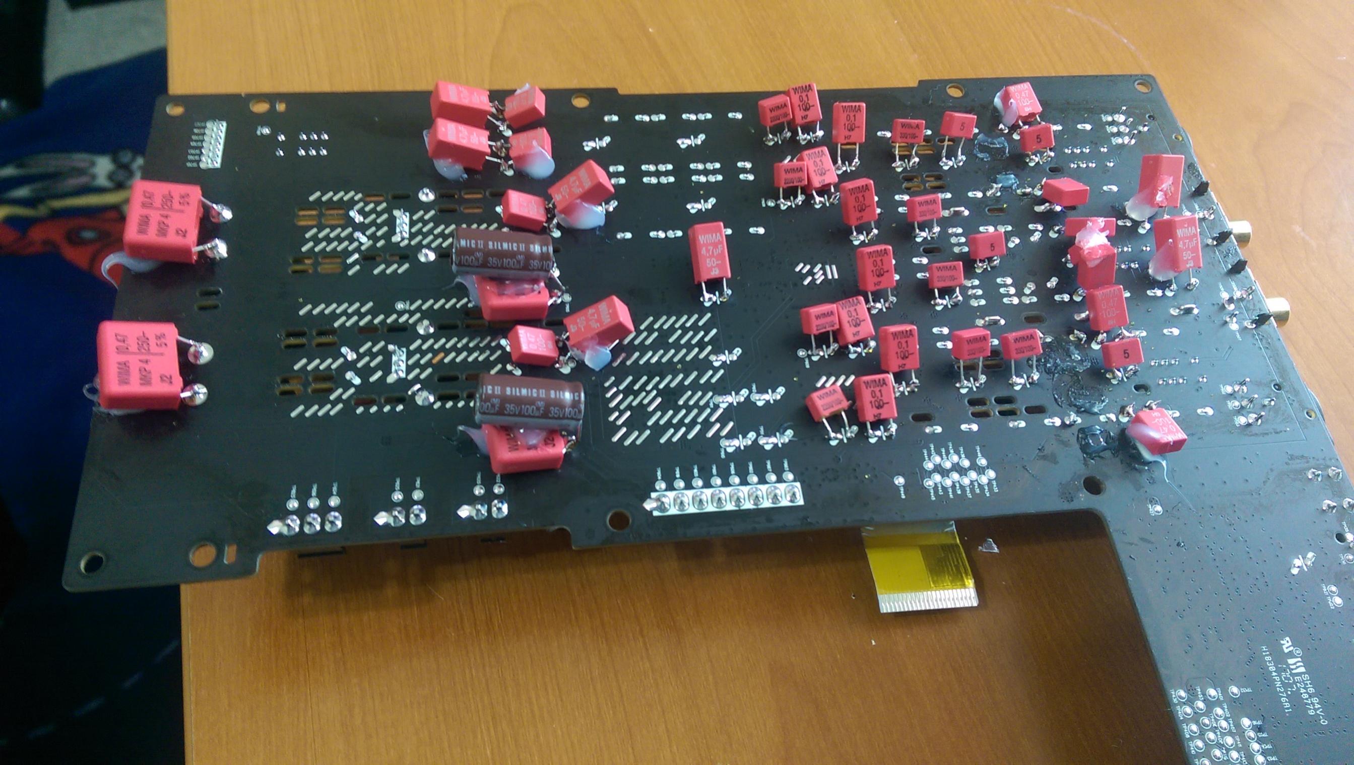

I have added a little more WIMAs to the board and they have really opened up the unit some more. The RCA is now my preference again. It just sounds more natural. Reverb, decay, attack, and vocal resonance seems to be just right, but I am hearing all this through a modded Parasound P7, which is not a true balanced pre-amp. Also, hooking both RCA (in) and XLR (in) at the same time on the P7 changes the sound, best to disconnect one or the other when testing.
I will test the 205 XLR direct to a pair of Nord NC500 soon to see how it compares.

The output voltage of the linear PSU is 12v (standard voltage for new series - 203/205).
One of particularities for my LPM is the huge filtering capacity, in this case 0,4F. Also remote sensing current is used in regulation circuit, to ensure the best regulation and lowest ripple at the end connection point. A supplementary HF filtering cell is added at the end connection point. Also double AC main filtering cells are included: one for the main R core transformer, and one filtering cell for the toroid transformer (analogue board). The R core transformer is double shielded (one separation shield in between primary/secondary, as an external one), everything grounded.
An optional adjustable PSU for an inaudible cooling fan is also included. The LPM it dissipate through the chassis bottom, through large area thermal pad. A forced ventilation may not be necessary for the 203 model, but for 205 model it still be good to have it....
The LPM it can be customised for US or European AC network standard, as well.
