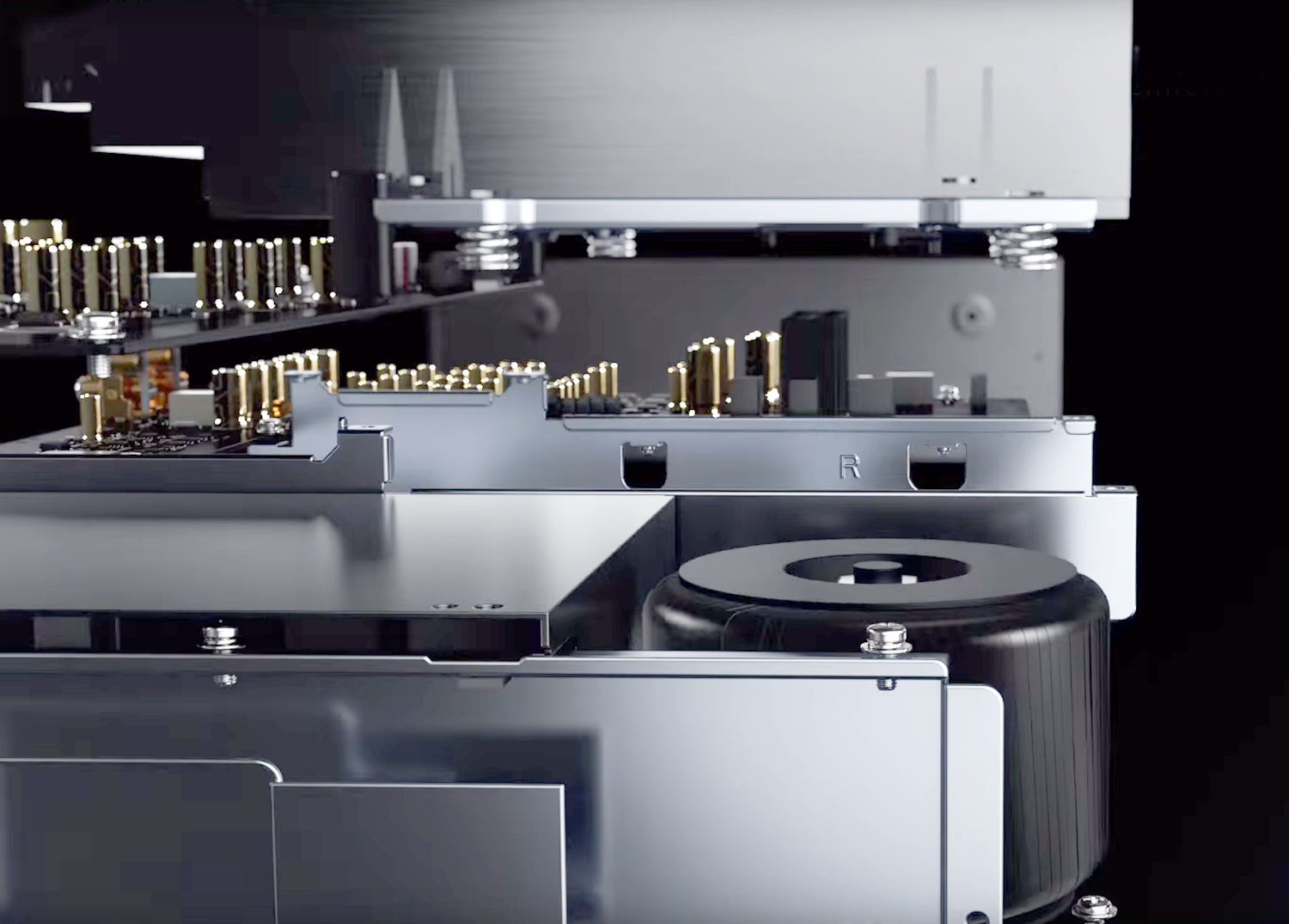

Some of my considerations, looking at the internal picture of UDP 205...
Most likely for this model it will work to connect together the stereo DAC output channels, using the headphone channels too, if this stage it will not be used. It seems Oppo was listening to the critics of wasting two of DAC channels for headphone outputs.
The headphone out in 205 it have its own mute relay, so the switching amp - headphone is made in other way than using the DAC mute function, and hopefully the digital volume control it may be common. I`m very optimistic about this modification potential.
Another observation is that this model it have three analogue power rails, and it looks to me that two of these rails it may be used to power the DAC chips, for their digital and analogue stages. If so, then it is a progress even over Sonica DAC, which it used the old Oppo analogue power design approach.
I can see two 1117 regulators of a new generation (maybe), and I assume these are used for digital stage of the DACs, while the ADM7151 are used most likely for the DACs analogue stage (also as in Sonica DAC design). It looks to me that Oppo still power the clock from DAC`s AVCC rail.
A more sophisticated headphone stage output, based on the same TPA6120A chip (which is a very good amp, BTW), followed by most likely an complementary transistors stage, This it can provide both very good quality, as a lot of power for driving very well the lowest impedance headphones. I think I will prefer this output as line out, rather than the standard RCA out...
Even it may looks like not so important, I appreciate the way the mute relays are more convenient and logical positioned in this new model, to shorten the signal paths and maybe for a better shielding, or better noise figures. However, the same AC coupling approach, using bipolar caps insted of the right ones...
I see the toroid is not shielded as in previous models, for sure to lower the production costs (quite sophisticated mechanical mounting for the previous models, which indeed it not offered any practical advantage, but only unnecessary loaded the production costs). As this toroid is less powerful than the previous ones, and well placed, it may not necessary need an magnetic shield, but I still think it should be damping mounted on chassis, especially for this 205, when is no more encapsulated.
I still appreciate as insufficient the filtering capacities for analogue power rails.
As before much improving potential for this model too, even thought it may be less modifications, for a even more quality increasing, comparing with the previous devices...

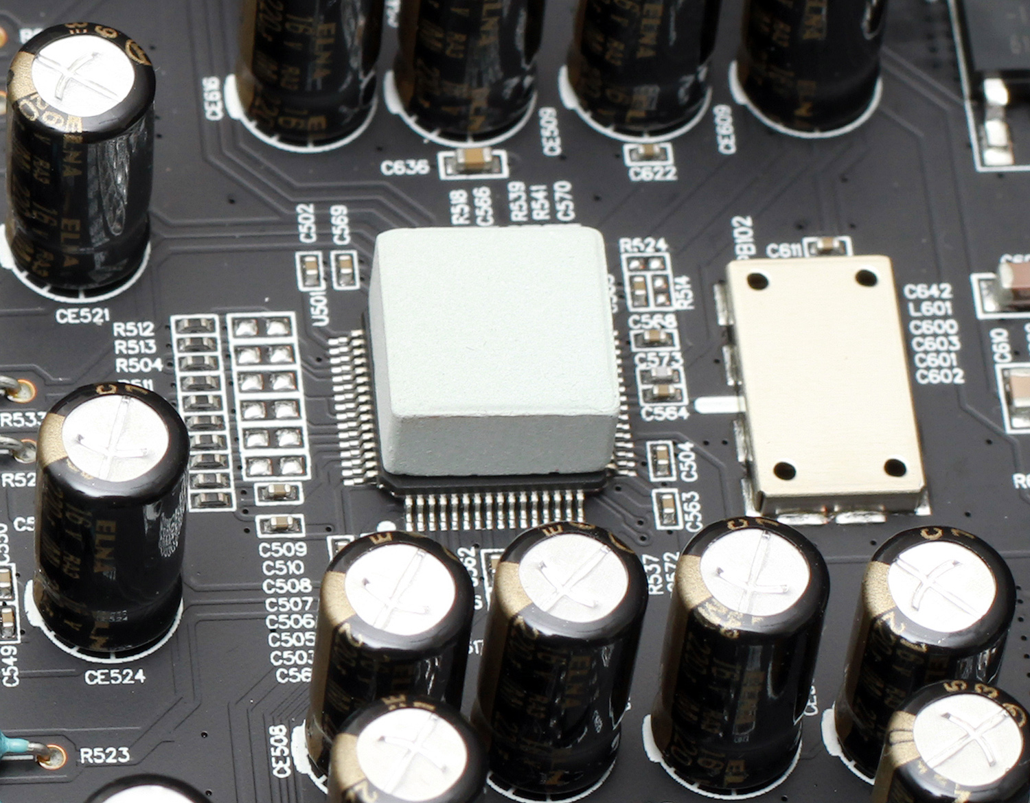

Ceramic chip on top of ESS9038 chip is acting as heat sink. The 9038 runs really hot so a big piece of ceramic (mounted with heat sink compound....yes, you can remove the "hat") helps keep it cool.
The 9038 is four 9028s in parallel. It runs 4 times as much current and has four times less output impedance (200 ohms per DAC pin).....or 50 ohms with all four in parallel.

Indeed this is the only logical explanation of that hat, acting as a heatsink. But why ceramic and not aluminium? Much better and efficient is the usual aluminium heatsink, with a much bigger air contact area... However, a ceramic brick it is cheaper than a such aluminium heatsink, or maybe there is about a kind of aluminium compound there, which it may look like ceramic... Well, we shall see soon. I fully agree that cooling the DAC chip is a good thing. I have applied already an improved cooling to the ESS9018 in my mods.

I think I have a possible answer about why ceramic and not aluminium heatsink... If this heatsink it may disclose from the chip for some reasons, then it will not produce catastrophic damages (shorting) inside... For sure, a safety mounting of a usual heatsink over the DAC chip, is much more costly for production line, than only gluing there a ceramic brick...
Well, the specialists says a ceramic made heatsink it may be more efficient than a metal made one...
So, there is no mystery longer in this area... However, I would like a better approach in place when about cooling the DAC chip. That brick is enough far from a proper efficiency...

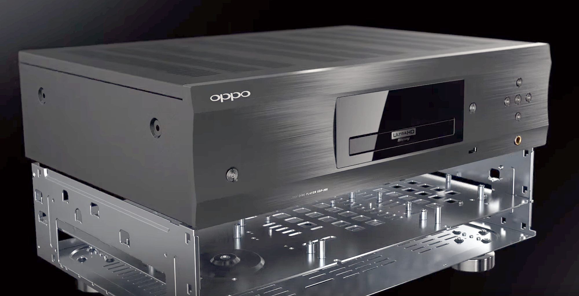

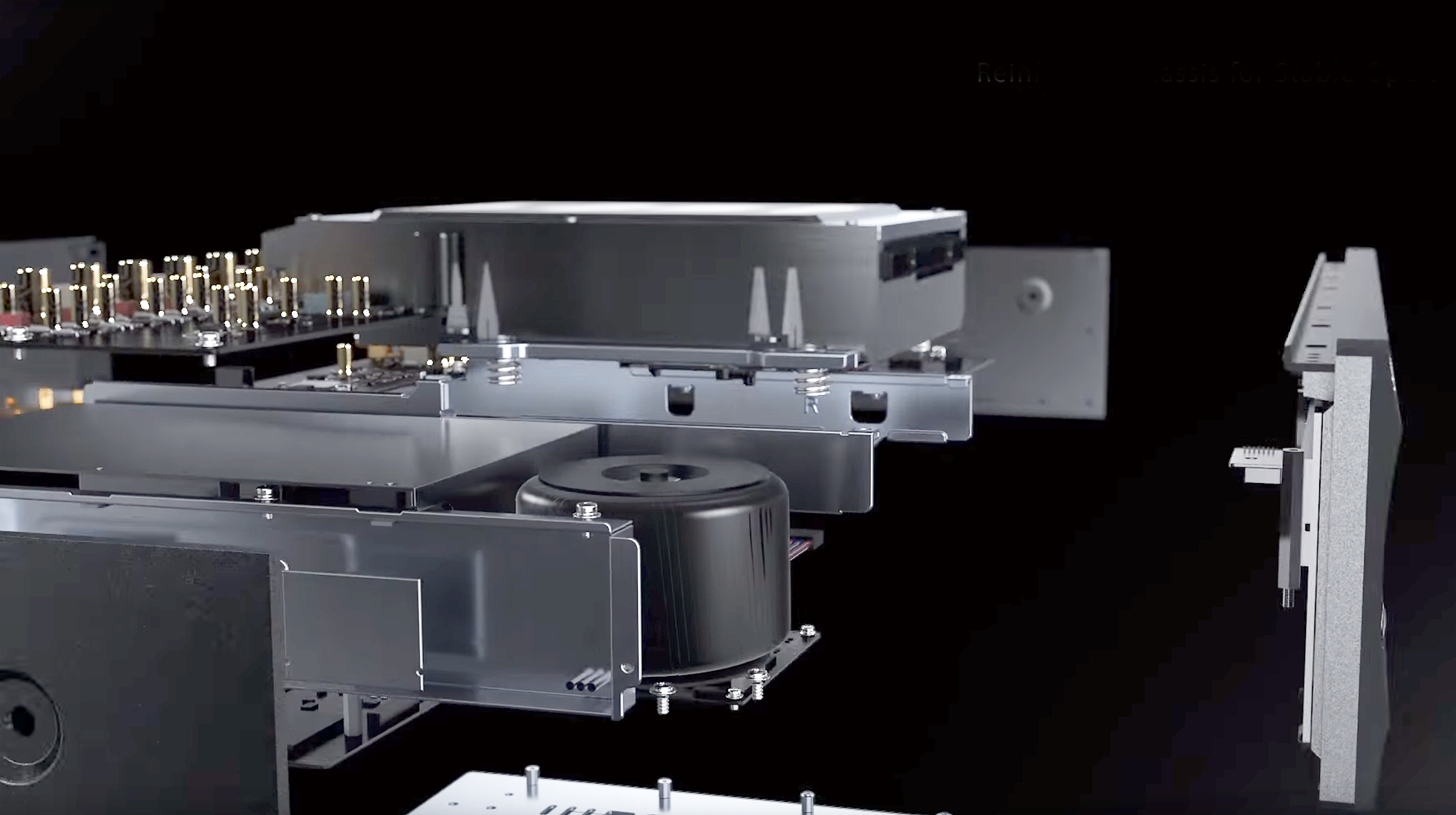

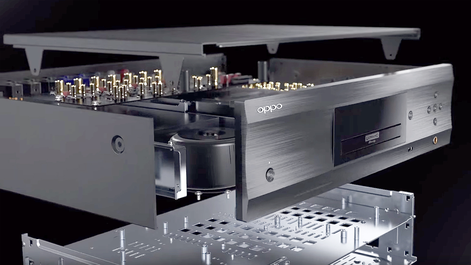

Some more details about the inside of 205 model...
Again the misleading image of the springs under the disc drive, suggesting a elastic suspension. In fact (for this model too) a very rigid drive mounting into the chassis....
