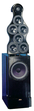

One last temptation from me: Alón Phalanx
Alón Phalanx/Poseidon Loudspeaker System (Ultimate Audio)
The appealing part of Basszilla is the open baffle, and what needed fixing was the ported woofer, so I kept showing you sealed-bass Orion-like layouts!
Granted I only have listened to the basszilla a couple of times, but I would say it was the entire speaker that sucked not just the ported woofer.
