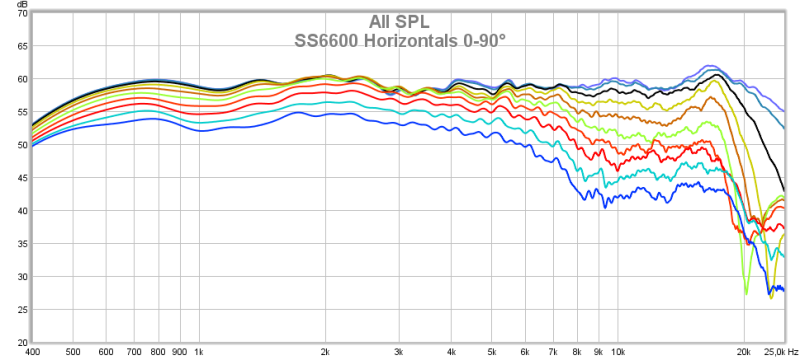

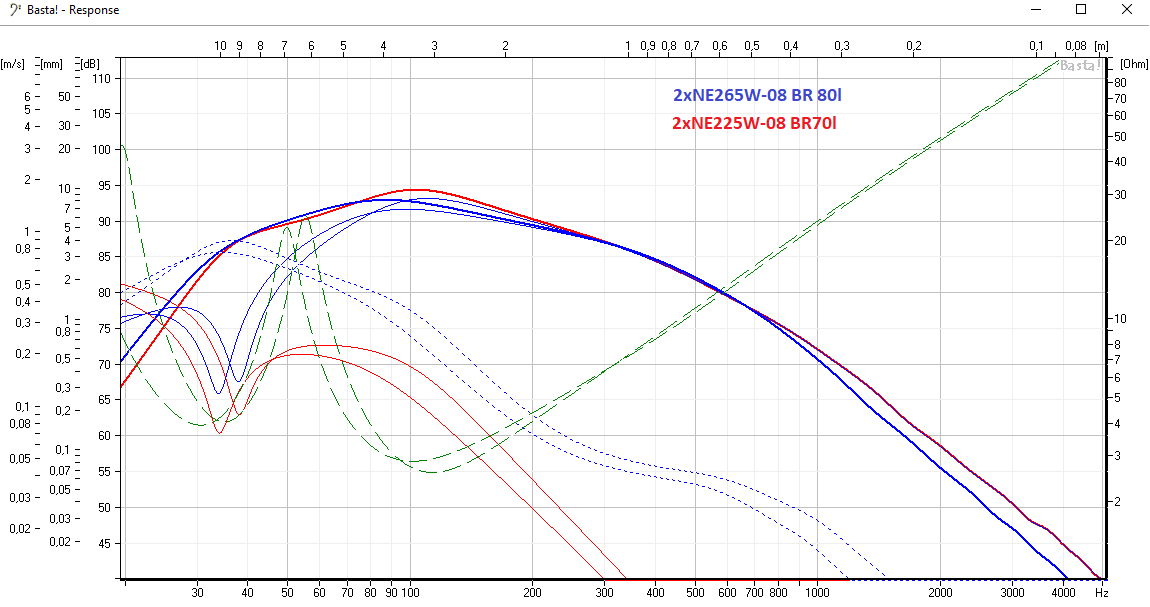

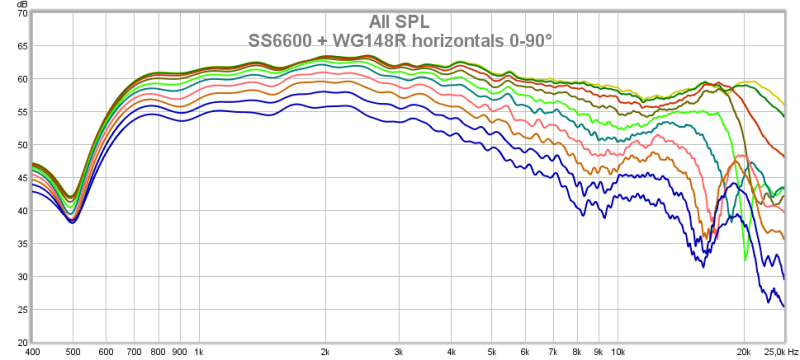

8- Post #310 by Pida - 3-Way 90-91db, 2x8" Woofers, 6-7"midrange and waveguide loaded tweeter.
See graphs from Basta, bafflestep and predicted crossover included (Rs 0.3Ohm), bumps around 300Hz are typical for crossover around 300Hz and will have to be suppressed with RLC.
2xNE225W-08 BR70l, sensitivity ~90dB/2.83V/1m
2xNE265W-08 BR80l, sensitivity ~90dB/2.83V/1m
There is also SS6600 measurements with and without WG148R, both taken in baffle with R50 roundovers. Dip at 500Hz for SS6600 + WG148 was caused by air leak around tweeter terminals as I removed rear cup and not properly sealed it afterwards.
Effect of WG is clear. Baffle was tilted back 7deg, that enabled LR2/LR2 crossover.
WG148R has to be modified to accomodate SS6600 without faceplate. This plus CNCed front baffle makes project quite difficult to reproduce, but CNC shops are quite common.
Anyway, it is all just suggestion and inspiration.

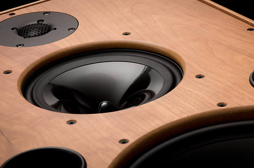

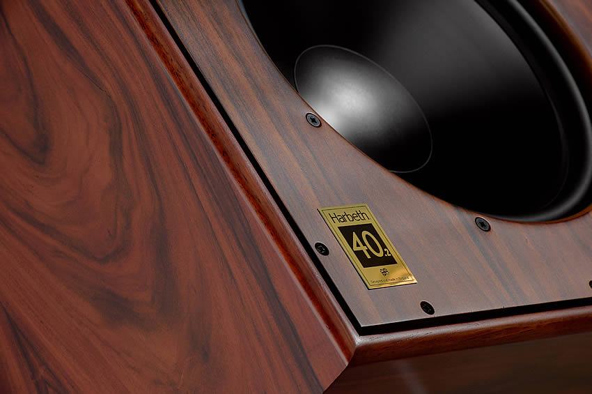

Harbeth Monitor 40.2 domestic
Perhaps this product has got the potential of being interesting with a modificiation of putting the tweeter into a waveguide. An enclosure design employing solutions found by BBC Research Department 1977/3 in "Factors in the design of loudspeaker cabinets"pdf. A light structure with well damped enclosure panels, sounds like something special, definitely not an everyday sight in a loudspeaker world.
Transducer system 3-way vented:
300mm Harbeth bass unit;
200mm RADIAL2™ mid;
25mm ferro-cooled soft dome tweeter
Frequency response:35Hz - 20kHz ±3dB free-space, grille on, smooth off-axis response
Impedance: 6-8 ohms, easy to drive
Sensitivity :86dB/1W/1m
Dimensions:750 x 432 x 388mm (+12mm for grille and binding posts)
200mm RADIAL2™ mid;
