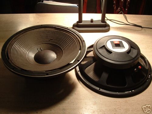

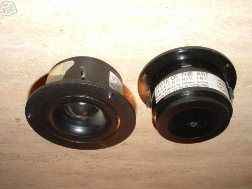

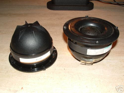

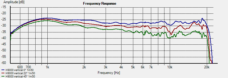

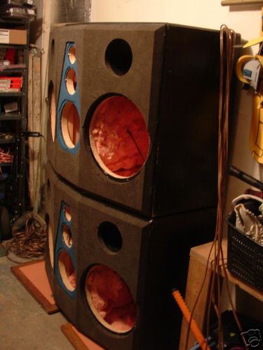

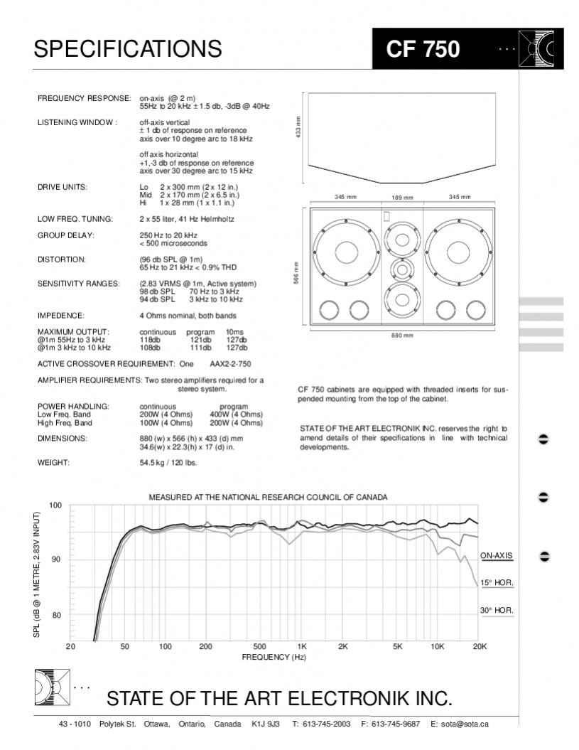

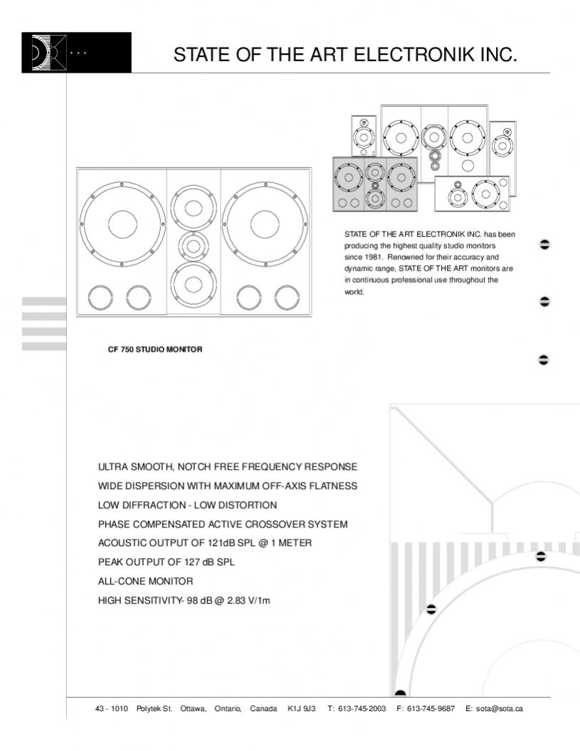

I would consider designing something using similar components to the (nla) SOTA CF750 Control Room Monitors ( though arranged as a WMTMW floor-stander / which is a bit more applicable to apartment living )
These ( active ) monitors were held to quite rigorous specs ( inluding polar coverage ).
See:
These ( and the larger models CF2000 ) continue to be used here in local Toronto studios.
Typical top-end was typically the dynaudio D28.
Mids came from various suppliers ( JBL, dynaudio, maybe audax )
Bass in the large twin 15 model was JBL ( I don't know whose woofers were used in the twin 12's );
I would consider using ( by buying a pair and putting them through their paces ) DIYSG's , Magnum 12 woofer.
I would certainly concentrate on getting ( at least the 1K to 10K ) horizontals to emulate the following ( for solid imaging purposes );
The larger model had a sculpted/absorbent foam covering the majority of the baffle board ( for diffraction control ) ;
These monitors ( even 30 years after their first appearance ) are still state of the art ( IMHO, even the cut-sheets are ) .
Clearly a bunch of parts substitutions would need to be made by myself / but their are replacement drivers out their that would compete.
I really like the sound of the Audax PM170MO so I would endevour to include it into my design.
That would push the final design somewhat toward the performance of the Westlake BBSM12 ( floor-stander ).

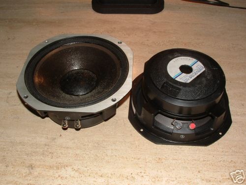

Because the polypropylene cones are giving best performance. They have their disdvantages, surely, but are most pleasant to listen and well bodied, with all detailed and depth in them, what is quite unlikely to be Heard with paper drivers, which sounds dry sometimes and needs to be covered with many things to sound properly.
What I was thinking during choosing the design:
1. Satori tweeter - they are (in most cases) exchangable - soft done with Berrylium, so we can have a soft some or three times more expensive, but still far cheapaer, and as told by many, better driver than SS berrylium
2. - as above. Most natural, have depth and lots of other positive aspects. I think Morel MW 6" midrange, which costs around 130$ is best thing we can use, as other top end drivers like Rohacell, Volt or Audio-Technology costs considerably more, and I dombelieve that in this class of drivers they do not sound 3 or 4 times better, as the price would suggest.
3. Not sure about woofers only. Sometimes I wonder whether metal ones wouldn't be best of all, as most of acoustic instruments are made from metal (partiach at least), or what makes them sound is metal like strings. However, while first two point are in my head no changers, so for the bass I am still open.
I want to achieve sound, which can recreate acoustic instruments sounds and all of their harmonics and so on as good as possible, while still being versatile in other music genres.
And no fancy design, Classic will all drivers on a front wall.
...I think Morel MW 6" midrange, which costs around 130$ is best thing we can use, as other top end drivers like Rohacell...
Metal cones tend to be heavy, which is in contrast to high efficiency. They therefore tend to go against the design goals of the Monkey Coffin.
