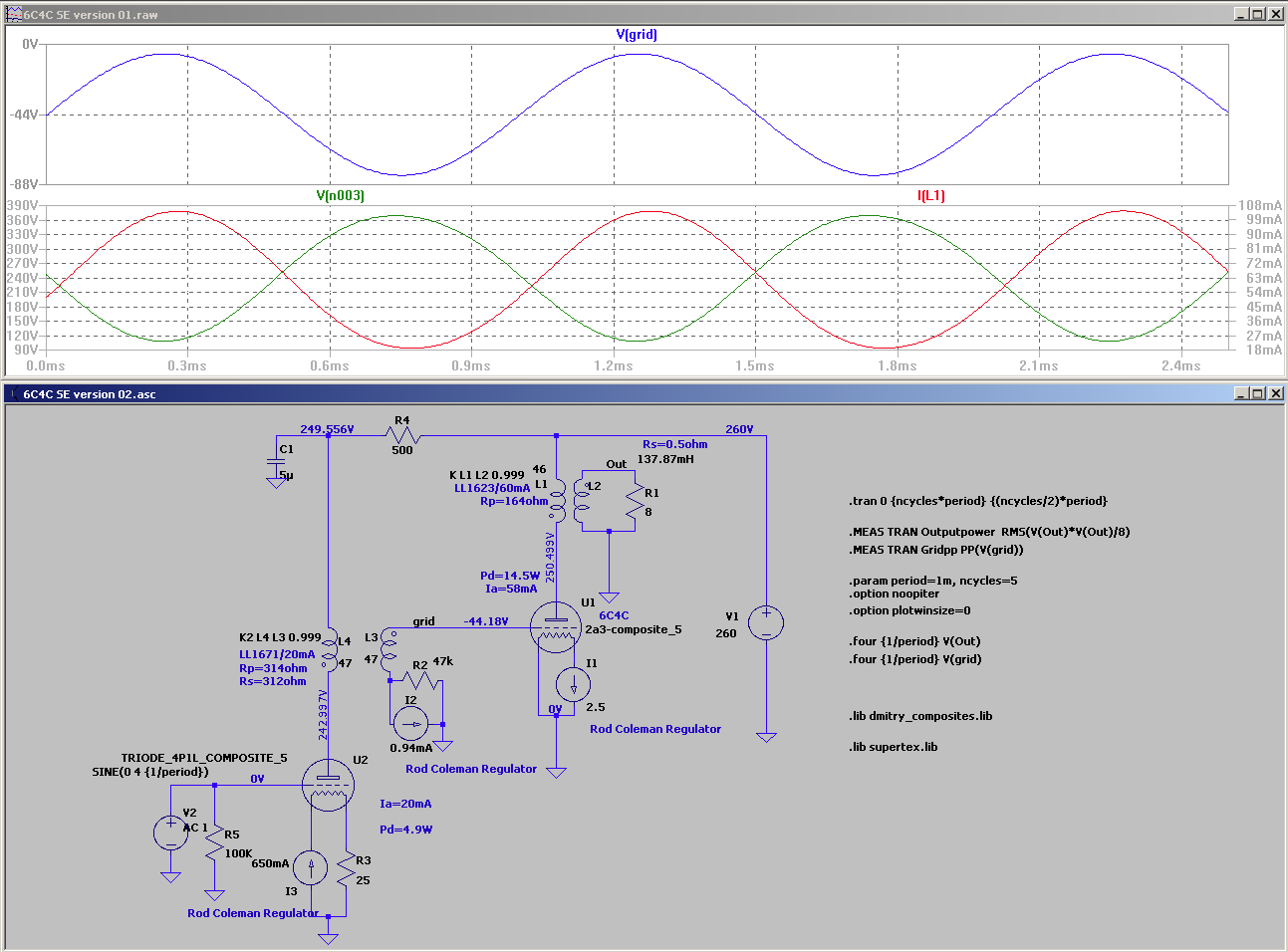

One more 4P1L SE
This is what I am coming up with for a 2W all DHT 4P1L headamp, I think it is worth the cost to try and build (FYI there is more 2H going in the output tube than coming out.)
I am not showing the input transformer. Any feedback appreciated. My design decision is coming down to either this SET or a 4P1L + SS Buffer hybrid.

I wouldn't run the 4P1L at 325mA filaments as H3 increases significantly and linearity goes down the toilet when swinging large signals. 350/360mA in my experience is the minimum...

Not questioning H2 cancellation, which is not that easy to achieve in practice. I was just using empirical data to demonstrate that actually 4P1L is more linear than 6C4C.

Glad you understand what I was trying to say, I agree in real life its difficult but there is some truth to it.
Ill post bigger screenshots in time, right now still looking at the GU-50 vs 6C4C vs PSE 4P1L for the output.
Back to the 4P1L, thanks for the tip about the filament. I agree that it is inherently more linear than a 6C4C up to a point. For my case where I am driving 2 watts into 38 ohms I need to swing a lot of volts across the primary, almost as many volts as an 8W 300B output. So the 4P1L just may not have a high enough plate voltage to work as an output tube for my 2 watts, but it is looking perfect as a driver. Unfortunately my transformer models are the limiting factor here ( I can't figure out how to model the -0.8dB insertion loss of the LL1623.

Are you running the 4P1L in series or parallel filaments? Looks like series. I'd run them in parallel at 1.9v. Smaller cathode resistor in filament bias.
Don't neglect to try 4P1L in filament bias on the output. I started with 6C4C with bypassed cathode resistor as you show, and much preferred 4P1L in filament bias. Getting rid of the cathode bypass lifted a veil. In particular the piano sound is incredible, and if you like piano you should hear it.

Building on your idea, here is my first sketch of a 4P1L into 6C4C (or 4P1L PSE). 4P1L driver is using LL1671 IT in filament bias. The fixed grid bias is using your regulator as suggested above. 6C4C/4P1L PSE with output transformer LL1623/60mA. Looks like a good approach. Couldn't simulate it as the ideal current source used in the IT secondary prevents the AC signal to develop in the grid. Any idea of how to overcome this in LTspice?

Yes, if the 47K grid resistor is moved to connect across the CCS only - then connect one end of the IT secondary to the bias, the other end to the grid. No other connexions at the grid needed.
This way, the grid sees the bias voltage, but the IT winding feels none of the dc current.
With a high quality IT, this will give an excellent solution!

Cheers Rod, should have thought that one myself!
Here is the updated circuit, I think it should perform well and also can be easily tweaked to get the 4P1L output stage with a 20K grid bias resistor only...
