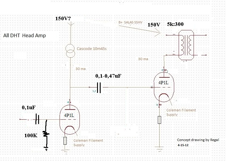

Pic with supposed schematic? could anybody draws or link me to the DN2540 cascode?
No, you don't. Try first.

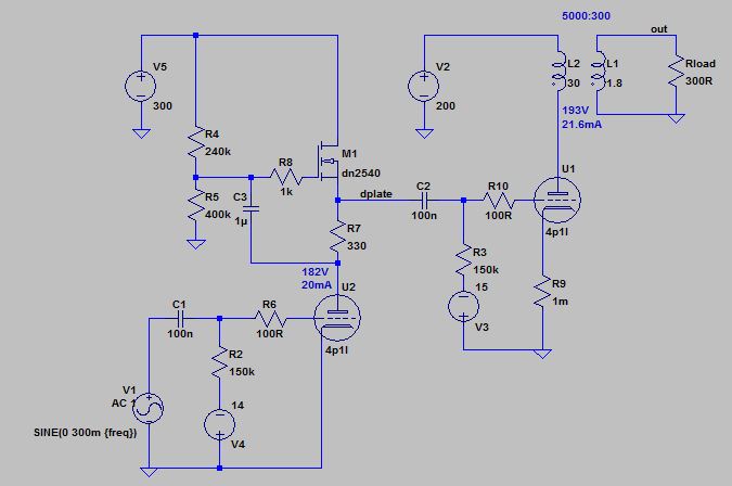

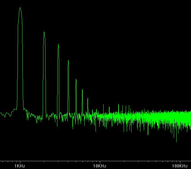

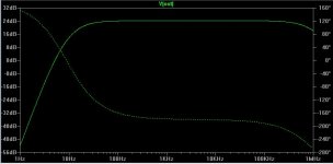

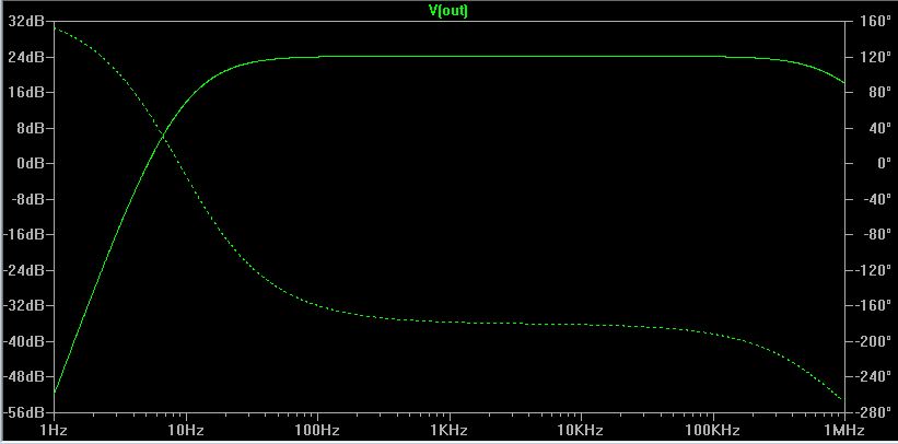

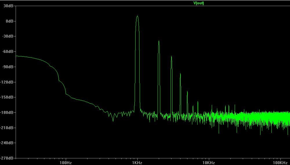

Roughly, this is how this simulates with the 4p1l model I have. No filament starving tricks here and operating points chosen in a hurry. Assumed 300mV p-p input, output 10V p-p, which for this circuits translates to about 90mW.

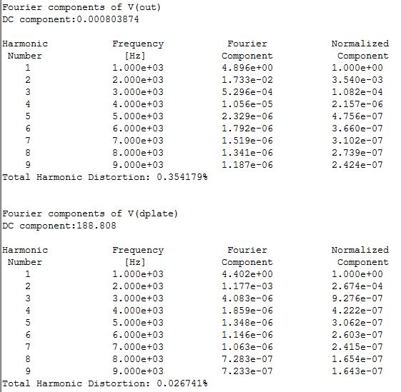

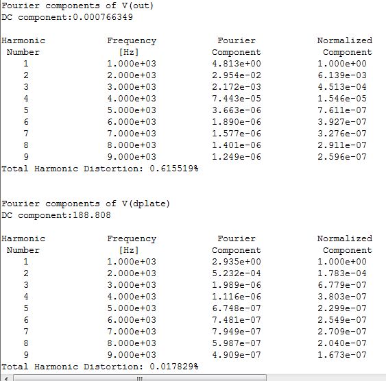

Using a 4p1l in the first stage but a 307A (triode connected) in the second stage gives you this. Not much of a difference. Of course, this is just simulation, not reality.

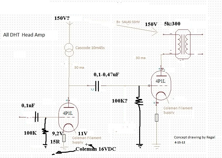

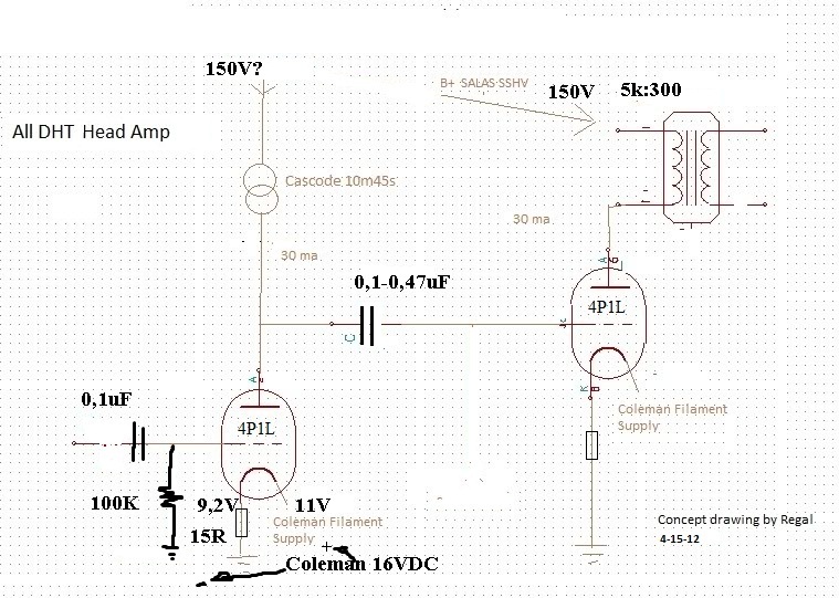

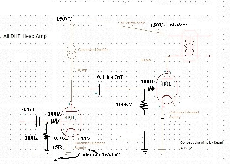

I have 100R 1/2W, updated attached pic, the pic is OK now?
Thanks for cleaning up my skimpy schematic, but 150V B+ is much too low.
Good operating point for this tube is 200-230V 30mA.
So that means you have a B+ of about 275V for the first tube with the CCS or gyrator, then use an extra RC to give the 200V B+ for the second tube.
