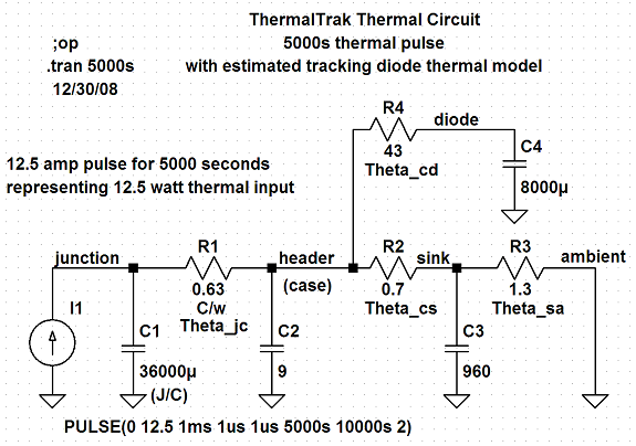

ThermalTrak thermal model
I have inferred the thermal circuit for the ThermalTrak diode, comprising its thermal resistance from diode junction to header and its thermal mass.
These numbers were estimated by applying a 1 amp current through the diode for several seconds to warm it up to its asymptotic temperature rise above the header. The case was thoroughly heat sinked. The current was then suddenly reduced to a junction measurement current of 10 mA. Diode dissipation during the ON interval was about 0.79 W.
When the high current was removed, I watched the recovery of the diode drop back to its initial cold value. Diode drop immediately following removal of the high current was about 58 mV. The 58 mV change in junction drop, at an estimated 1.7 C/W, corresponds to a junction temperature rise of about 34 C. The time constant for recovery was about 350 ms.
This gives an estimated thermal resistance of 43 C/W and a thermal mass of 8 uF (8 uJ/C). This amount of thermal resistance is surprisingly high, suggesting that OnSemi did not try hard to achieve a tight thermal interface from the junction of the tracking diode to the header. The thermal mass of the diode, at 8 uJ/C, is about ¼ that earlier estimated for the BJT die, so this seems to make sense.
The important point here is that the diode assembly time constant of 350 ms is much shorter than the header assembly time constant of over 6 seconds. This means that the diode will accurately track the header temperature with minimal relative thermal lag.
The thermal model for my experiment is shown below. The heat sink was measured to have a thermal resistance of 1.3 C/W and a thermal mass of 960 J/C (960 Farads in the thermal model). This results in a heat sink time constant of 19 minutes. The heat sink is a finned unit upside-down on the bench, so it is probably operating at a thermal resistance a bit higher than its nominal capability.
Bob
Bob

Re: ThermalTrak thermal model
Thanks for the info, Bob. Most ingenious attack on the diode!
I will post my version of the model as soon as I can get it drawn up. I note you are considering the copper header as isothermal, which I think is sound. I modelled it and came up with a Rth of only 0.017 from top to bottom.
However, the apparently impossibly large thermal capacity of the header continues to bother me.
One question: since the spec for Rth juncn-case is 0.694 degC/W, shouldn't your R1 be 0.694 ?

Re: Re: ThermalTrak thermal model
Hi Doug,
Yes, for my simplified model here I assumed the copper header is isothermal, and I think that is a pretty good assumption. However, in my earlier post where I had previously modeled an IRFP240 MOSFET with a more distributed model, I did allow for a slight departure from isothermal directly uner the BJT die, but that was just a swag.
Good catch. The number I was using in my ThermalTrak model for Theta jc is definitely wrong, and is a left-over from the IRFP240 model I started with.

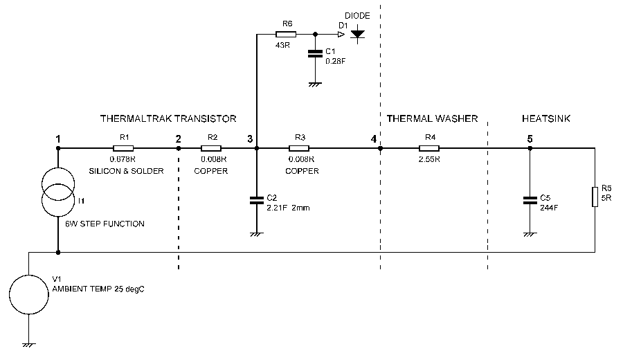

Re: Re: Re: ThermalTrak thermal model
Hi Bob
Here is my thermal model, such as it is. You will see that I have concentrated the header mass in the middle of R2 and R3 which represent the thermal resistance of the top and bottom halves of the header respectively. I am running some simulations with it now.
I will try adding your refinements- the junction capacity and the time constant to the diode, but I think they will only affect the short-term dynamics- right now I'm looking at the compensation over 100 seconds.

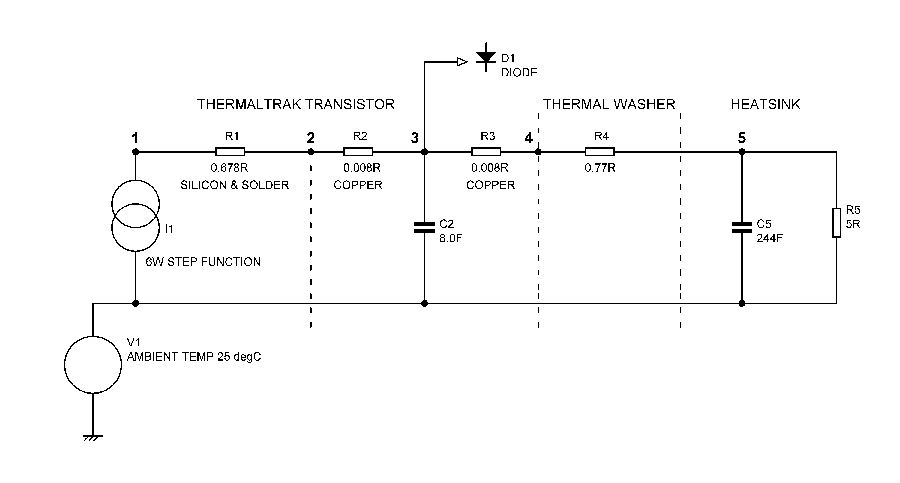

Hi Bob
My model is no good. It does not bifurcate the condiment, part the pickle or otherwise cut the mustard.
I have run a lot of simulations and the assumption that the diode temperature is only separated from the junction temp by one thermal resistance does not work. Apart from anything else, it implies that for a given power-step size you can get perfect long-term compensation just by adding a fixed voltage to the diode voltage and using that for bias. My experiments (see around Post #188) say otherwise.
I think that the diode has a significant extra lag, in that the time constant when the diode is heated by the transistor, instead of by its own current, is much longer, possibly because the diode is buried in plastic which will also need to be heated. This extra diode lag would explain why the apparent header time-constant is impossibly large.
I have put together a revised thermal model using a practical value for the header thickness (2mm for the time being) and using your value for the thermal resistance to the diode, (43R) and adding capacity to that (much more than in your model) until the diode Vf response was the same as my LM35 measurements. That's obviously only a first-order approximation, but it seems to be a lot more realistic than my first attempt, as now it shows the dip of over-compensation for the first 20 seconds that I measured in Post #188. This is due to the delay in the heat getting to the diode.
The model attached. I have assumed a thermal washer Rth of 2.55R to make the numbers work; given the low mounting pressure I think this is plausible.
It goes to show that the TTrak devices, although certainly a valuable addition to the designer's armoury, are going to need a lot of thought to apply properly and to use their potential. The diode is nowhere near isothermal with the junction, and now it looks as if we have shown that it is nowhere near isothermal with the header either.

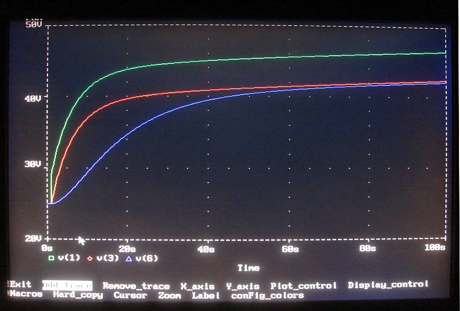

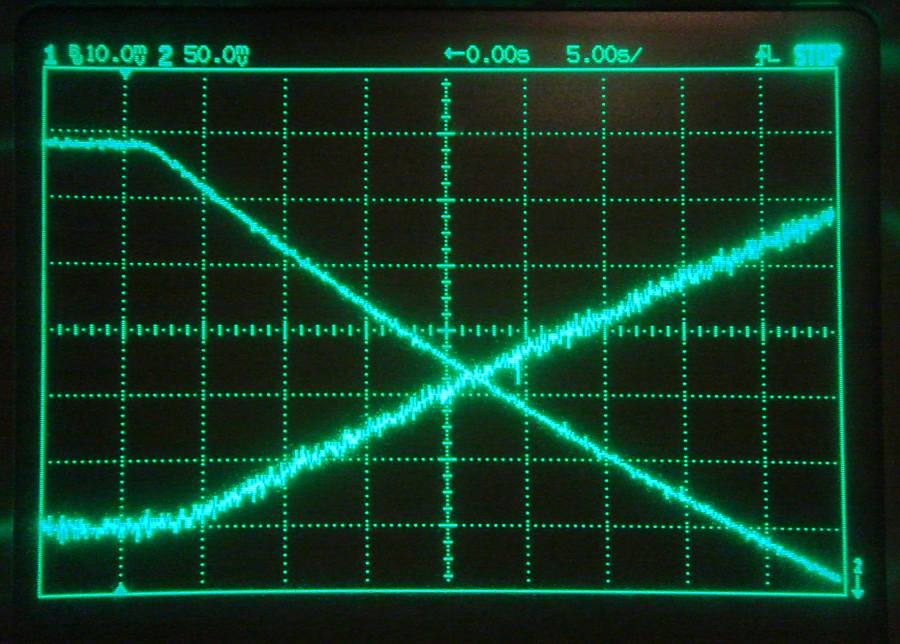

I thought I'd better test my new model, so I measured the rate of temp change of the metal plate compared with the change of diode voltage. Once more the timescale is 5 seconds per large division, temperature 5 degC per large division for both the diode and the LM35 clamped to the plate. A thermal washer Koolpad K230 was fitted between the plate and the LM35.There is no heatsink involved so things get hotter faster. The diode voltage is the trace that starts at the top.
The result is that the diode is responding at about the same time as the external face of the metal plate. This is clearer on some runs I did at 2 seconds per large division. I suspect that in this case the thermal inertia of the LM35 may not be negligible.
Anyway, looks like V2 of my model is also wrong, as it predicts that the diode voltage will significantly lag the plate temp. I'll post the PSPICE output shortly.
(DSC07807 Pic17 sm.JPG)
This is the PSPICE output. V(1) is junction temp, V(3) temp of the middle of the copper plate, and V(6) the diode temp.
As you can see, the last significantly lags the plate temp, by a good 15 seconds, which is nothing like what I have just measured in Experiment 2.
Clearly time for model V3, but it's now a puzzler what to do about the impossibly long time constant I found in Experiment 1.

DouglasSelf said:
Hi Bob
Hi Doug,
I think this agrees with my observations - that the diode junction temperature does not significantly lag that of the header.
On the subject of the thermal mass of the header/transistor assembly, I should mention that I previously arrived at the estimated thermal mass by a second method as well, I think not unlike what you describe here. I measured the rate of temperature change of the assembly when it was not in contact with a heat sink and observed the "thermal slew rate", where power in was like a current source feeding an integrating capacitor (the thermal mass). The degree of perfectness of the integrator in this arrangement is only limited by the fairly high thermal resistance from case to ambient. By this method, I arrived at a thermal mass on the order of 8 Farads (8 J/C), which was not far off from the 9 F I arrived at by the other technique.
Bob
