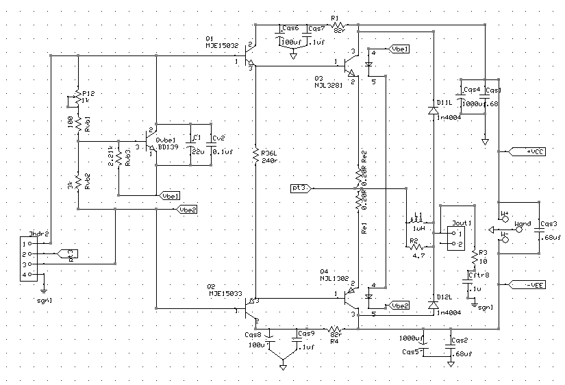

So, I've built and tested this configuration with an LME49811 as the VAS and predriver and 15032/33 as drivers. I can't get enough bias sensitivity to hold the bias constant regardless of temperature. In all cases the bias rises with temp - the amount of rise is affected by the R3/R2 choice.
I've tested the 10k/893 and the 3k/2142 versions and get the following results. I'm using a hand held infra-red temp measurement device.
10k/893
29.4C = 29mA
37C = 38mA
9mA/7.6degC = 1.18 mA rise / degC
3k/2142
25C = 27mA
39C = 38mA
11mA/14C = .78 mA rise / degC
The target would be 0 mA rise / degC
Is there a way to get more sensitivity from this circuit?

Hi Ken,
Can you post a schematic of the whole arrangement that you have got?
BTW, note that the LME49811 is only rated to supply 6.5 mA to the Vbe multiplier. I don't recall how much I designed that Vbe multiplier for in the example, but I usually design for 10 mA.
Also, your quiescent bias numbers for the output stage seem awfully small. If you are using a single pair of ThermalTrak BJTs with 0.22 emitter resistors, bias should be on the order of 120 mA.
If you are using a CFP output stage, you should probably be using something else.
I'm assuming from what you've said that you are using a Locanthi Triple EF output stage where the pre-drivers are inside the LME49811.
Bob

Hi Bob,
I was using the small bias based upon recommendation from AudioMan54 - Mark. I can easily dial the bias up - I had it at 350mA the other day by accident...
I'll post the schematic tonight. Yes, it's the Locanthi Triple EF just as you describe.
Ken
Bob,
Here's the schematic in two parts, the LME49811 and then the CAS.
Regarding bias level, could setting it at a higher level affect the thermal compensation?
Ken
