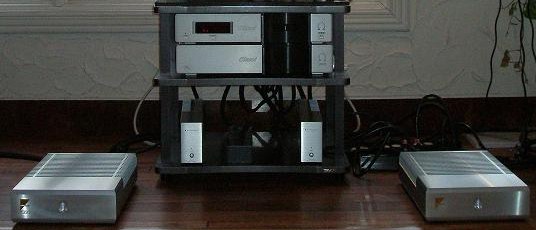

Jacco nice pic, no tell us what that system consists of. Are those DIY amps???

homemodder said:system consists of.
Classe Omega preamp and Mr. Charles Hansen's GMAFB MX-R power amps.
Ya Kneu :the ones with ThermalTrak devices, 16 per channel.
(the screw type PS-connectors on the pcb are cool, i use them as well, manufactured by Riacon)

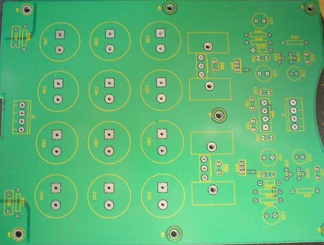

For DIY sniffers : a piccy of the Omega PS board with the first stage +/- series regulator for 1 channel, second stage is a separate shunt regulator (lateral mosfet) on a heatsink.
