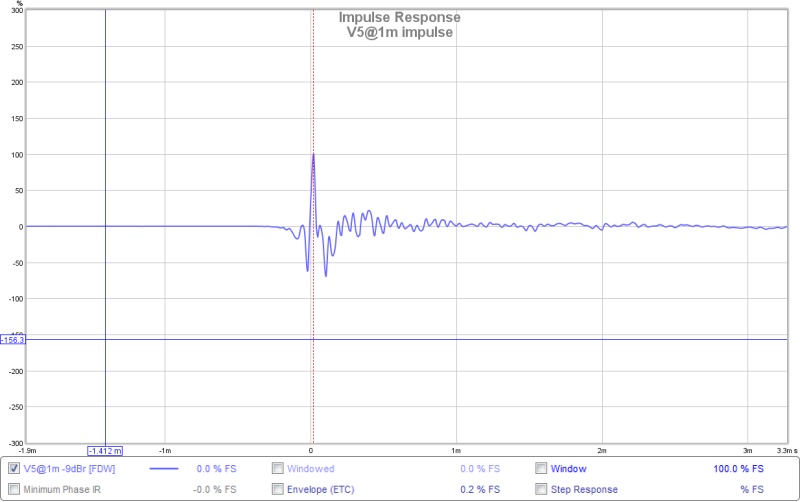

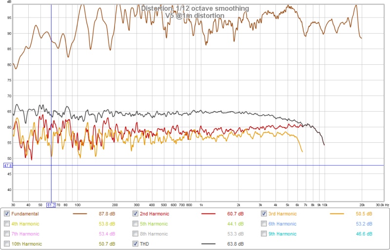

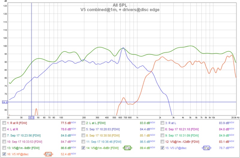

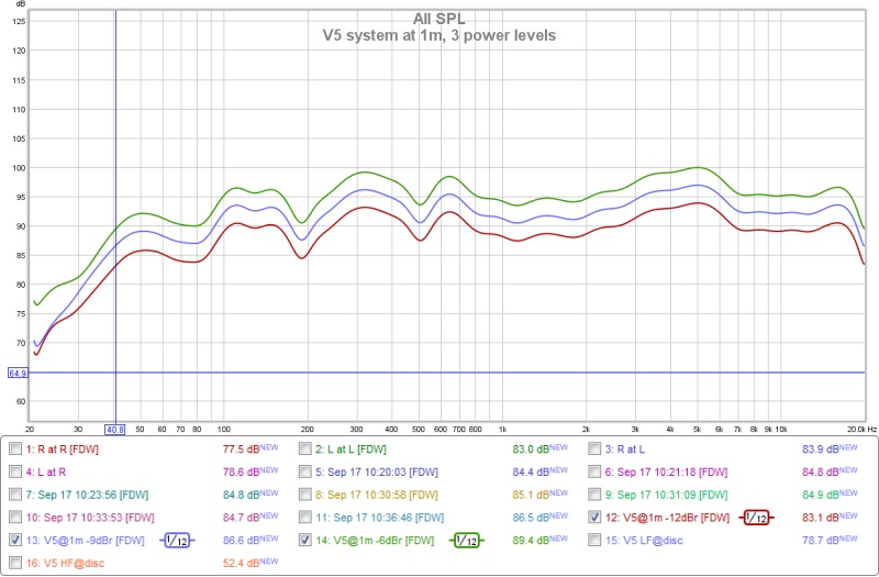

Omni V5 - system tests
I've added RLC notch filters (pic#1) at 630Hz and 2.5Khz to reduce the "humps" in the FR. The graphs below have no EQ (s/w) added, and they include room acoustics. I've warmed up to using FDW 4 cycle in the FR graphs using far field measurements.
I've included graphs for driver+system, power levels, distortion, and impulse.
There is still a bump at 630Hz but it seems to show in the near field but not the far field. Even with the woofer disconnected, for the HF near field measurement, the WG+CD can excite the lower chamber. Looks like some more damping is required.
I could not find electrical parameters to model a compression driver with a wave guide. The manufacturer does not provide them and I don't think the T/S model applies. A simple 5 or so electrical component equivalent or even a polynomial(s) set would allow me to SPICE the HF response flatter.
No matter for now. I'm in a position to start optimizing for the room and my listening position.

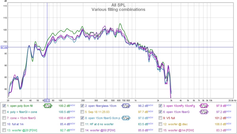

Try some fibreglass or felt in you enclosure, even egg crate foam works much better than acrylic to damp resonances.
For me four cycles is too smoothed 6 or 8 is more useful, the impulse is weird, have you measured top and bottom separately to see what their impulses look like?

Fiberglass is cheap in a "small project" pack. I'll post the results.

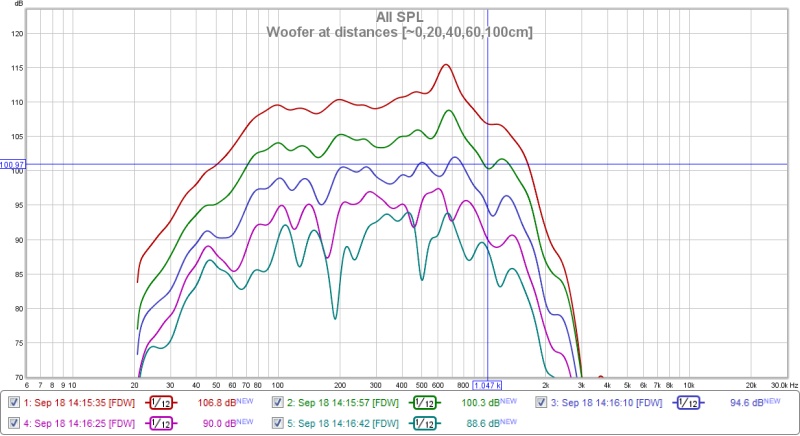

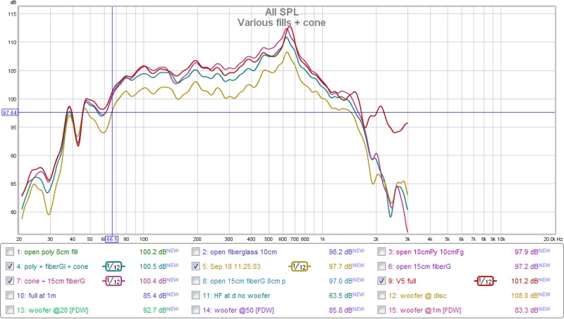

Addressing the 630Hz bump, damping using filling
There is a peak around 630Hz that I think is from a lambda/2 resonance between the bottom of the chamber and the woofer. ***** Ignore the data <60Hz, in the graph below it's from other neighborhood machines running. I really wanted to finish this.*****
This experiment is to add filling material (P=poly, Fg=fiberglass, #=cm) to the chamber to see it makes a difference. Previous measurements were made with 1/3 (8cm) of poly filling on the bottom. I have approx 23cm behind the woofer magnet to fill. I tried various combinations [8P, 8P+10Fg, 10Fg+8P, 15Fg+8P] to see what was most effective. The wave velocity will be highest in the middle of the chamber and that's where the filling is most effective. The fiberglass grain is always placed perpendicular to the wavefront movement.
With an open top woofer, (graph#1) the filling and the notch filter can eliminate the 630Hz peak. The 630Hz peak only reappears when the cone is added back as in graph#2. In all measurements, the electrical 630Hz notch filter was in place. I've concluded the problem is two fold, a chamber resonance as well as an interaction between the woofer and cone. At distance (graph#3) the peak's significance is greatly reduced so the solution's urgency is lower on my list for now.
My end solution was [15Fg+8P] completely filling the chamber. The loosest filling is poly and that was directly behind to woofer to allow it a little breathing room.

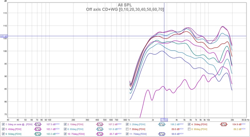

Axisymmetric waveguides particularly round ones often have an on axis dip which is not there at off axis angles.
With your waveguide in free air did you measure at off axis angles to see if there was a difference.
I don't know if this would have an interaction with your cones but it could be worth looking at.
The junction between CD and waveguide is very important and even the CD not being perfectly centred due to the tolerance of the screw mount can make a difference. Plenty of information on that elsewhere.
Fibreglass seems to have helped. I found a layer of felt in front of the fibreglass was the best combination. Fibreglass and acrylic ended up being just too much. It's easier to see in an impedance graph as the peak starts to get skewed to one side when you have overstuffed the enclosure.
The sort of felt I used was automotive underlay and was pretty cheap to get about 10mm thick. Very much like a removalists blanket or felt carpet underlay. You might be able to grab an offcut from a carpet place, it tends to still be used in cold climates.

Good idea. I've never measured off axis or at distance to see how the CD+WG behaves. I'll post some measurements.

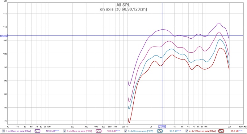

Fane CD130 plus Dayton 10" circular waveguide
My HF saddle shaped FR has been partially flattened using a notch filter@2.5KHz but still has a few issues. With the cone in place the performance is similar to the WG on its own, but I've only ever measured the CD+WG on axis. @fiuid had a good suggestion to characterize it more completely.
Graph#1 is off axis angular performance 30cm from the mouth center. The WG + CD + mounting frame + XO + 2.5Khz notch filter to reduce the first bump are included. The WG is pointed forward open space and 1m off the ground. There is a gradual loss of performance until about 75deg where it just collapses (several retries to confirm).
Graph#2 is performance vs distance to see it if it "evens" out. It doesn't.
I have tested without the mounting frame, and the 15KHz bump is still there (its not the reason). I've also used APO EQ to limit the signal output to 12KHz and used REW to test up to 20Khz to check if its a diffraction effect (its not the reason). IMO its an issue with the CD+WG operating at 15KHz.
I believe a simple RC filter just before 15KHz will flatten it to my liking

Agree as fluid said that post 188 impulse looks weird, could it be one driver has polarity reversed which could be checked looking into impulse or step response first curves in same post, would mean polarity should be same and then if there is time alignment difference that difference should be tweaked adjust relative distance on threaded rods.
I actually checked this by reversing the CD polarity. The impulse was virtually the same. It looks like the impulse response of a sinc function.
What part is causing the "weird" alert. What should or not be there?
