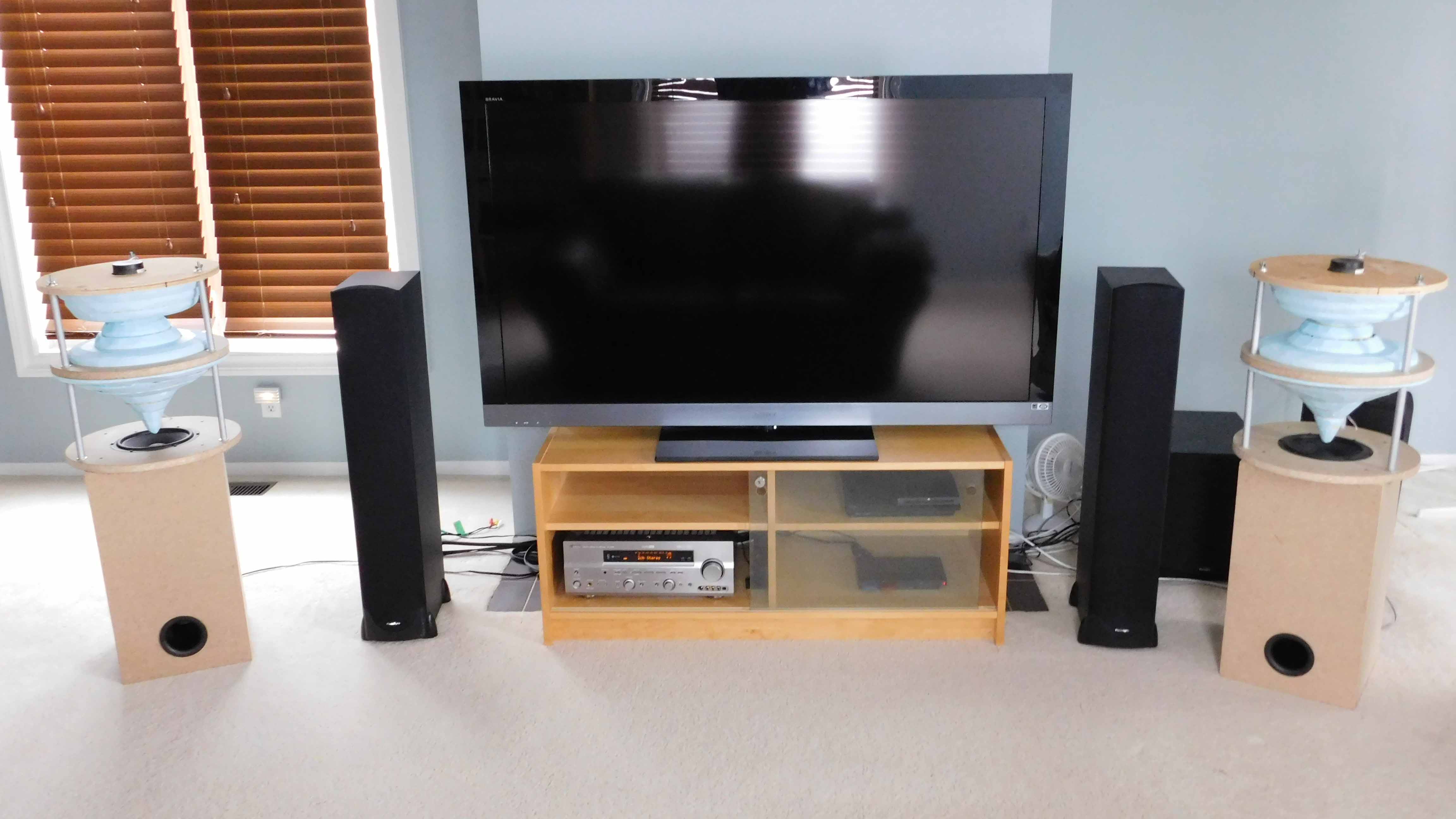

I've been working on a pair of Omni's. I'm looking for a different listening experience that is closer to the way real natural instruments project sound and use the room. I am willing to post pictures, and test results to share what works or doesn't, hoping for some insight and suggestions to improve it.
The starting point is this simple 2way setup. There were initial problems with them, but I'm enjoying them now, wanting more improvements. I'll post the those issues and my solutions up to where I am now.

V5 : new 16L sealed chamber, new discs and cones, added notch filters, same drivers as previous, using all previous lessons learned OmniDirectional - work in progress

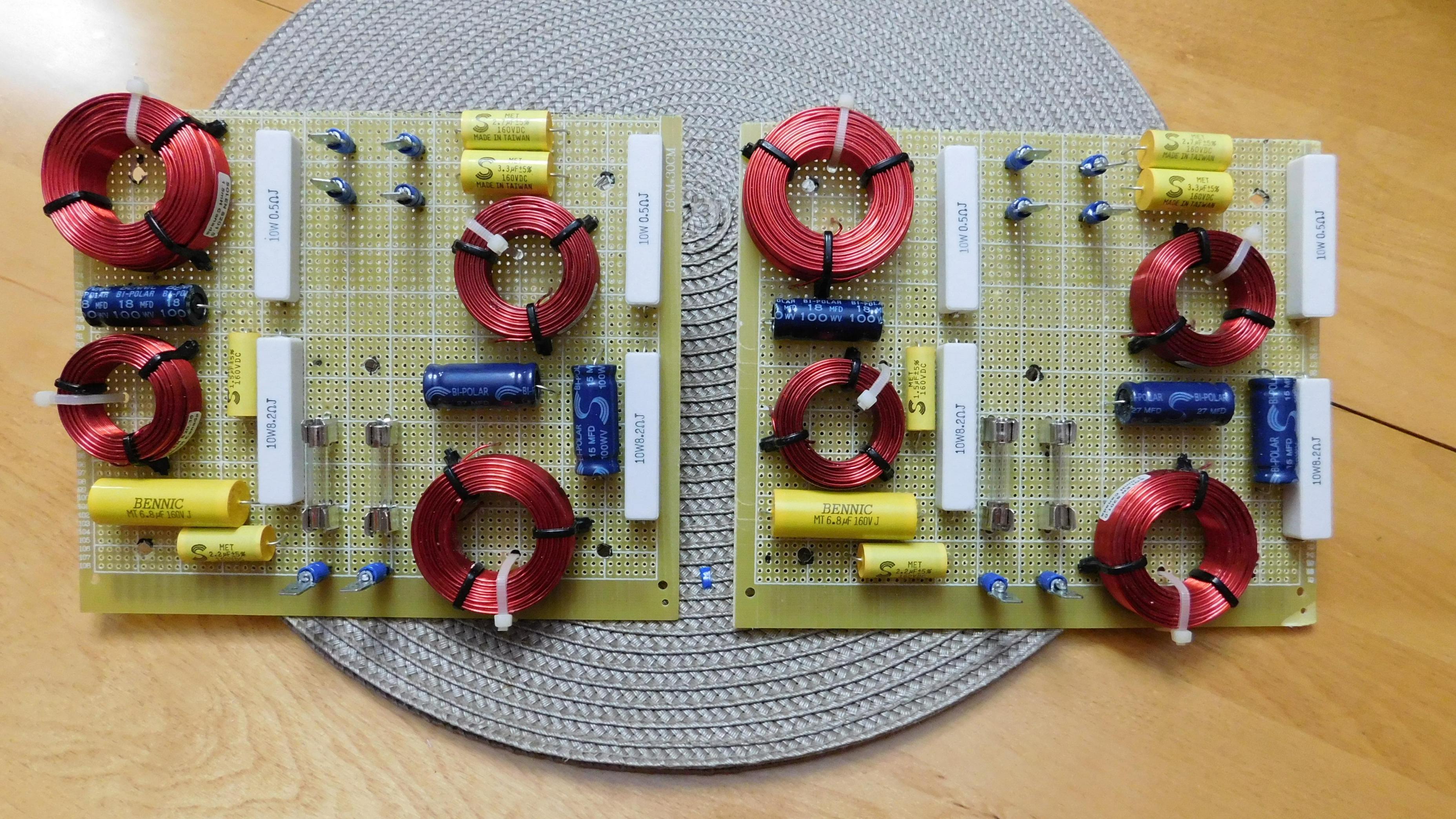

Drivers and CrossOvers
The XO is an 2 way LR4@1.8KHz + Zobel comp. connected to a Silverflute W20RC3808 (200mm woofer) and a Dayton DC28F-8 (28mm tweeter). These sound OK and are suitable for my sandbox.
First issue. The LR4 is constant amplitude but not constant power. So I have a -3db dip at 1.8Khz. Not a big deal but it will show up in all freq resp curves until I fix it.

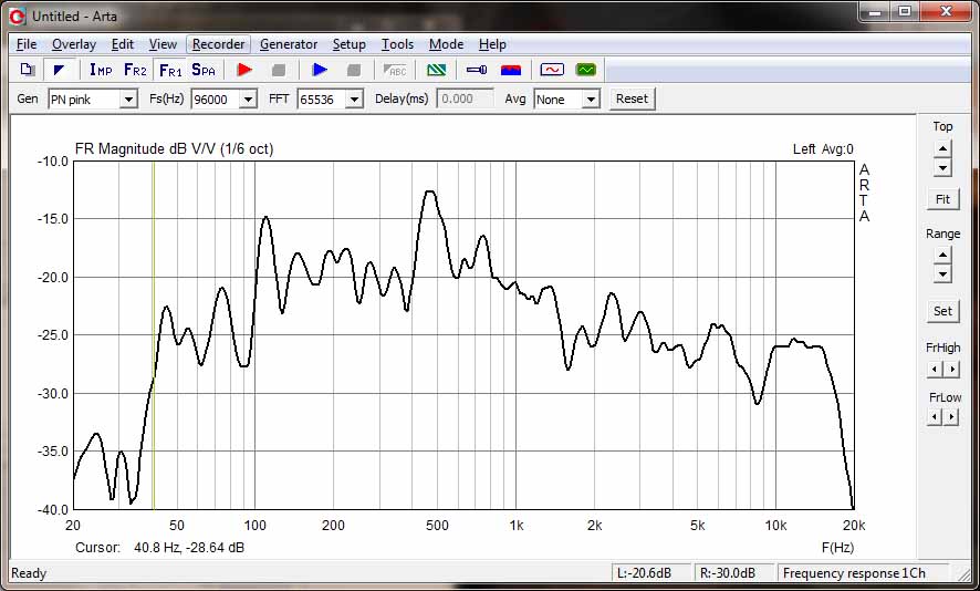

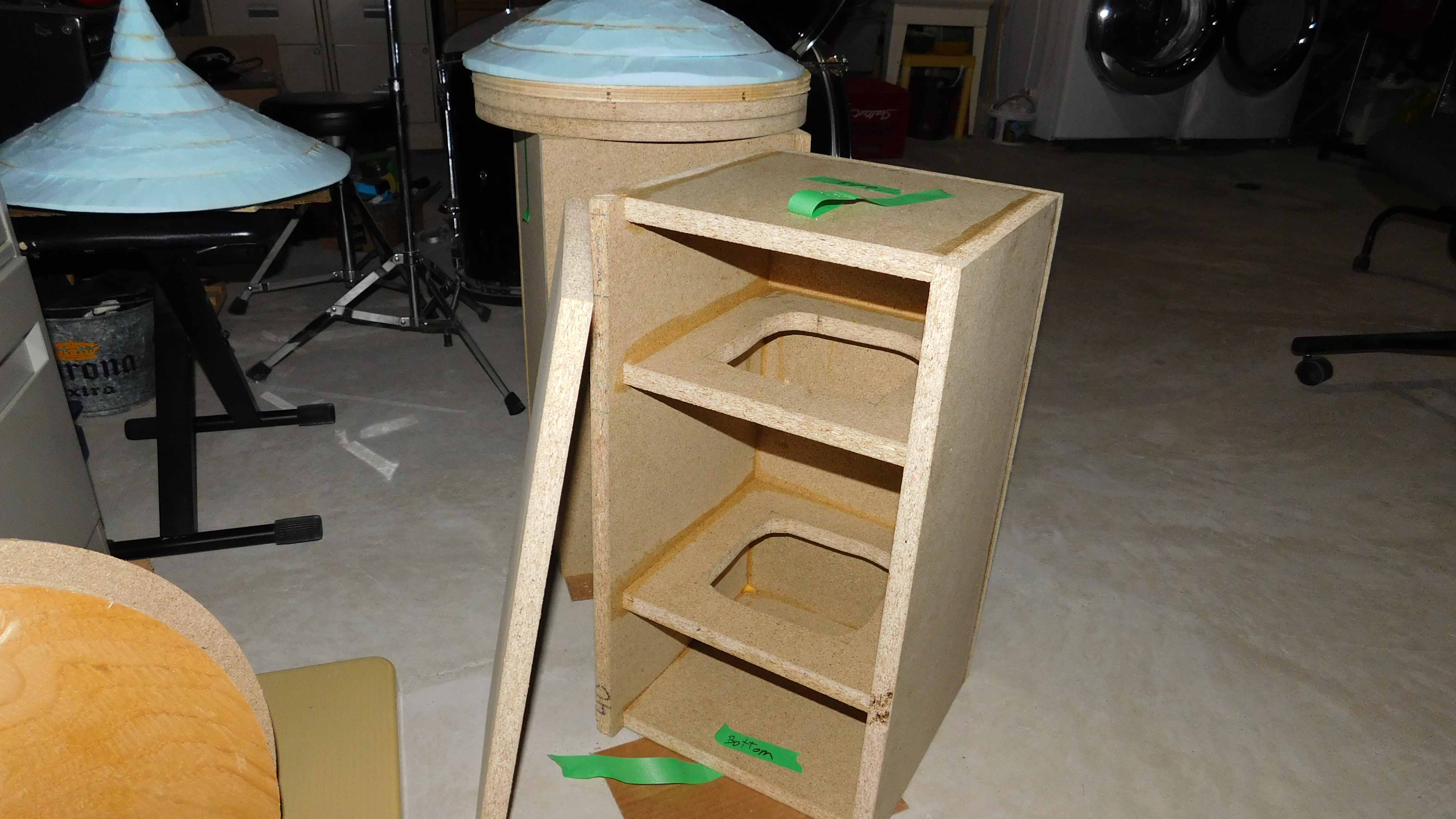

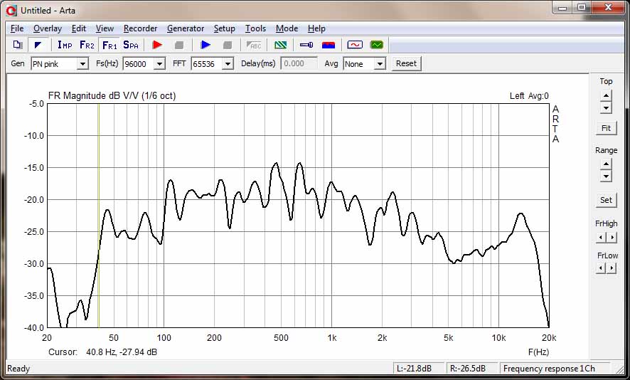

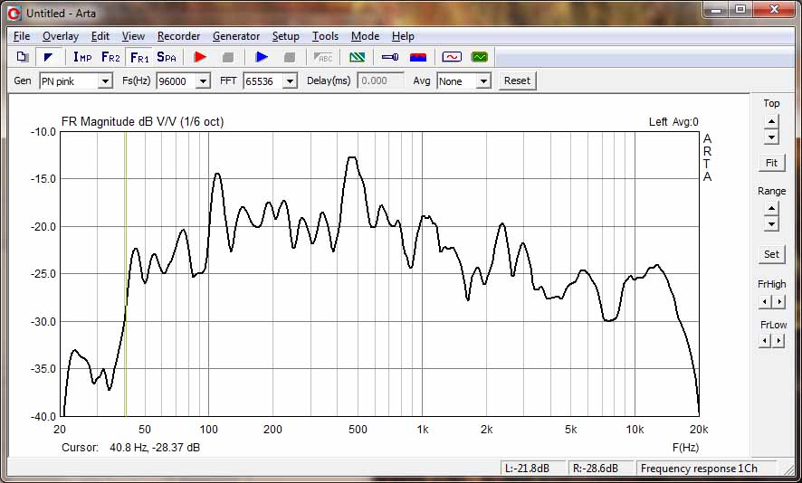

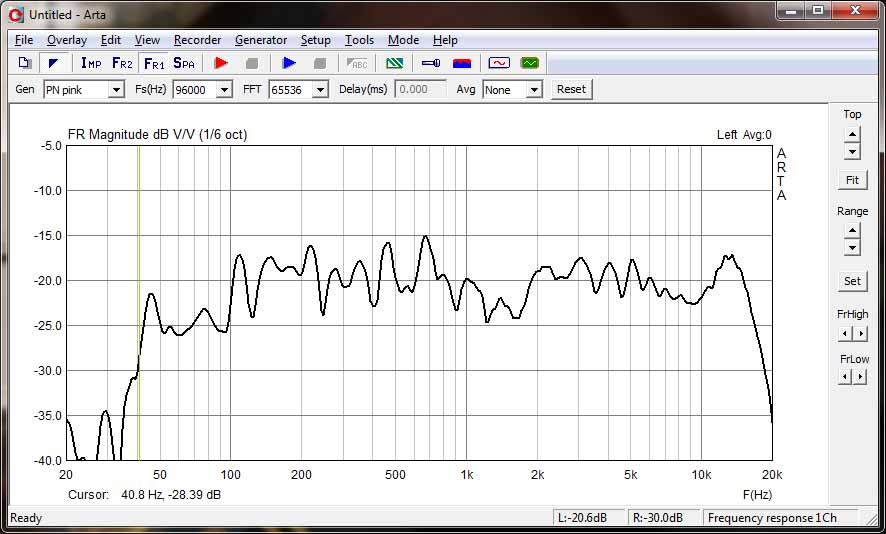

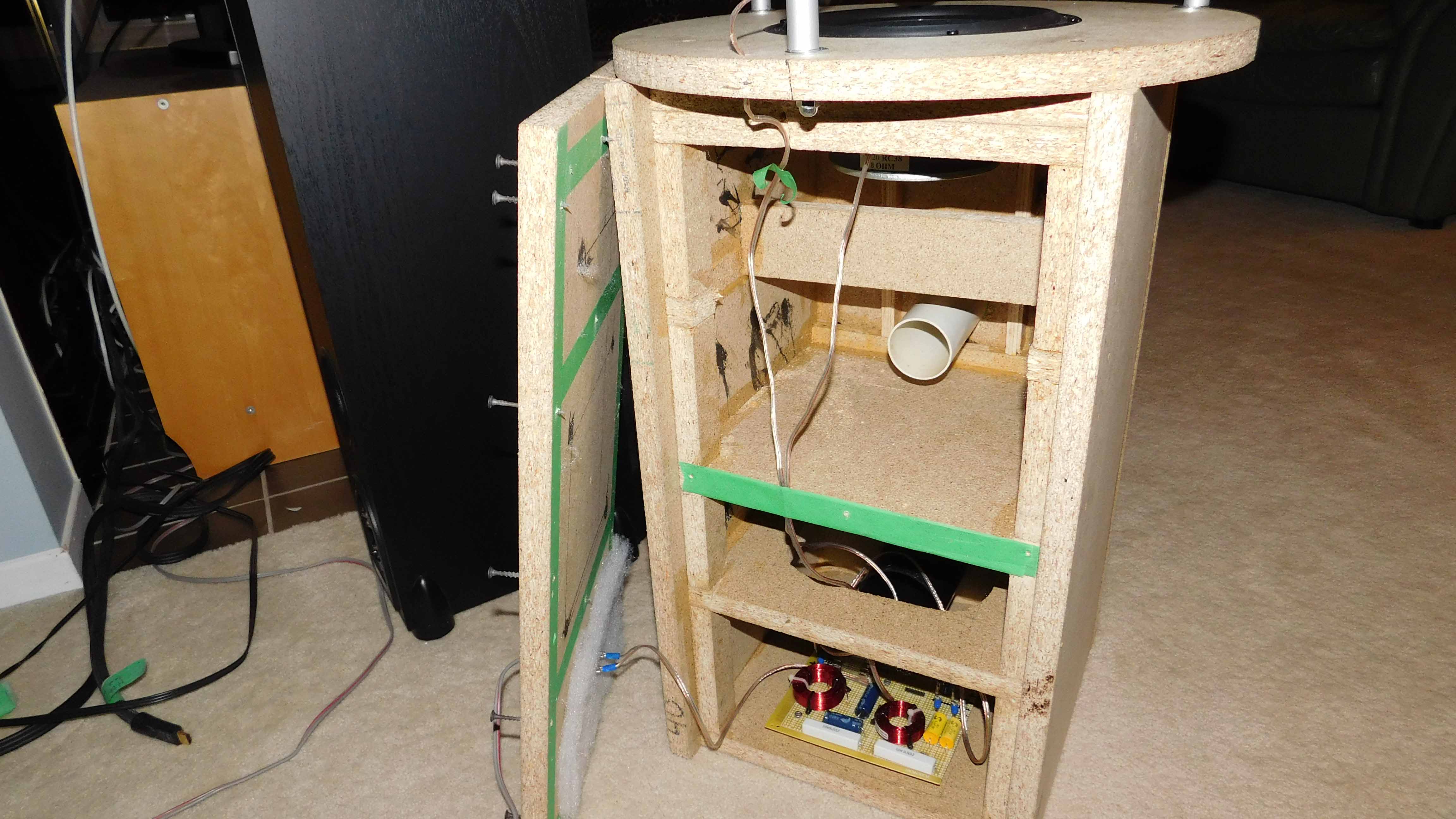

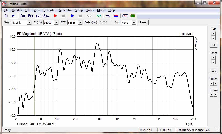

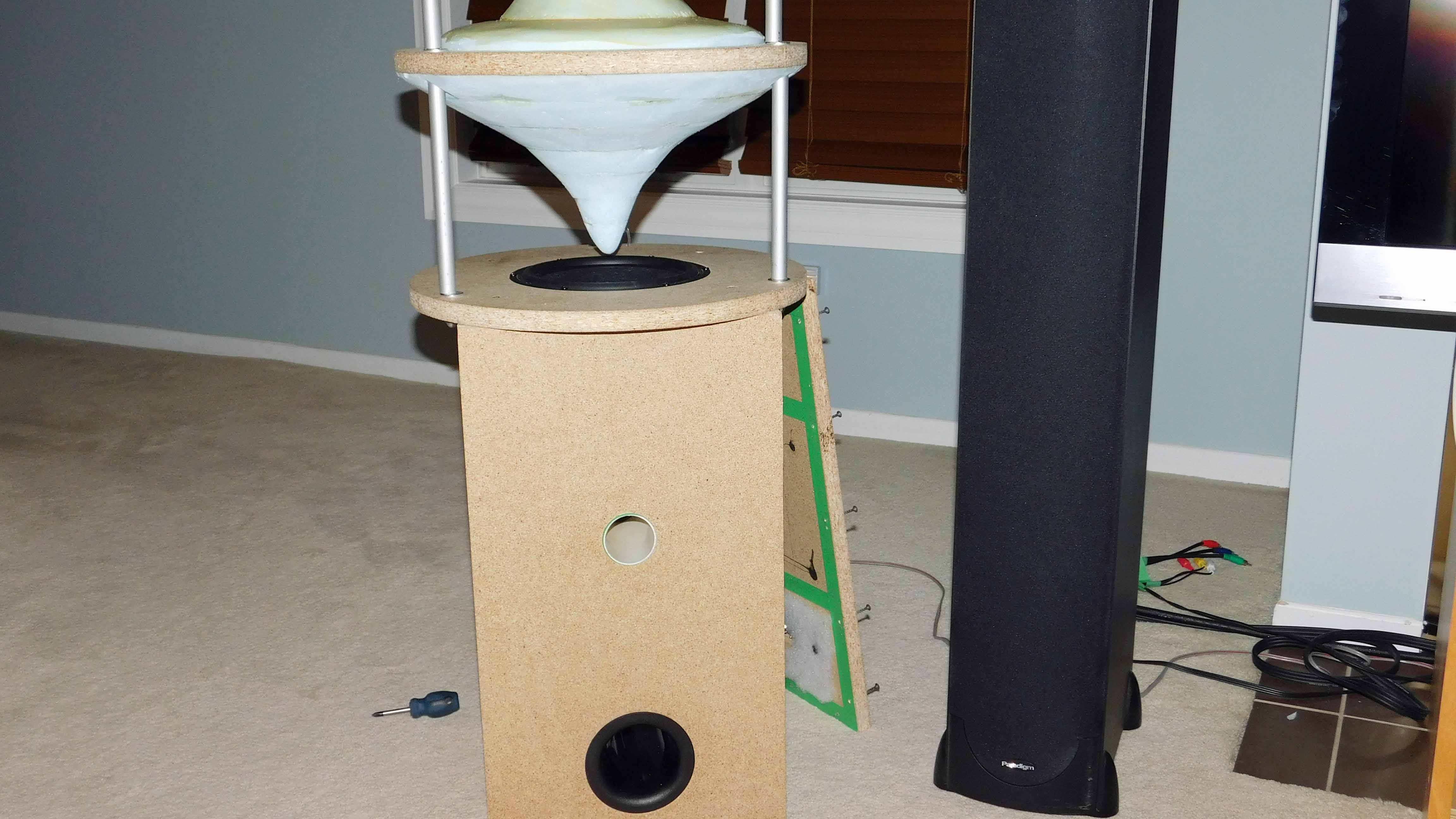

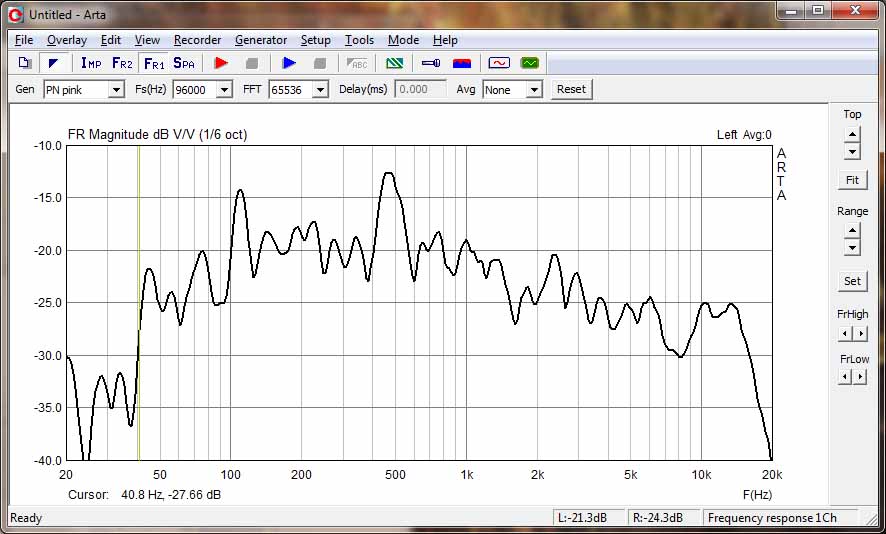

Bass reflex cabinet issues
I used HornResp to determine the cabinet volume and tuning port size. I tried to "stretch" things a bit and get fc=40Hz from a SilverFlute 8". It came up with 32L and 75mmx150mm pipe. The mfg parameters are off a bit, as I discovered later when searching for test results, but that is not the problem here.
I made the cabinet with internal ring bracing but mounted the woofer at one end so the back of the woofer saw the entire length of the cabinet. The bracing (I think) made it look like a back loaded horn and I got numerous resonances and possible standing waves that no amount of polyester fill could fix (see "before" images).
The cabinet was internally reduced to 16L via new partition and a new 25mmx140mm pipe installed. There are no "ring braces" in this new chamber and the response is pretty much what Horn Resp predicts and it extends out to 1.8KHz and down to 60Hz (when the port resp is included). The high freq tail is due to tweeter bleed through (forgot to disconnect it, like the before image).

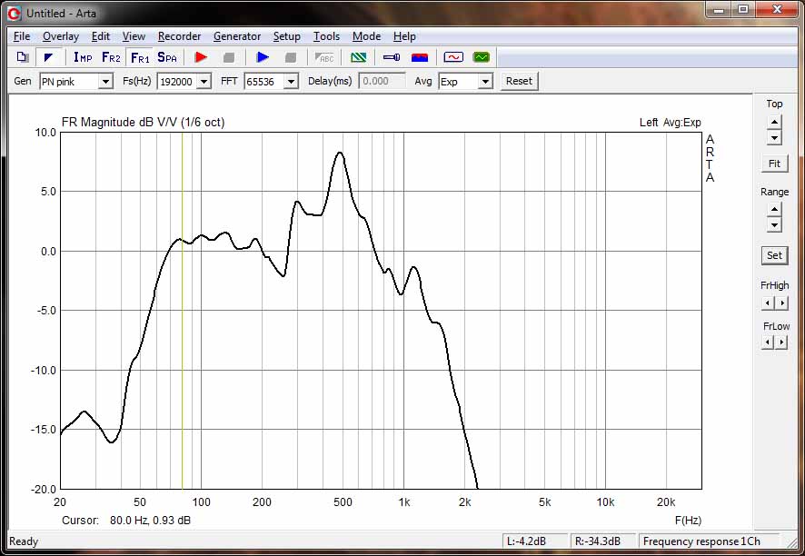

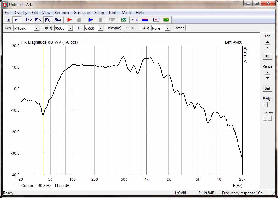

Is that lower woofer reflector cone necessary?
When I looked at various omni designs, some used a lower reflector cone (Deuval) and some didn't (Linkwitz). So I tested with and without cones to see for myself. In my case the woofer is always below the listening level. In my measurement graphs , the room acoustics are included so you'll see a bumpy curve from reflections.
Turns out that below 1Khz for a 200mm (8") it does not seem to make much difference. Regardless, I'm keeping mine as a "visual aid" and to support the upper cones. The woofer reflector is also not sensitive to surface shape or smoothness as I tried rough->refined->smoothed out and saw virtually no difference as I tried to make a better surface. Since my measurements are at 1m you can see the effect of the reflex port extending bass response.
Notice what happens to the high freq response when the upper reflector is in place. That's the next issue to deal with.

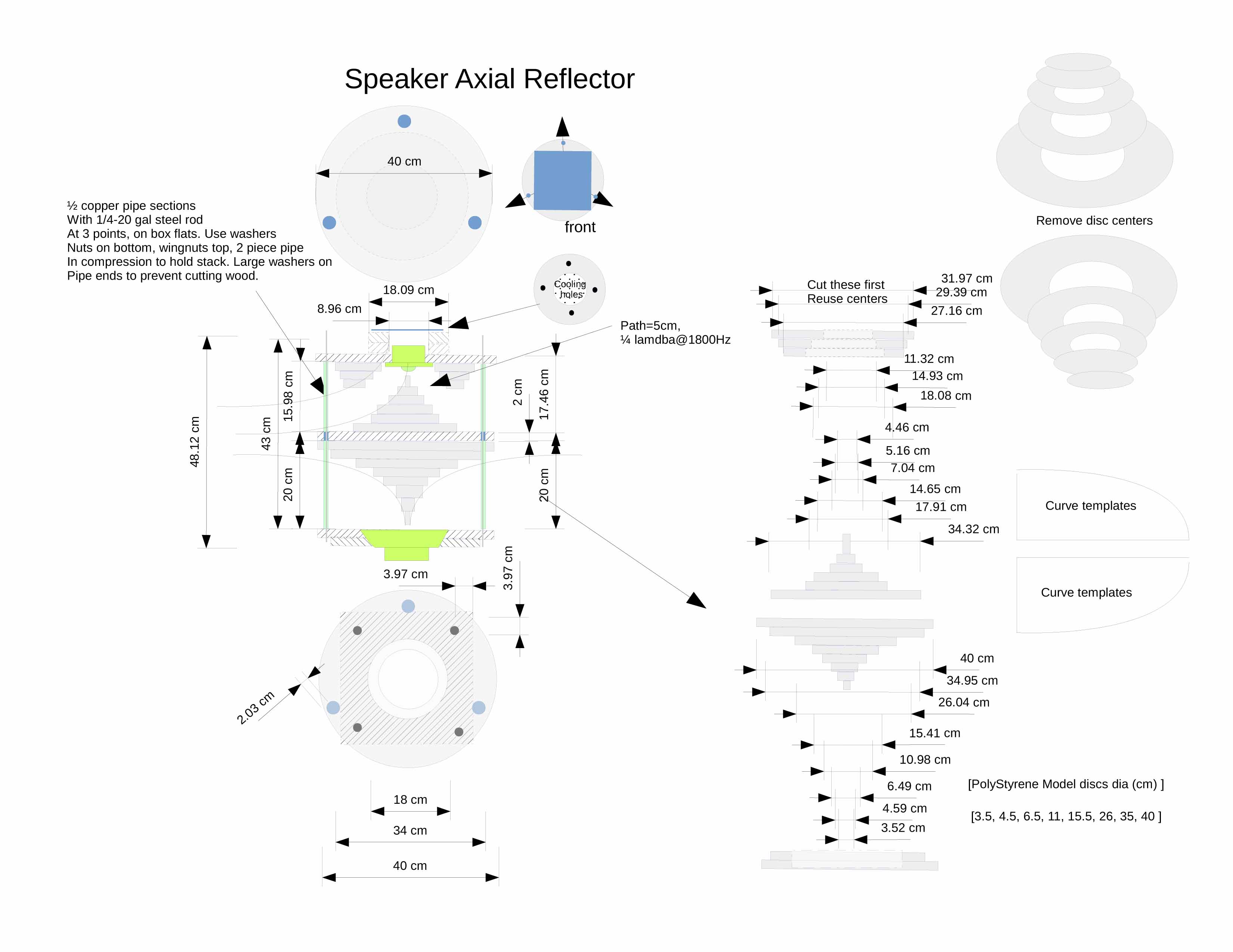

The high freq section needs work.
I have 2 reflectors for the tweeter in an attempt to make a hybrid waveguide and reflector. In playing with a ripple tank simulator, it looked like the exit path needed to be controlled to prevent different path lengths from the tweeter and destructive interference. It seemed to work for an ideal point source, which sadly does not seem to apply to a 28mm dome tweeter.
The top "doughnut" was removed entirely as it caused interference between the upper doughnut and middle cone. The sound was distorted and no amount of frequency equalization could fix it. Just did not work.
With only a single middle reflector in place it seems to work OK but not great. It's usable with equalization and boosting. There are two issues 1) uneven response and 2) overall attenuation.
The overall attenuation (I think) is a result of increasing the projection cone angle from from 120deg (direct tweeter) to 360deg (cone) which lowers the pressure by approx 1/3 or 10*log(0.33)=~-5db. The tweeter is spec'd at -2db less efficient than the woofer. There is also absorption factor (0.15) from polystyrene or additional -1.0db. The total damage is -8db reduction in virtually everything from the tweeter w.r.t woofer levels and you can see it in the graphs and hear it. I need a higher efficiency tweeter (compression driver + waveguide) or active XO with seperate amps. I chose (placed the order) for the compression driver and conical waveguide which should arrive this week.

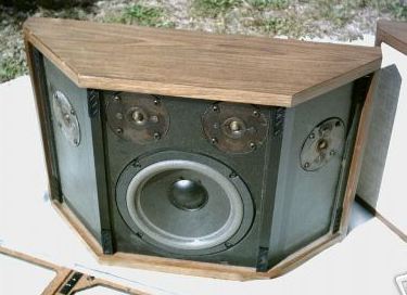

I had a read around, and the prognosis for omnidirectional doesn't look good to me: Sonab OA5 mkII
I seriously wonder whether wall-mounting might not work better than floor mounting. It kind of ends up in the same place with adjacent boundaries. You possibly know about the Allison effect with the first reflection from the nearest boundary which creates a suckout.
I do appreciate the secondary sound of the room as an important part of the sound of a loudspeaker. Especially if you are not tied to a sweet spot for listening.
BTW, to correct the power hole in LR4, you just overlap the bass and tweeter more.
