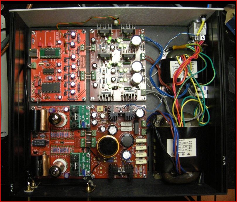

What is that green pcb on top of the I/V board? Is that a modification to your DACend2? On this attached photo, are you using the E182CC?
I noticed that your not using filters and bypass caps. So maybe this is the way to go.

Hello Andrea,
What value of the output capacitor and Rload are you using? What's the minimum voltage of the output capacitor? Is 200V OK?
Regarding the jumper on the DAC board, is it correct to hard wire pin 1 & 3 and leave pin 2 untouched?

200v is not ok.
you should always spec the output cap to be B+ with an extra margin. you need 300v or more caps. if something goes wrong you want the output cap to survive. You do not want 260v going to your next piece of kit!
Andrea is using a different operating point for the CCS. Using a CCS allows you to pick different operating points due to the horizontal load line created (Constant Current, so horizontal). The plate voltage is then just set by the grid bias.
for normal (not using the extra CCS PCB) then the 90v plate voltage is more suitable.

Hello Adam,
Thanks for your explanation. I think I understand now. :)

where you don't see "filters and bypass caps" ?
Andrea,
Sorry, I meant L1 and L2 was omitted as well as C4, C5, C9 and C10.
