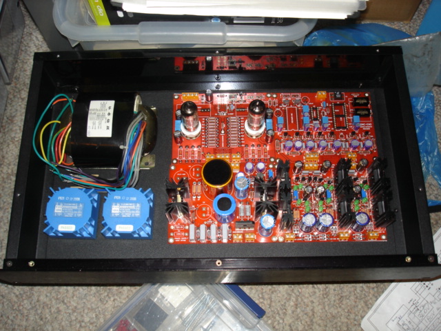

ok, I will try this.. What exactly is ment "to a plate-thru' via"?CustomHT,
I don't have the regulator board, I have the HV shunt supply PCBs only.
Don't populate the 4 HV rectifiers and the 4 snubber capacitors on your board. Instead solder the center tap to a plate-thru' via connected to the -ve pole of C5 (100uF/450V) and the rectified HV to a plate-thru' via connected to the +ve pole of C5.
In such case, you can use the full 200mA capacity of the transformer.
Do I simply soldier the leads to the -ve and +ve pole's of C5 as suggested?

Yes, you can.

Don't get confuse. What housing meant was you already rectified the ac voltage outside the board and the rectified voltage which is DC is connected directly to the + and - leads of the C5.
I think Apelizzo is using the same transformer as we are, so why not try just the green and orange wire?

Ok that makes sence. Basically the board is made so I could have just used mains voltage connected straight to the 200-250V connection, but since I am using the output from the trannie I bypass the rectifier section..
I will try connecting the green and orange wire to the + and - wire of C5. And post results..
Don't connect the green and orange wire directly to C5. It needs to go thru a diode first for rectification and then connect it to C5. If you do this, then wear a safety glass first before you turn on.
