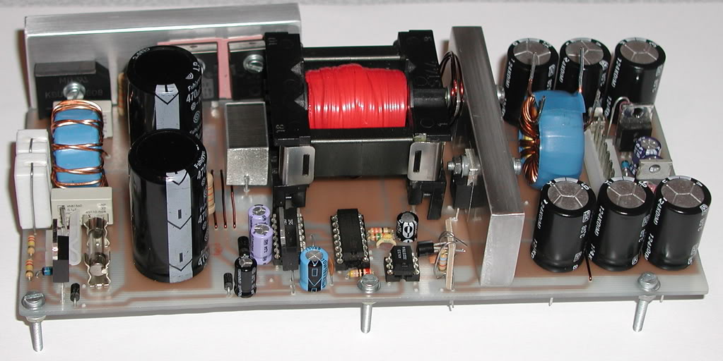

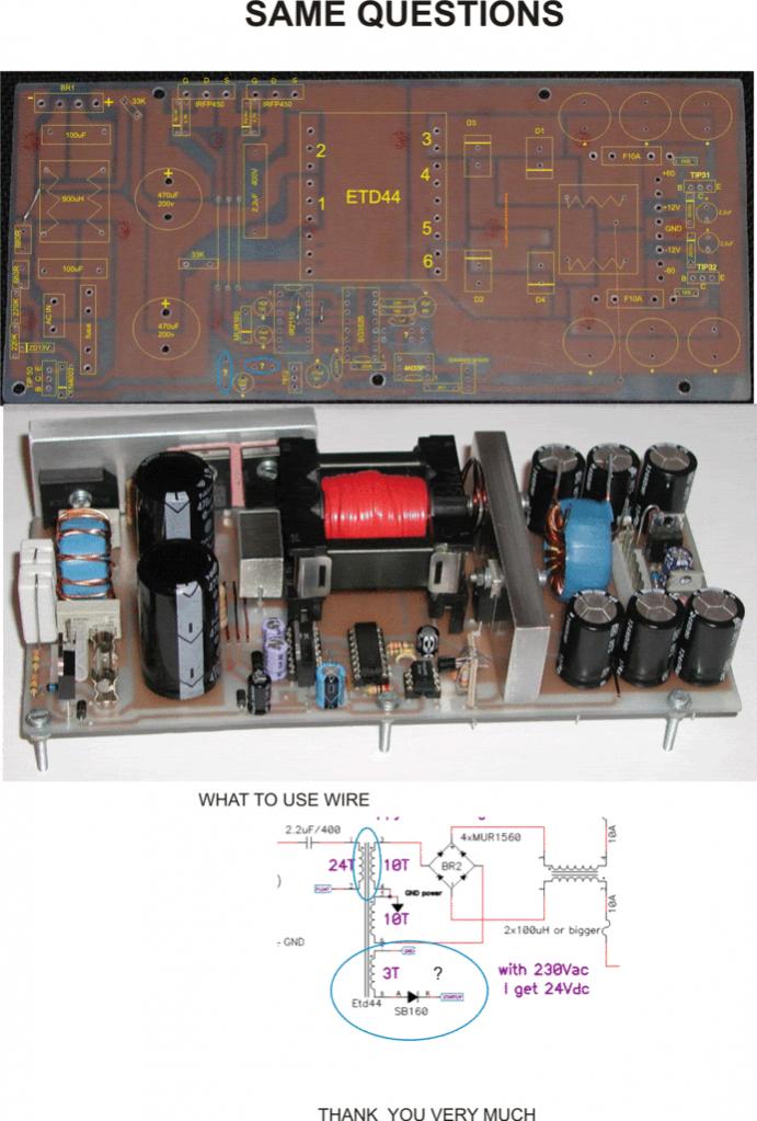

Hi Luka, the maximum current that your power supply can give is limited by the saturation current
of your output choke. If your choke saturates the current in the primary will rise too quickly leading to mosfet destruction. Why don't you try to put a current transformer in series with the 2.2uf cap to sense the primary current? You can use a small high permeability toroid with 100 turns and just pass the wire connecting the 2.2uf cap to the trafo trough it. Rectify the secondary of the current trnsformer with 4 diodes and convert the current in voltage with a resistor. Throw that voltage into a fast comparator and use it to disable the ir2110 (much faster than the sd pin of the 3525). You have just to be sure to set the current limit point lower than the point where your output choke saturates. If you do the things well you can make it short circuit protected.
Btw: which core have you used for the output choke? It seems quite small for 100uH at a reasonable current.
Another thing I notice on the layout is the too small safety distance between primary and secondary. Keep the distance at least the same as the optocoupler pitch.
It is not my intention to criticize your design I just give you suggestions on how to make it better and more stable.
Ciao
-marco

Since I would only need it for high peak power of music, and pretty low average overall, I need only fuses.
I am not sure anymore of what value did I measure it (unless I wrote it here), core if out of PC supply
About safety I know from the very start, even Eva warned me as did you, still noted... for this one is as it is, there will come time, that I will redo it all
In fact I don't even think you see my current state of supply, sure is not the same output inductor as in picture above
I guess I will need to take picture and post it
You are right your average power will be low but what happens if your multi kw classD amp connected to it fail in short between +B and -B? The fuses blows but you will have a peak current in the primary that can reach tens of amperes if the choke saturates and lose its inductance. A mosfet will blow much quicker than a fuse....
If you grab your choke from a pc it is quite surely a micrometals material 26, its saturation is quite soft and thus its allows you to have huge peak currents without loosing too much inductance.
Can you show me some pictures of the actual status of the smps; it seems simple but really well done.
