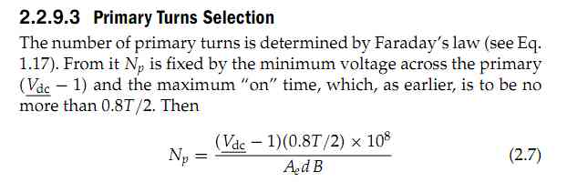

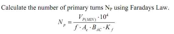

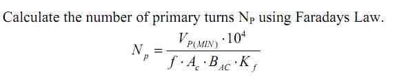

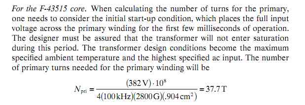

no of primary turns
np=vin min x10^8/4xfxbxac
=127x10^8/4x50000x2100x2.11
=14.33 turns or 15 turns

hey ravs,
I will check later today... primary count seems to be really low, but can't say its not ok
