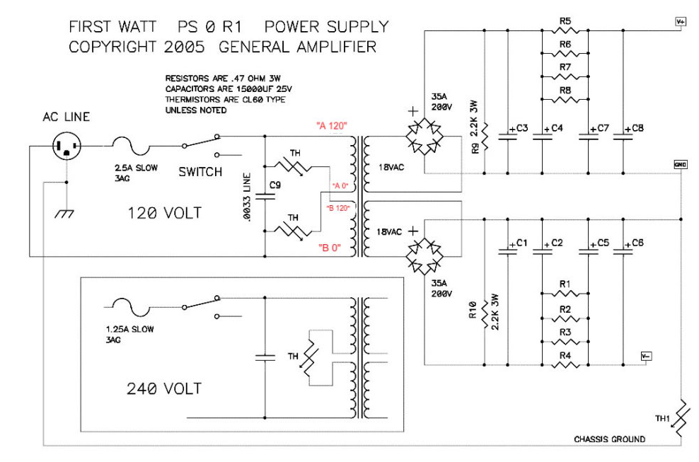

Just beginning to put together my M2C build using Teabag's amp and psu boards. I have decided to build as dual mono with psu in a separate box.
I need some help with where best to place rectification and reservoir caps - in the psu or amplifier? I had reasoned that one could place these in the amplifier, with the transformers in a separate box, and thus feed low voltage/high current AC to the amplifier, recognizing that the cables will have to accommodate higher current than mains AC, so larger conductors, and they could pick up all sorts of EM trash between boxes (perhaps not significant), plus the potential for inductance in the cable.

Attila: You want the rectifier and some caps in the PS so as not to introduce any low voltage AC in the amp. That is the main reason to do it.

(i) Mains frequency AC is the source of mains frequency hum; bringing it near audio circuits introduces the possibility of injecting hum into audio signal paths. Either by magnetic coupling or by electrostatic coupling (or both).
(ii) Bringing AC into the audio chassis means bringing the rectifier diode(s) into the audio chassis. Many people are fearful of diodes, viewing them as virulent sprayers of nasty RF emission. They strongly feel that if you can move the diodes completely out of the audio chassis, why on earth not?
(iii) Locating the transformer in one chassis and the rectifiers in another chassis means you have an extremely long current loop between transformer secondary and rectifiers (meters long rather than centimeters long). Unless you carefully implement critical damping (zeta=1.0) of this distributed RLC circuit, the current loop will carry bursts of high amplitude oscillatory ringing, each time the rectifiers turn off: two bursts per mains cycle. The current loop will act as an antenna to broadcast these oscillations into both chassis and into nearby equipment, which is highly undesirable. BTW you achieve critical damping by making a series of lab measurements upon your particular transformer and your particular umbilical cable. Not calculations. Not consultation with experts. Measurements upon your hardware assembly.

For perspective, the reason I want to put the psu separately is that these transformers (2 x 500VA Primrose toroids) will also be driving a pair of BA-3 monoblocks sometime later this year. Given the cost of power supply hardware, building a common psu for either amplifier seems worthwhile, even though it is rather over-spec'ed for the M2.
Presumably one would also include the cable between the transformer secondary and Quasimodo's input when measuring? Or am I being too simple minded?
I fully agree with your comments on ground wiring, as the ground conductors must hang around long enough for a fuse to blow or to send the fault current back to the circuit breaker. Daunting given the potential magnitude of fault currents...

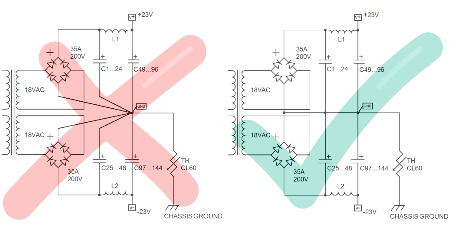

This week I have finished my M2 build. I have started allready with an F6 but have postponed the F6 because I have read meanwhile many times that M2 is the favoured by many DIYers. To be honest a few month ago I was not aware that there are any other First Watt designs than F1-F7
As usual the assembling into chassis, wiring etc. is most of the work but least fun. Therefor I can highly suggest the Disspipante Deluxe 4U Chassis, the pre drilled heat sinks and the plattform makes the built as simple as possible. Unfortunatley I had problems with pre-drilled holes in one of the heatsinks. They did not accept much thread and I had to do some rework. Also resoldering was required to adjust the offset. Had to increase R7 from 47K to 51K (Teabag M2 clone boards with Harris IRFP9240)
First listening was dissapointing. Got slight humming from speakers (88db efficiency) wich could be heard in 3 meter distance in a quite environment. Also the sound was not as smooth as you would expect from a ClassA amplifier.
Hmm, the M2 is noisier (500uV) than other First Watt amplifiers but other builders are using M2 with high efficiency speakers and have not such problems. Means it looks like I did something wrong with my build. After thinking about I found my very stupid mistake. To improve wiring I have overdone star grounding respectively set star ground wrong in my CLC power supply. Find details attached. Shame but lessons learned.
After the rework of wiring it is the quitest (concerning hum) amplifier I have built yet.
I'm really surprised that star ground wiring can make such a big difference. Maybe pictures of the incorrect and correct ground wire routing will help clear it up for me.
