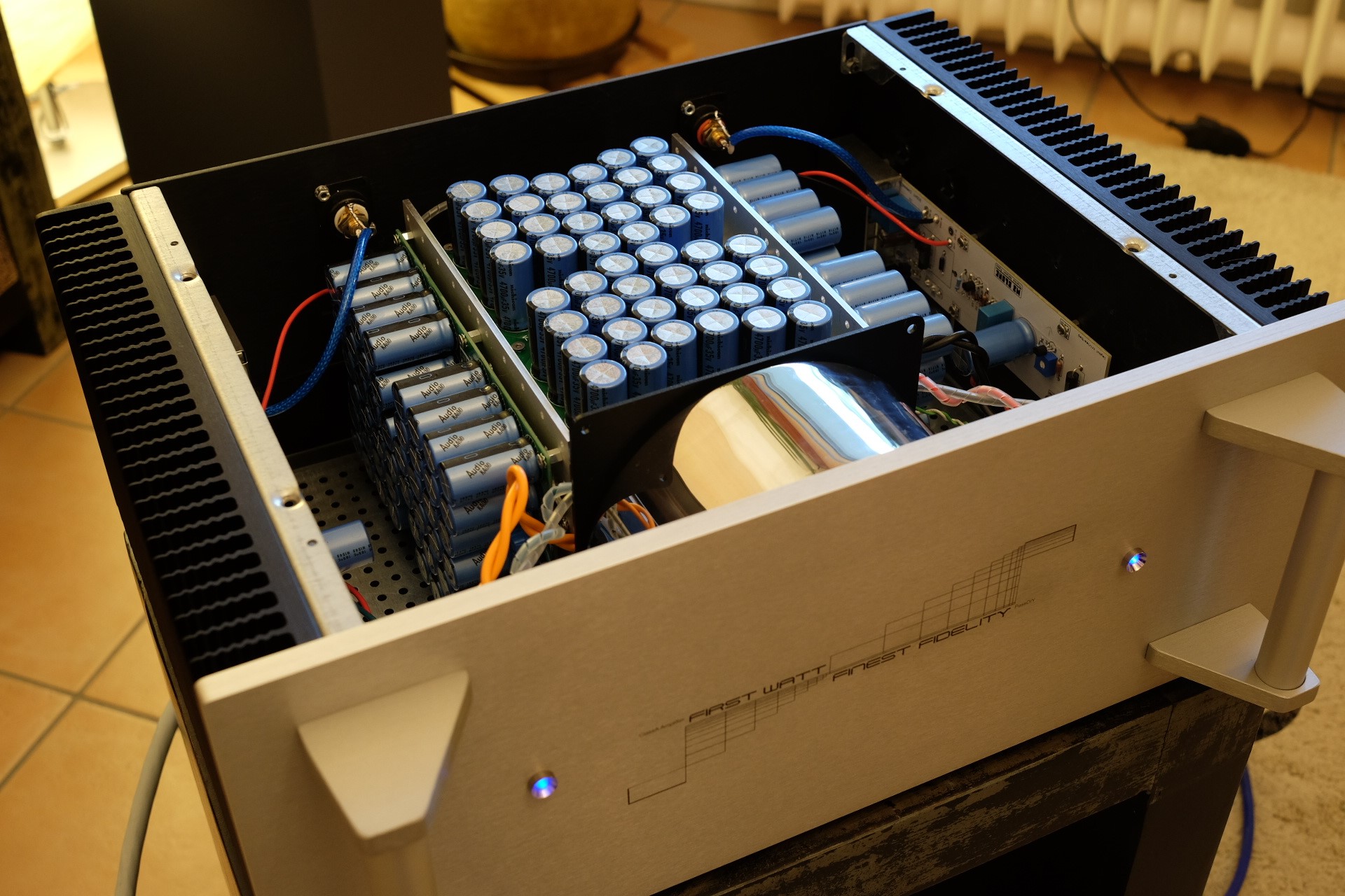

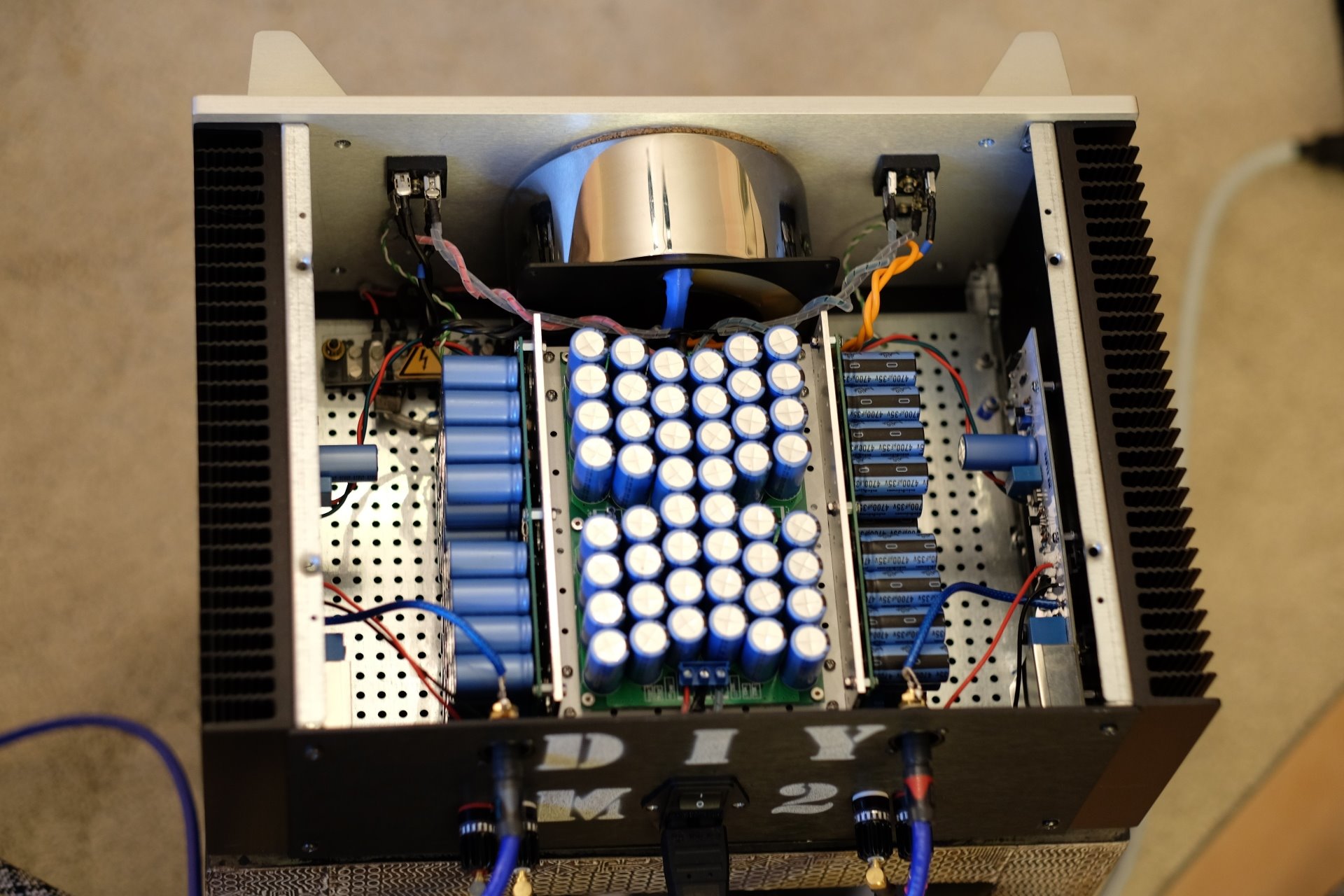

I suppose the noise was from the dirty ground on the rectifier side mixing with the clean ground at the psu output?
You are right. Not good to have unsmoothed rectifier outputs mixed with clean GND (after CLC) and to keep the wires from / to the rectifiers short. The stupid wiring caused nasty current flows also I guess.

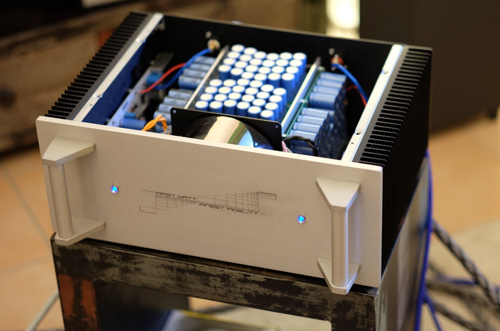

@1543 Looking at your psu numbering, are you using 144 capacitors?
Instead of 8 big capacitors I have used many many many small (ø18mm) caps. This allowed me to put 2 big DC chokes, transformer and power supply in a only 300 mm deep chassis. But I must admit after assembling the M2 the supply looked a bit oversized, but it will not harm.:D

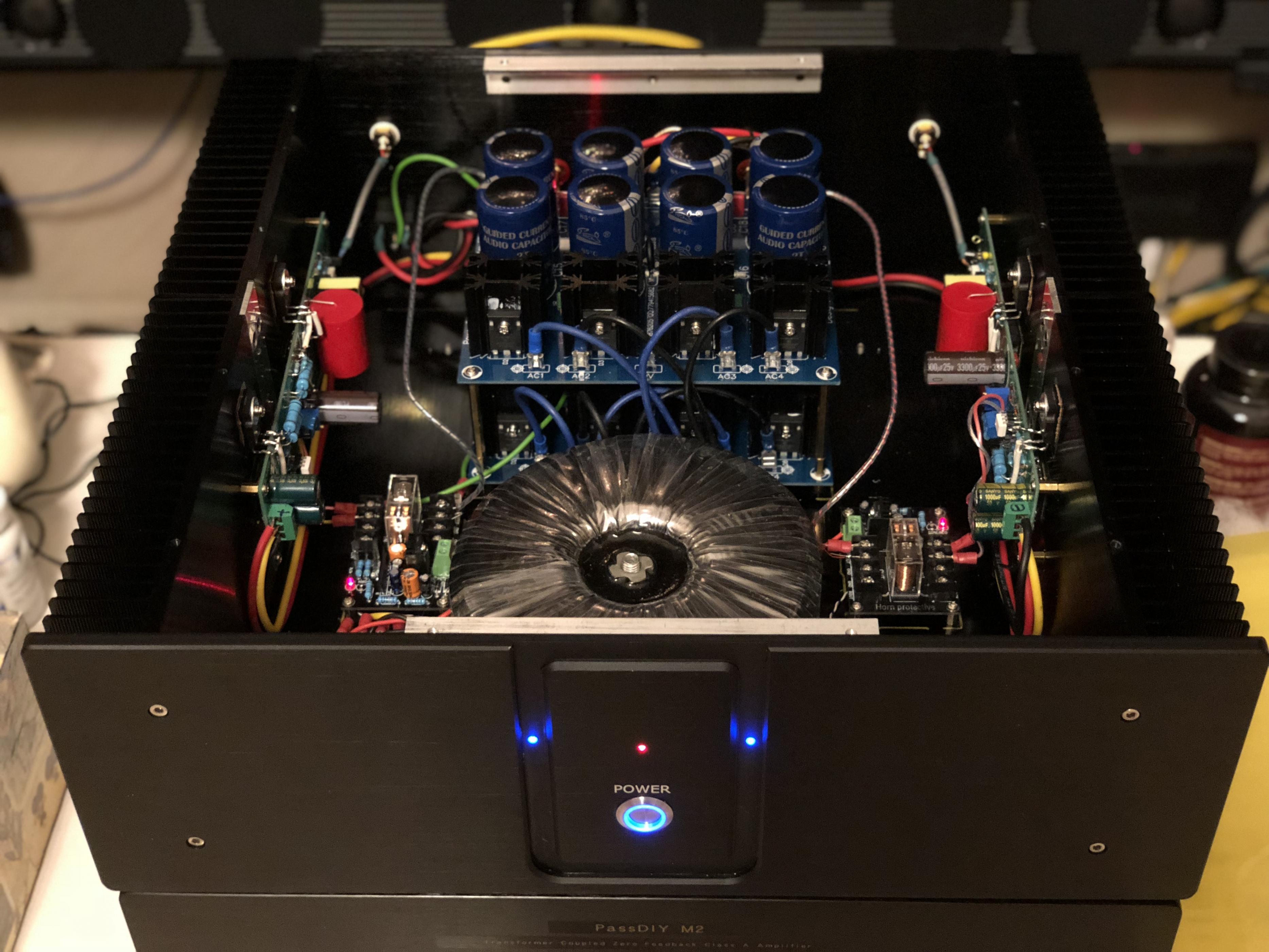

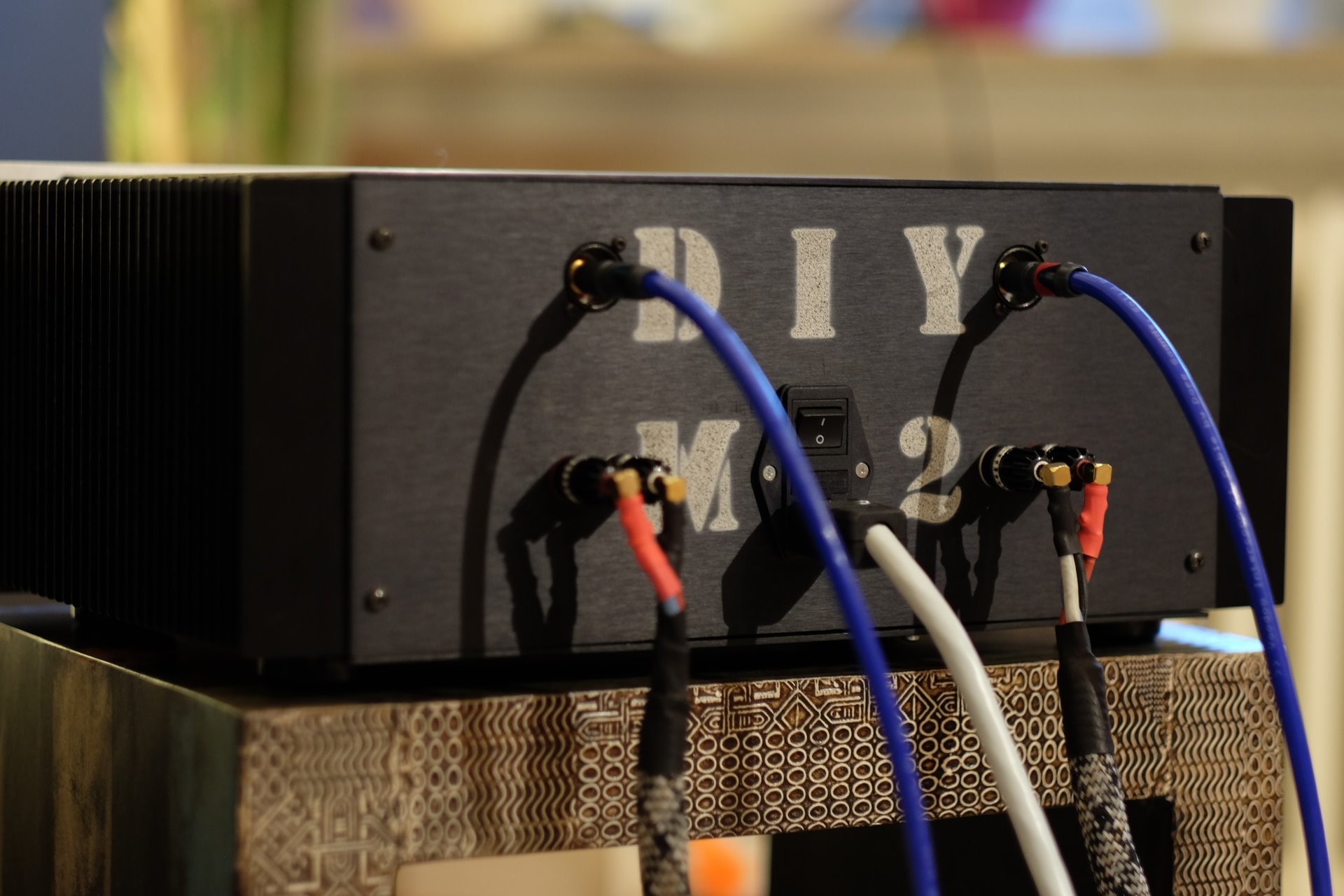

As already threatened here are some pics of my M2 build

Thanks for the pics, 1543.
I like that you mounted the rectifiers to the faceplate. Good idea. :D
First rate.
:cheers:
Nice Build! Is that a Toroidy tranny? How many VA is it?
Very nice 1543, congratulations on your beautiful build!
Many thanks for your kind feedback. :cheerful:
Yes, the transformer is a Toroidy TTSAS0400 400VA 2x18V. They are of very good quality, highly recommended.
The mounting of rectifiers to faceplate helps a lot when space on baseplate is limited. Also access is much easier when mounting the recifiers on the faceplate.

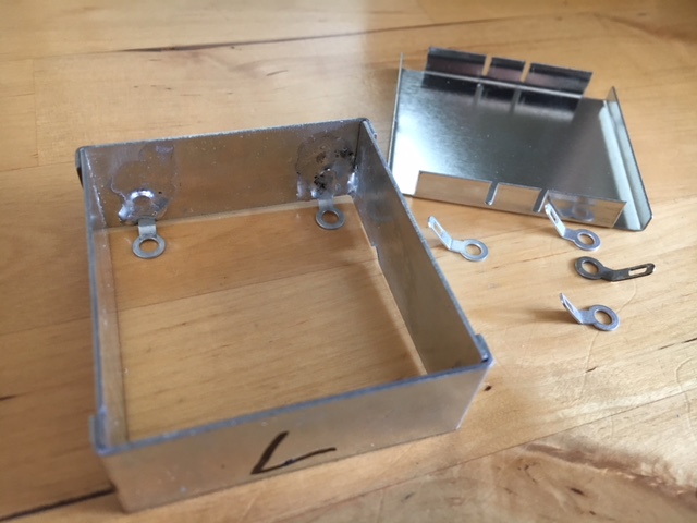

I have shielded the edcors with Teko 3710.16 enclosures. It is easy to make them fit to teabags M2 clone boards with solder tails which can be screwed to the board.

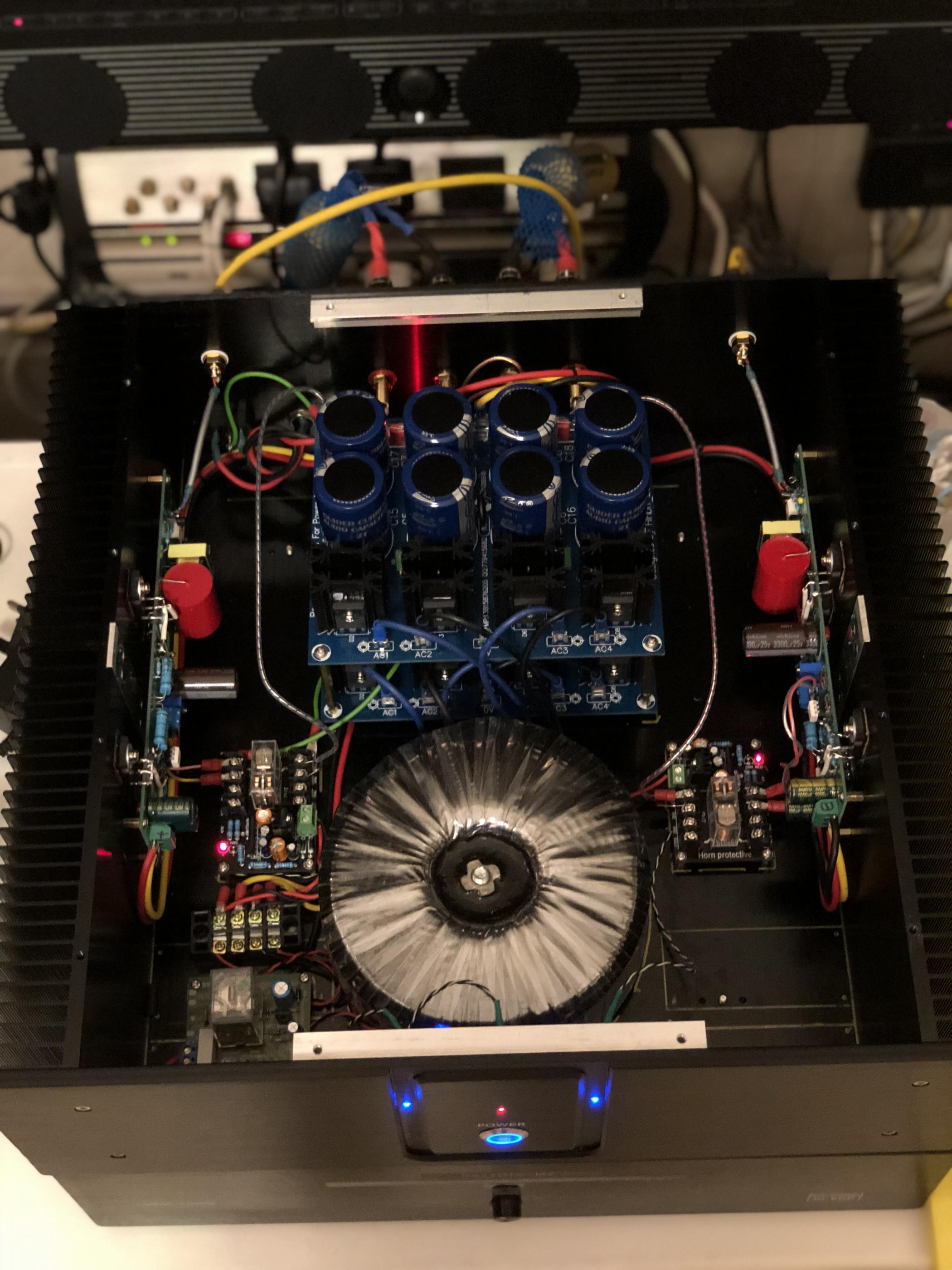

Yes I really like their transformers. I used a 2x20, 300VA in a recent build but didn’t realize I’d have to mount it vertically to fit the chassis. I had a friend weld L brackets to the mounting plate so was curious how much extra space the 400VA would take for future builds.

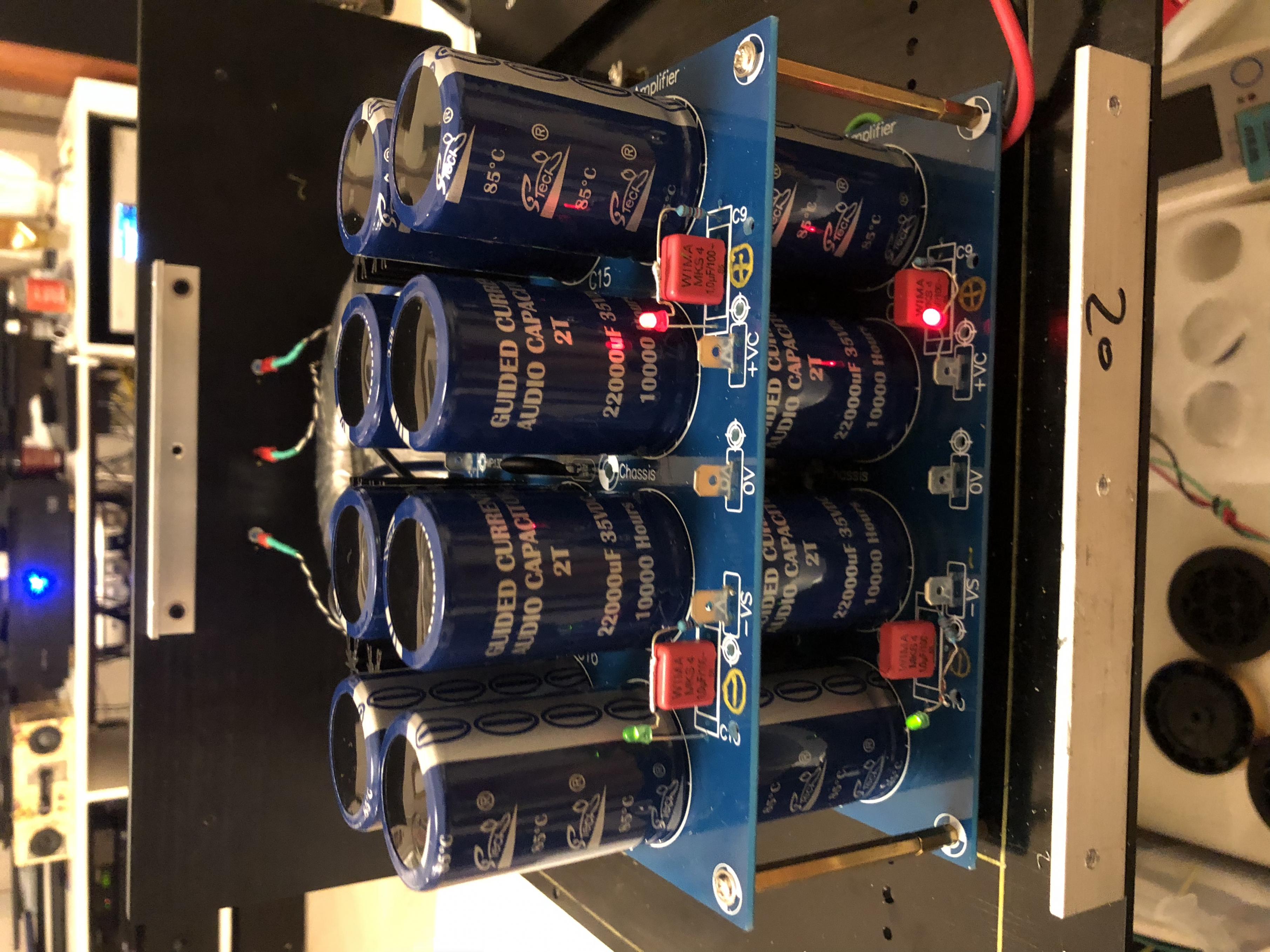

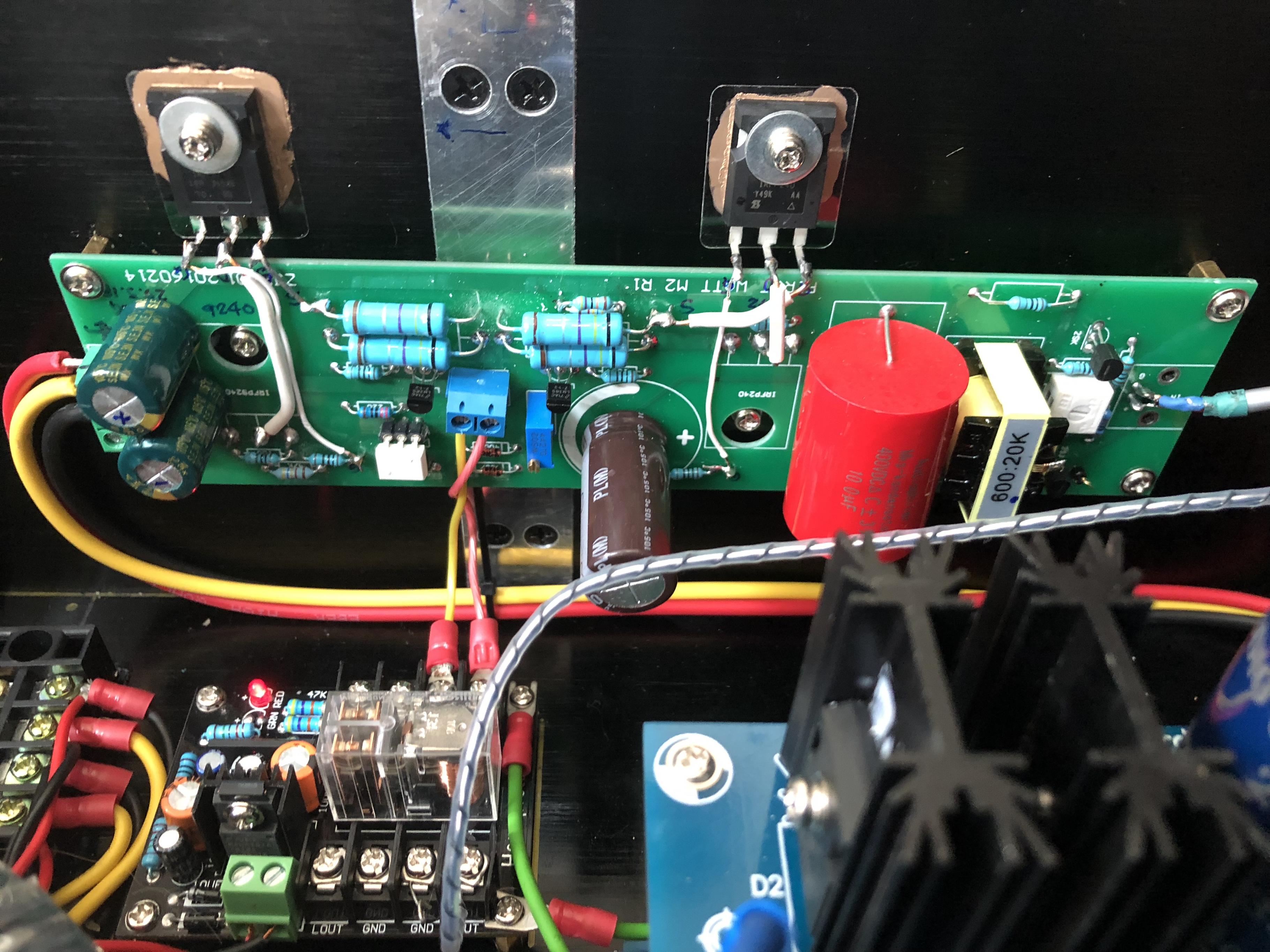

Just finished my second M2 build. This time with higher class current using two pairs of output mosfets. Up power transformer to 1KVA and power supply capacitance to 176,000uF / channel. Overall saw an improvement in low end and immersive sound stage.
