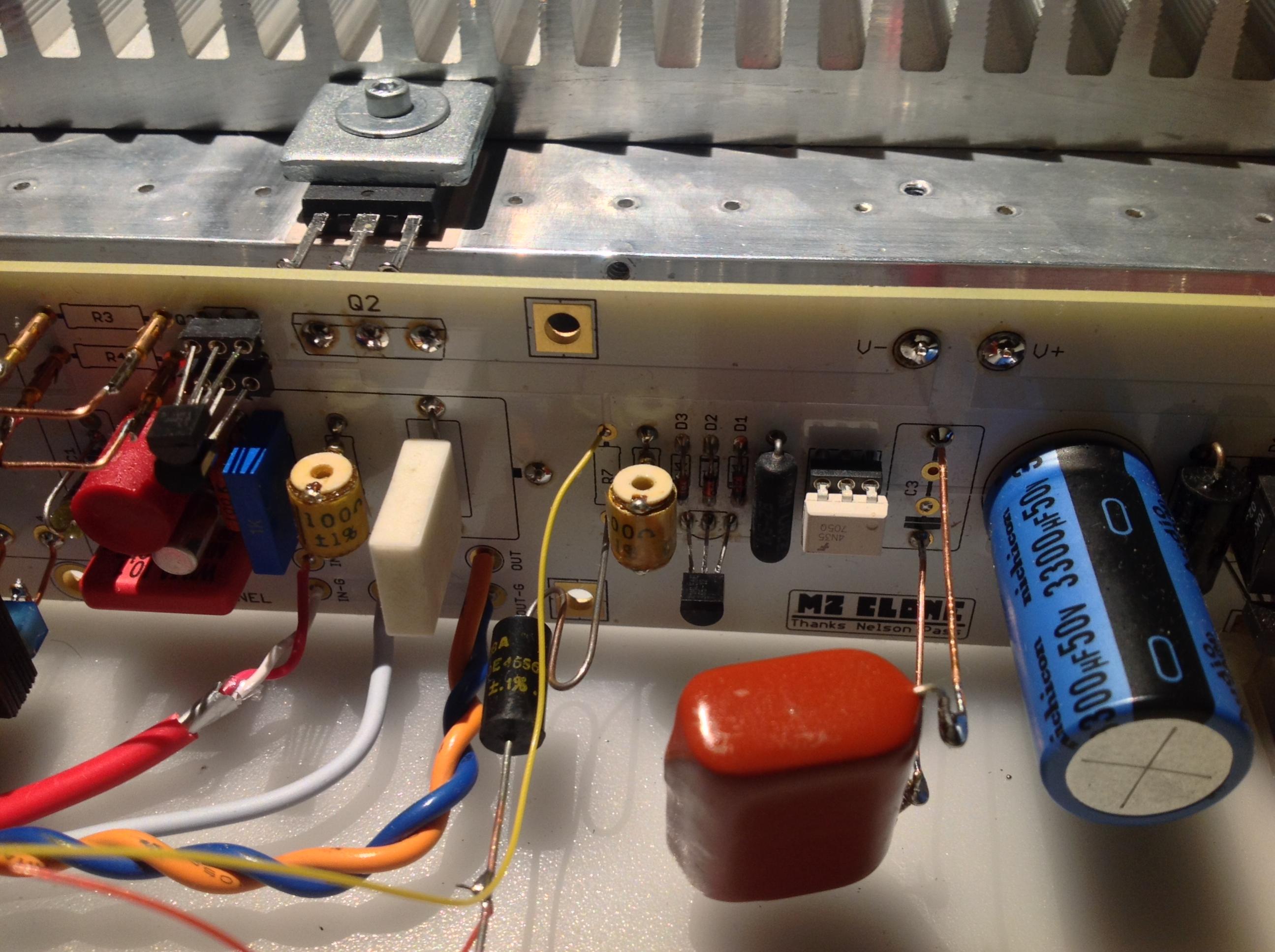

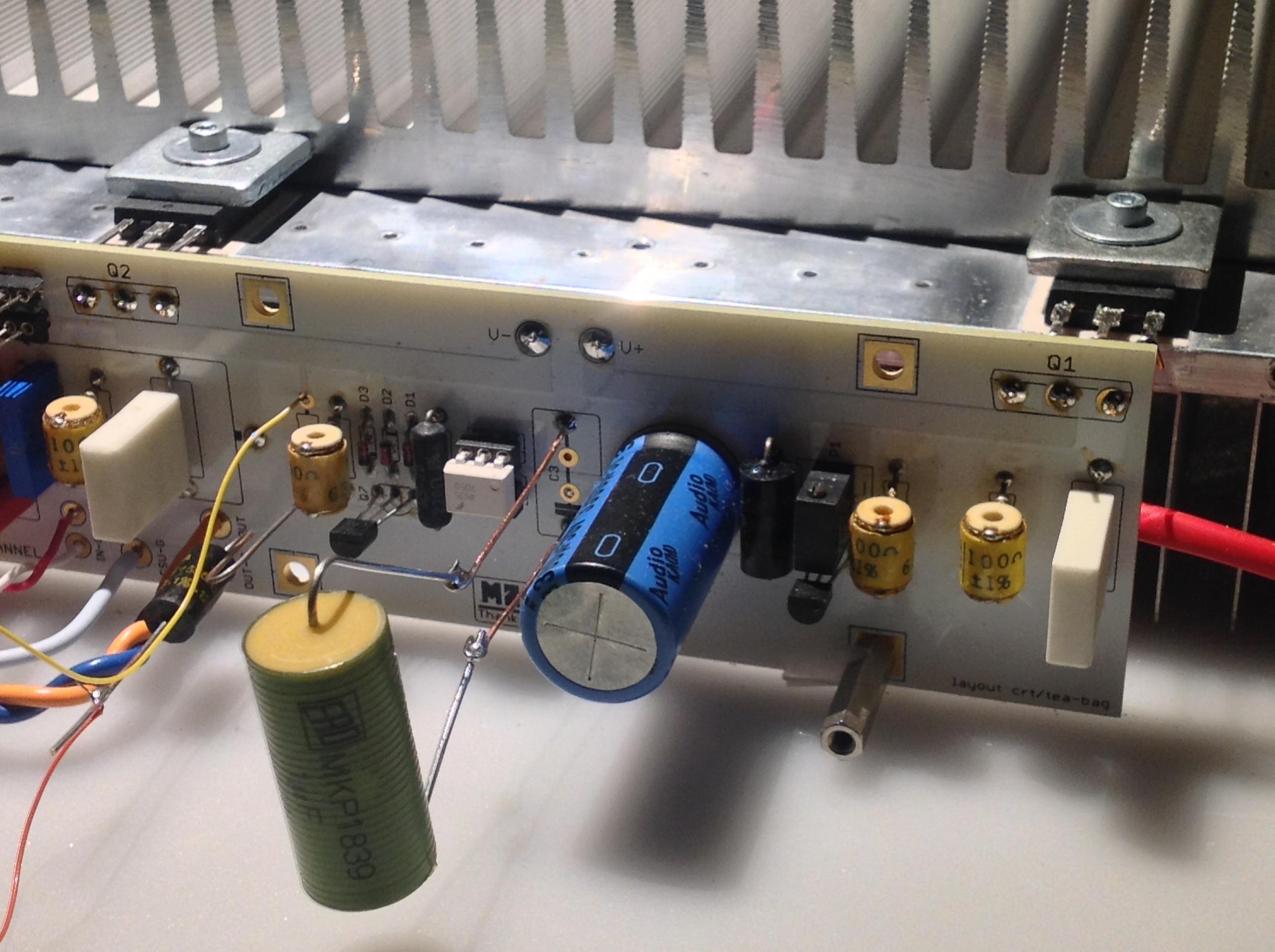

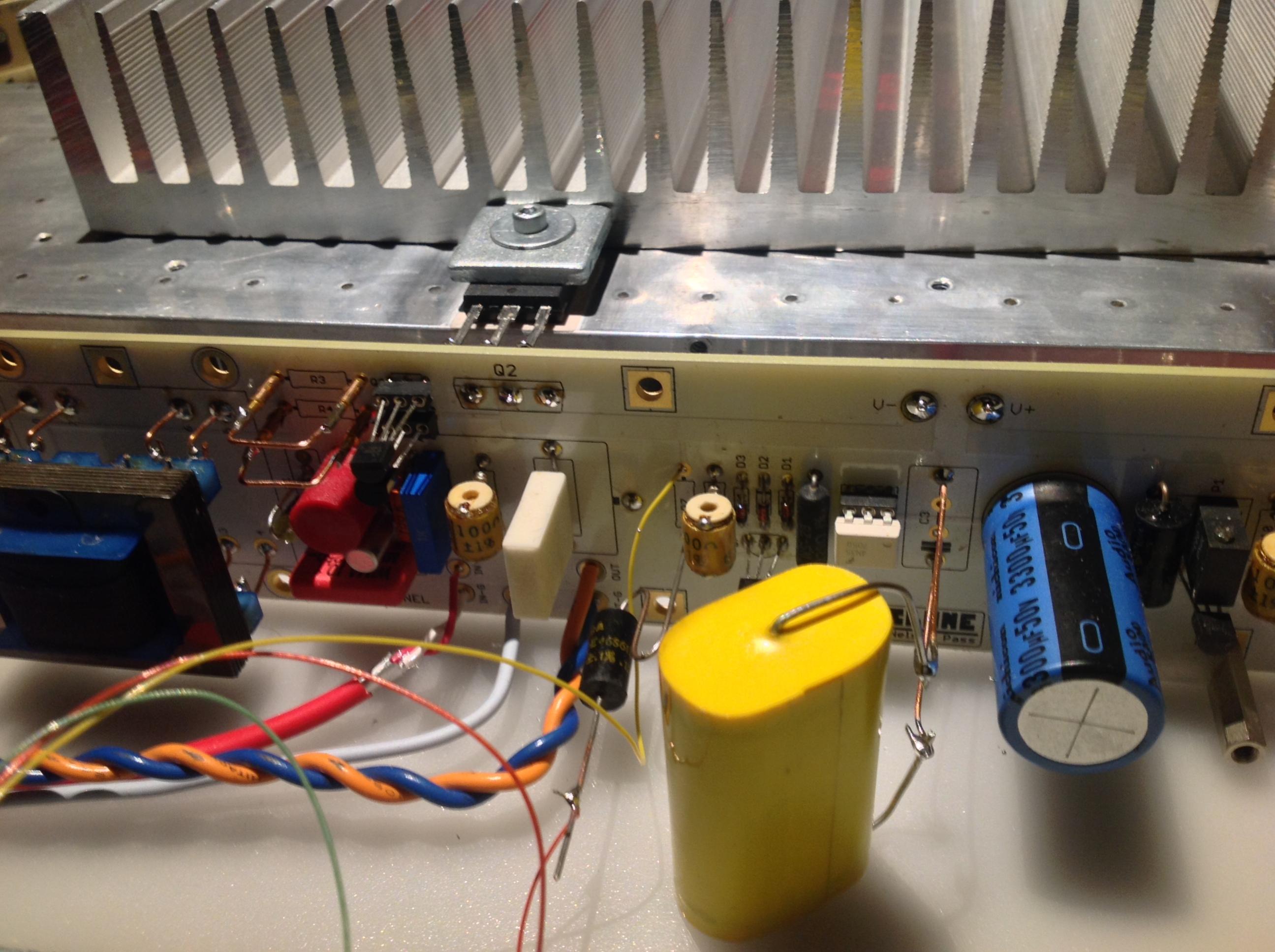

Experimenting last nights with M2 coupling caps and i was sceptical about any difference.
Real situation tests that was clearly audible.
The same 2 songs with strings, accordion, piano , acoustic bass , drums and the voice i do play maybe 50 times or more.
Stepped attenuator at the same precise volume level.
7 different types of caps was soldered and de soldered.
Not all show on the photos , specialy bulky paper in oil etc.
Conclusion : passive is important if you care about colorations of recorded sound from the passives components.
Caps changes was like less or more subtle equalisation. That only caps so i take care about semiconductors test next time.
Thanks to Mr Pass.
Was intructive experience after intellectual reads of many articles.
Truth of the music from my actual audio system.
