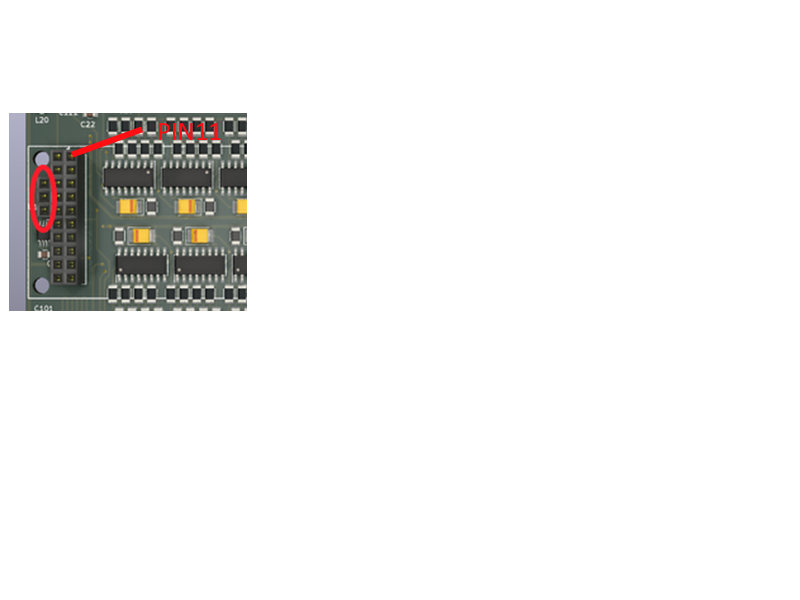

2) How to do with 3 Pin Mute per page 5 in user guide mentioned. Connect all 3 Pins to ground?

You need wire MUTE pin from Amanero to DSC PIN 11 (Mute input, near pin 1), not Ground. Have a look at DSC digital input pinout in User Guide (page 4).2) How to do with 3 Pin Mute per page 5 in user guide mentioned. Connect all 3 Pins to ground?
It needs to be done only when placing Amanero as Option 3 from User Guide.
