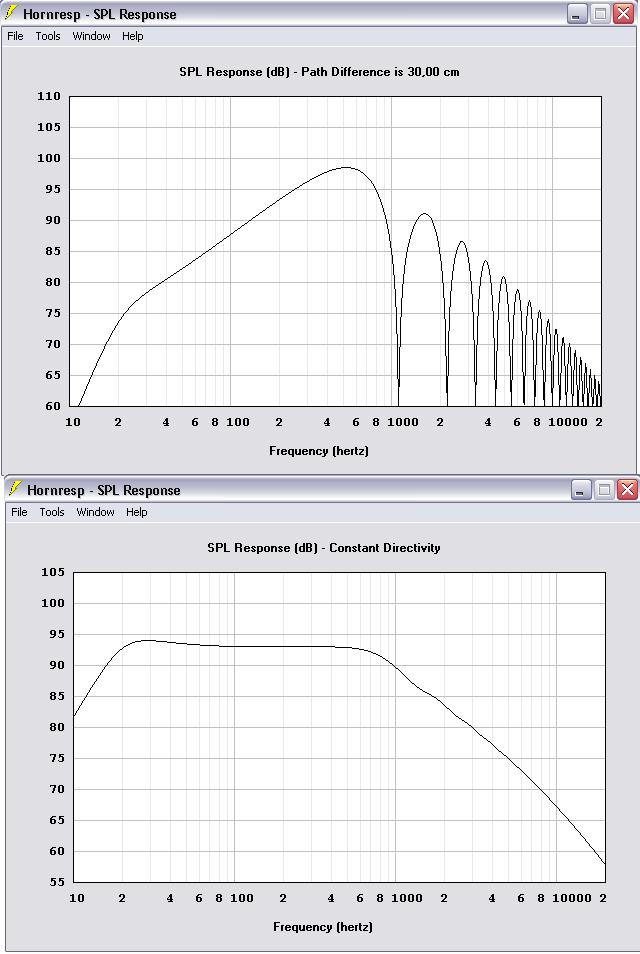

Generally with measurements dont have enough knowledge to know wether they are good or bad? For instance, in Helmuth's measurements for the Dipole15, the top response looks terrible, but probably isn't, & the bottom response looks great, & probably is. When I look at the one's in your link I think they look ok.
I was already pretty much set on the Raal when I posted this thread, the only issue I can see (apart from the cost) is they are not dipole, have you found that a problem?
I believe Raal have done a Dipole tweeter but I think the price is something like $900.00 each & they dont appear to be easily available yet. At $900 there out of my ball park.
I am now pretty much settled on 1 x Dipole15 per side, I mostly listern to classical so I expect they should be fine.
I will stay with the Saba mid for the moment & see how it pans out.
I'm also looking at buying a Behringer DCX2496 to dabble with active.
The top respone is of the dipole 15b in a OB. And needs there for a equaliser to make the response flat 30Hz and up This means you spl at 35Hz will be your SPL at 1W. That will become about 78dB 1Wmtr
And as for this graphic Response usable up to 800Hz.
You wiil be building this OB based on theorie. Thats the normal procedure. After that it is necesary to measure the response to make it perfect.
Then you need freeware as holmrespone or arta your 16-24bit soundcard of your computer and a behringer EMC8000 mic with phantom supply mic preamp.
The bottom response is also in a OB but then without the influence of the sound of the backside of the OB. This influence is shown in combined response that is the top response. It is a circular baffle of 60cm in this case.
Helmuts is NOT a real measurement, rather a simulation to show the hypothetical response on an open baffle. Mine is in room. Low end response is truly extended with only minor EQ needed compared to non OB specific woofers. Just a matter of how low you wanna go and what kind of headroom you might want.
